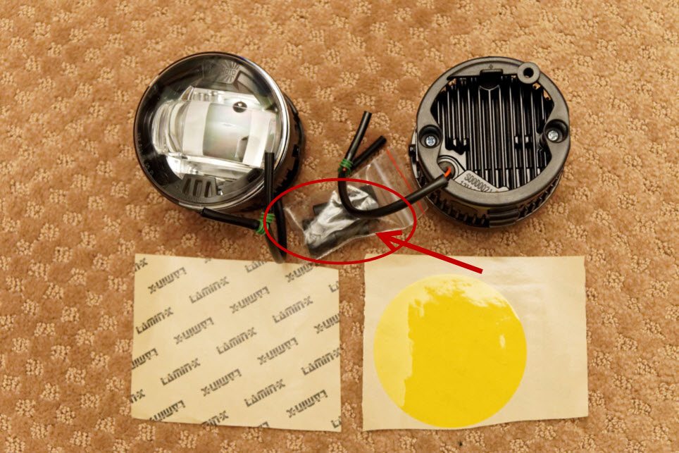

FUUUUU.....!!! I got everything ready to install these tonight, and it turns out that my package did not include the connectors!
Did anyone else have the same issue?
Missing these:
Official TRS XB LED direct fit foglights Group Buy! Don't miss out!-uxpc3xqh.jpg

That sucks!!!!
Feel for ya. Mine was complete. Installed last night. You'll get it straightened out and forget about this setback when you see them installed. Good luck!!!
Sean

Thanks. Hopefully TRS can expedite the parts. I'm guessing I won't hear back from them until Monday morning at the earliest, though...
Missing these:
Thanks for pointing that out. Mine didn't come with the connectors either. I'll be sending them an email tonight. Thanks again!
