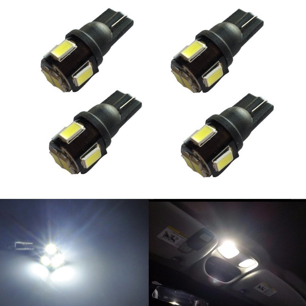

I used these white LEDs for clear corners on another car and had two leftovers to put in the G’s map lights.
Amazon.com: JDM ASTAR 4pcs Super Bright 5630 SMD 194 168 2825 W5W T10 LED Bulbs,Xenon White(Best Value in the market): Automotive Amazon.com: JDM ASTAR 4pcs Super Bright 5630 SMD 194 168 2825 W5W T10 LED Bulbs,Xenon White(Best Value in the market): Automotive

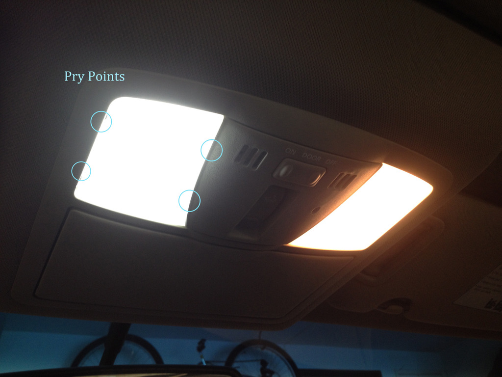

A much whiter light compared to the factory bulb! I’ve circled the points where you want to stick your flat head screwdriver and pry.

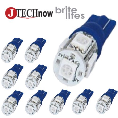

But blue is way cooler! So then I ordered these blue ones.
Amazon.com: Jtech 10x 194 168 2825 T10 5-SMD Blue LED Car Lights Bulb: Automotive Amazon.com: Jtech 10x 194 168 2825 T10 5-SMD Blue LED Car Lights Bulb: Automotive
The bulbs have 5 little LEDs mounted on them. They were pretty cool, but not very bright. They work great in the door courtesy lights. So I’m using two in the doors and I have a bunch of leftovers.

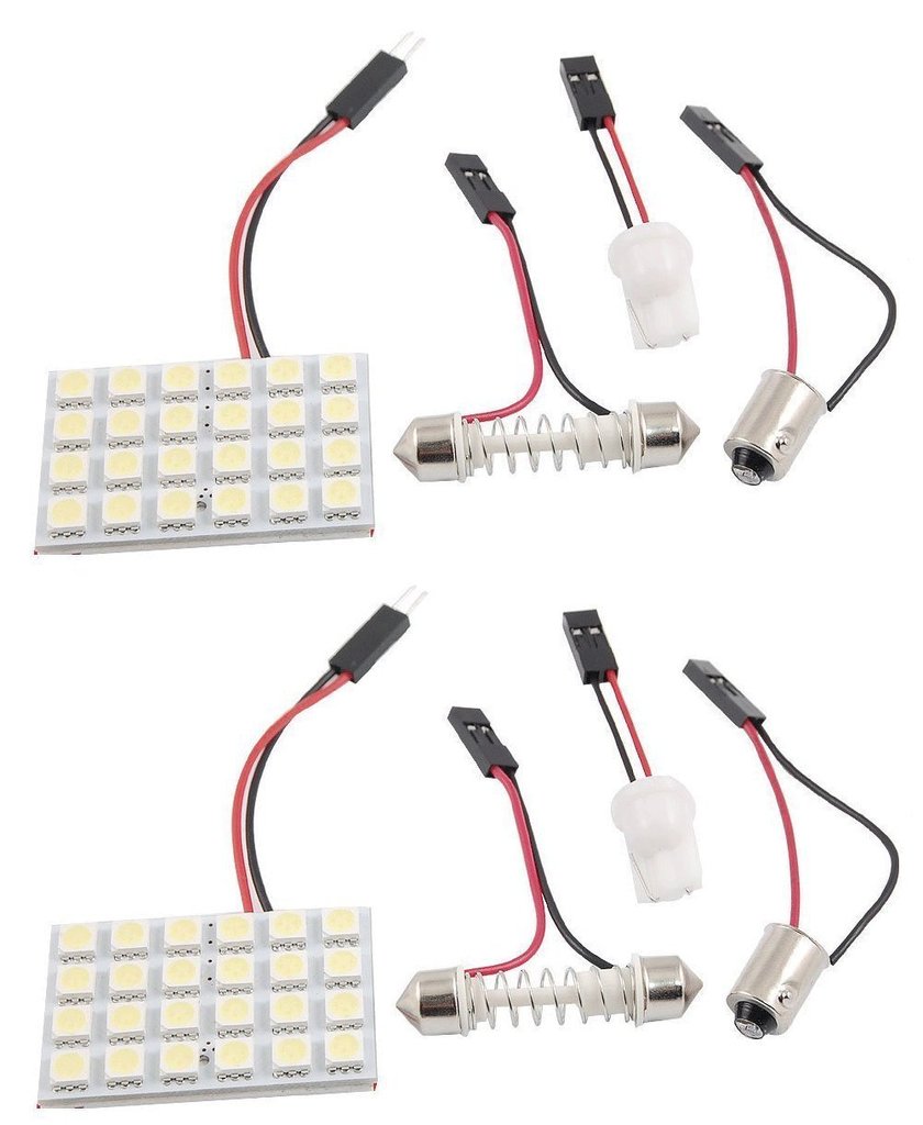

Then I found these LED panels with 24 LEDs. There are smaller ones and bigger ones. I got a 48 LED panel for the trunk, which you’ll see later. First I had to measure the space so I could order the right size.

Then I got these from Amazon.
Amazon.com: Cutequeen Trading 2PCS Blue 5050 24SMD 24-SMD LED Panel Dome Light Lamp + T10 BA9S Festoon Adapter (pack of 2): Automotive Amazon.com: Cutequeen Trading 2PCS Blue 5050 24SMD 24-SMD LED Panel Dome Light Lamp + T10 BA9S Festoon Adapter (pack of 2): Automotive
They come with several adapters so you can use them in other vehicles. There is 3M tape on the back of the panels. I think they were supposed to be permanent but they kept falling off. When they did, you could see the individual LED dots, which I didn’t like.

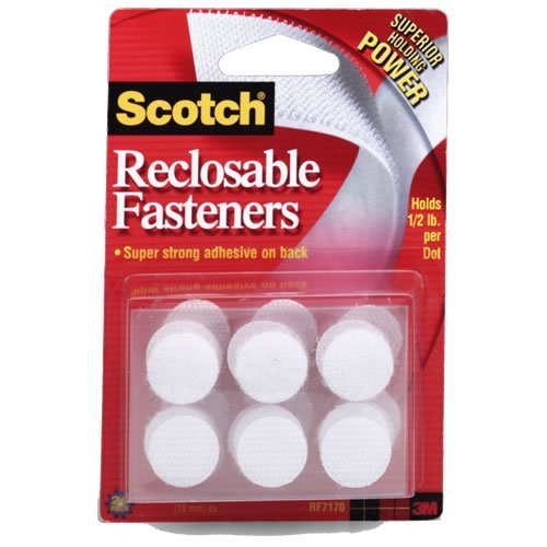

To solve the problem of them falling off, I used these Velcro dots I got from Target for a few bucks. They are way overpriced on Amazon.

Now if I want to change the color, I can just peel them on and off!

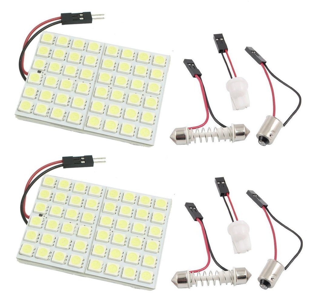

As for the trunk, I got these from Amazon.
Amazon.com: Cutequeen Trading 2PCS Blue 5050 48SMD 48-SMD LED Panel Dome Light Lamp + T10 BA9S Festoon Adapter (pack of 2): Automotive Amazon.com: Cutequeen Trading 2PCS Blue 5050 48SMD 48-SMD LED Panel Dome Light Lamp + T10 BA9S Festoon Adapter (pack of 2): Automotive
The panel was mounted outside of any housing, so there was no size limit. The 48 is plenty bright!
You have to get on your back and slide into the trunk to get a good view of the dome light in there. Use your fingers or a flat head to pop open the cover, then pull out the bulb. Plug in the adapter and LED panel. Stick the “hook” side of the Velcro dot on the back of the LED panel. The trunk liner is Velcro friendly so you can stick that panel right onto it. You won’t be able to close the little dome, but that’s ok since it’s out of view. Just remember to be careful when loading stuff so you don’t hit it.

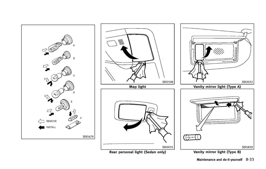

I bought a kit from Amazon but it didn't come with any bulbs for the vanity mirror. What type does that take?
The '08 uses a small festoon type bulb
Yes, it's a festoon type of bulb. It's a skinny tube. Not sure how long it is, though. I popped the cover off mine once to check it out. On my coupe, the vanity light strip runs horizontal along the top of the mirror. If you want to replace that bulb, make sure to get a skinny festoon, not the ones with the wide panels in the middle. It won't fit for the coupe vanities.
I think the vanity lights on the sedans are placed vertically next to the mirror. There might be more room in the sedan vanity housing. So there may be room for the bulbs with the wider panels in the middle.
Make sure to measure the length of the bulb first. Then when you search, include the measurement, for example "led festoon 28mm". Your results might say the bulb is for a Mazda, but as long as the length is right, it should fit.
