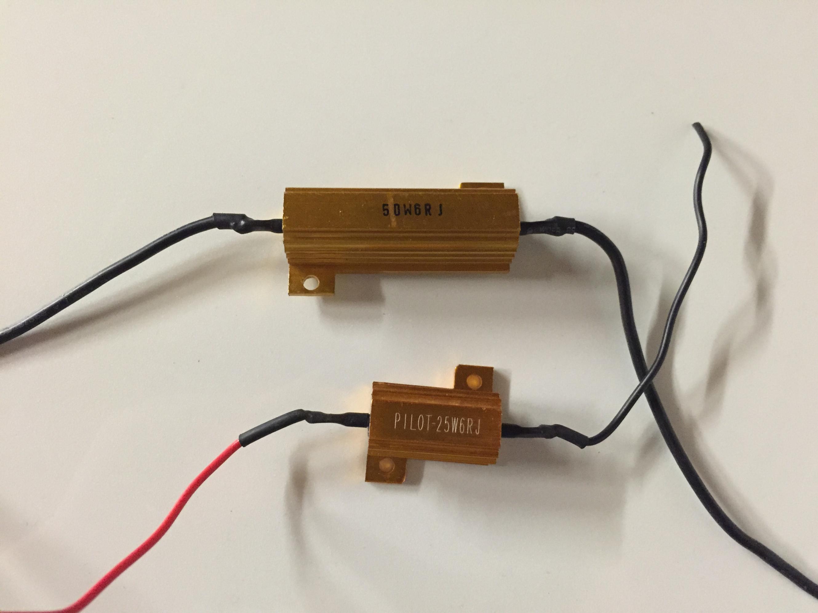

Hey guys,
So today i decided to tackle the LED front blinker. I did the left side 100% perfect with the bulb and reistors. I checked the blinker for about 2 minutes to make sure the resistor got hot and it was working and that the blinker wasnt hyper blinking. When i started the right side i did everything the same. Then when i went to check it, it started hyper flashing!! Then i checked the other side and it is hyper blinking as well!!
I did this years ago to my murano and it worked 100%. Im just not sure what i did wrong here. There is a red wire and black wire for the resistor and i connect them to the black and the green/yellow wire. Any suggestions to as what i did wrong? Instead of using the load resistors can i just switch out the relay?
Thanks in advance

Try Using a multimeter to measure the resistance of the supplied resistors.
One may have a different value from the other?
Try swapping/replacing them
Good luck

The resistors from auto zone ended up being 25W 6ohm instead of 50W 6ohm like i needed. All set now. And just an FYI the easiest way to change these out is to just take of your wheel, then take off the black housing in the wheel well with clips and you have 100% acess to the parking light bulb.
I attached a picture of the size difference.
