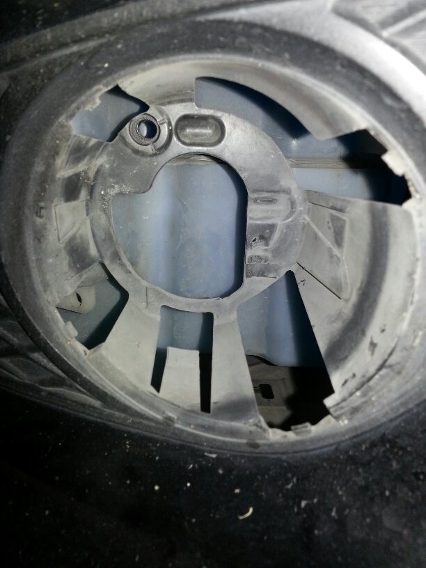

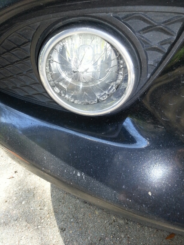

I noticed my fog light lamp crack this morning
questions: are the right & left side interchangeable? does anyone know where i can get some new/used ones beside eBay or dealership? also, which year G37 are interchangeable; 2011, 2012, & 2013? would a coupe work for the sedan?
thanks in advance

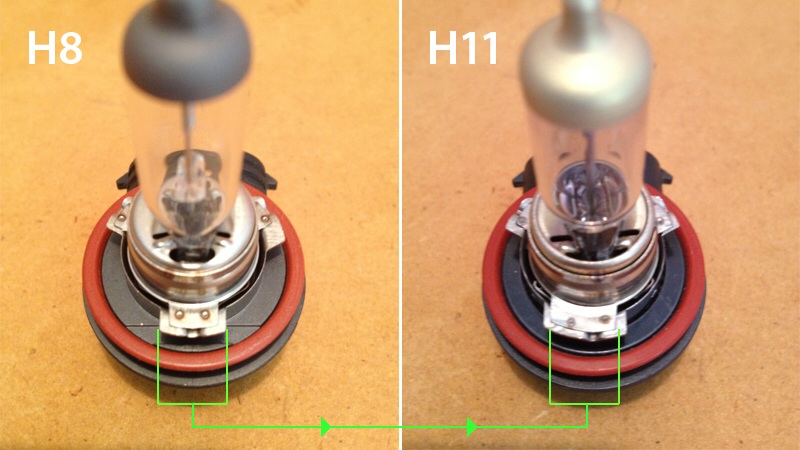

Amazon.com: Valeo 043403 Driver Side/Passenger Side OE Fog Light: Automotive Amazon.com: Valeo 043403 Driver Side/Passenger Side OE Fog Light: Automotive
is that the correct one for 2010 G37 Sedan?
i currently have the H8 fog light bulb from DD. if this is H11, it will still work??

That looks like the same one I purchased last March from an Amazon vendor called AutoHalo. The price has come down a little; I paid $51 for it last year. It is interchangeable side-to-side. The difference is the exterior trim ring, which should be reusable.
The light assembly came with a new H8 bulb.
Jack the front end up, remove the wheel and pull the inner fender liner back. Total job shouldn't take more than about 20 minutes.
Cool. Thnx.
This is on the passenger side btw. I know it was a little tight on that side when I put the fog LED light in.
I have to remove some screws to replace the crack lens, correct?
H8 = 35 watts
H11 = 55 watts
But same type

This is from the 2010 factory manual:
http://www.nicoclub.com/FSM/G37/Sedan/2010/EXL.pdf
Fog light replacement is on page EXL-172. IIRC, there was a bolt to remove and a pawl to disengage and then the light slid out the front. Once you get the liner peeled back, it should be pretty evident how to disconnect everything.

Don't get the Coupe one... It's completely different and mounting points are different

2010 G37 Sedan: Fog Light Crack. Interchangeable? Changed
thanks in advance

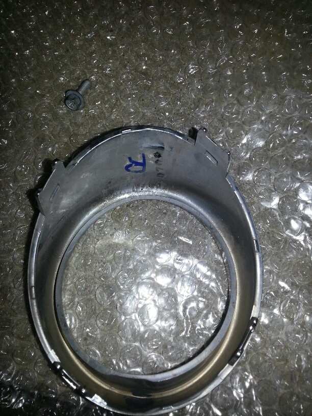

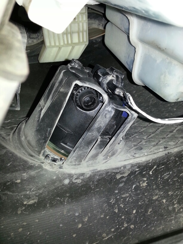

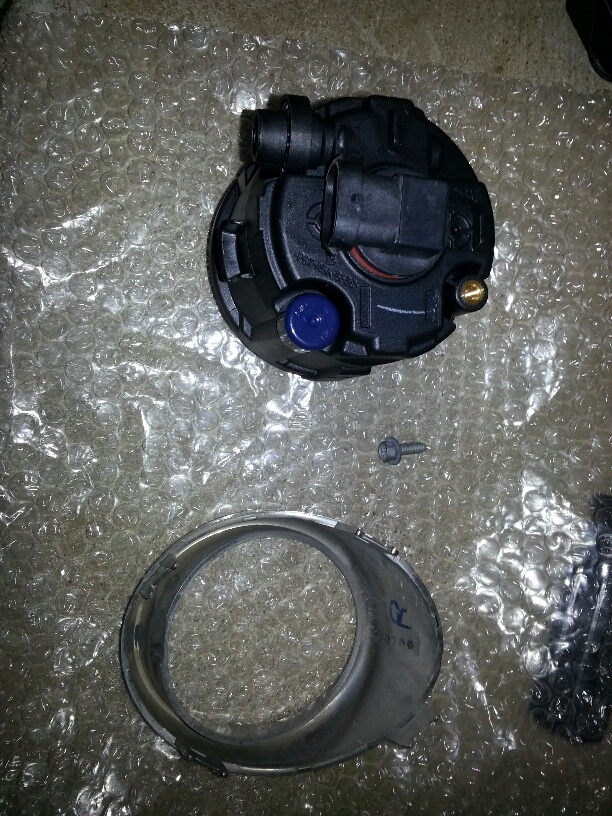

got my lamp in & was able to change today..
took some pics & hope it can help the next person
Advice: I had some LED bulb in there. I recommend you replace the bulb w/ factory if you are waiting for the lamp to come in, in case it rains & water get into your LED bulb. Safety 1st!!
Pic 1: what you working w/. there is one screw you have to take out. it is like an 8MM (see pic 3). you have to press the 4 tab in for the fog ring (see pic 4). the fog ring removed through the front of car. the fog lamp removed to the front also.
Pic 2: fog lamp out. the 8MM screw will be hard to put in. it will be all feel on that there is a black tab that need to press down for the fog lamp to slide out
Pic 3: new lamp, ring, & screw <--- you should remove bulb for more room to work with
Pic 4: fog ring..in case someone want to vinly wrap
Pic 5: get your arm ready for this
Darn 8MM was the hardest part!! to put in that is..
Enjoy & thanks for everyone input
Yes, mines came w/ H8 bulb
I was changing my oil at same time, so i just removed the bottom liner. i hate removing my tire.. gotta go ramp style
Also, this is passenger side so bottom liner will probably b best
