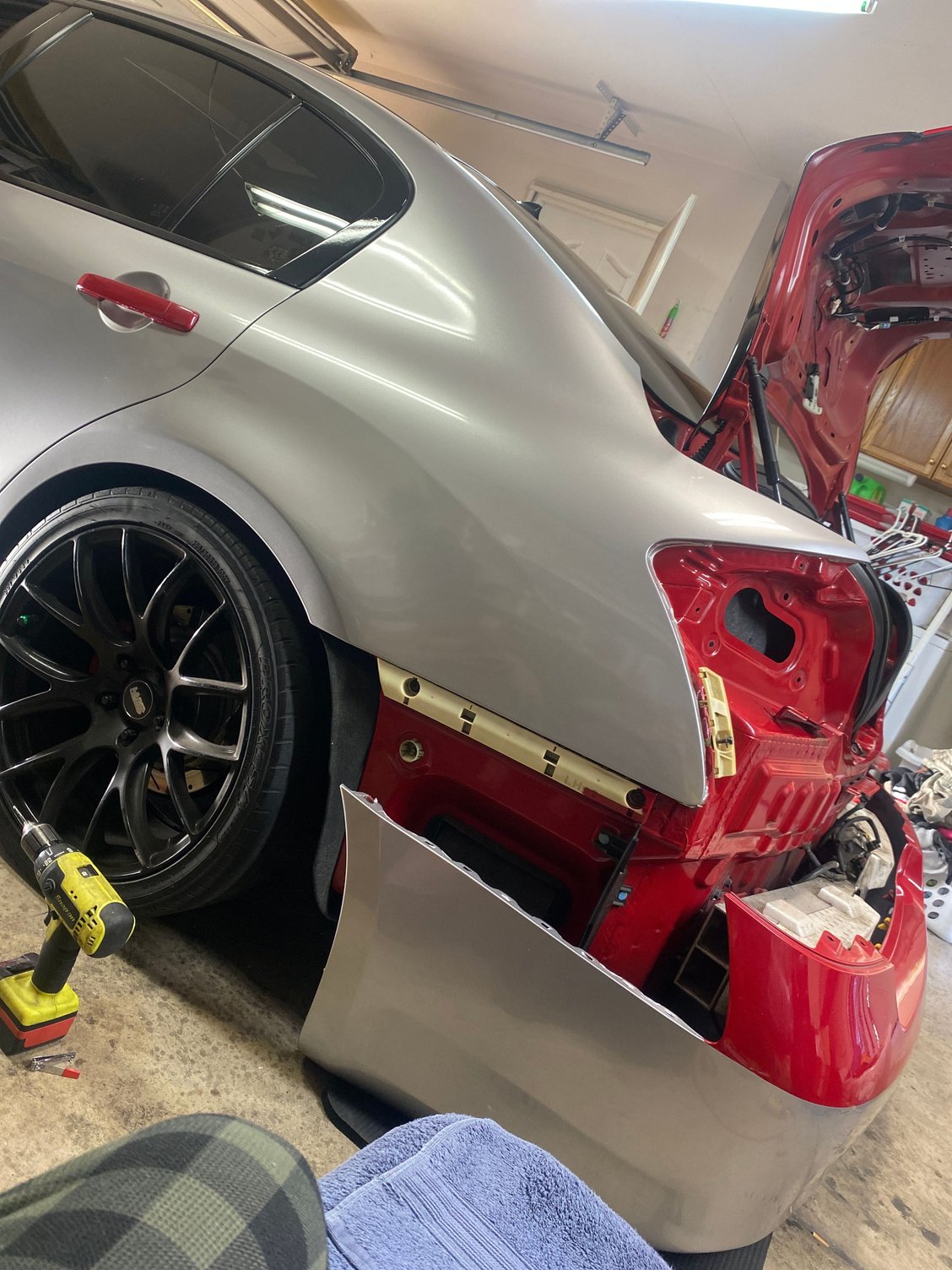

With one comment, you to can help my sagging but affliction
Does anyone happen to know the recommend a torque value, for the bolts that mount up the rear bumper side brackets “A&B?
