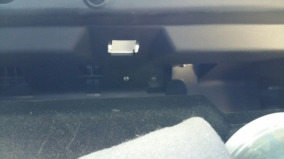

Originally Posted by jomak123
I've replaced that cabin filter already and do not recall a light, nor do I have that window light in my 2011. That thread was 2009. I have no light in my glove box now. Either it's burnt out or I do not have a light there, hence my question.
It's in the same spot from what I can tell. I just looked at my 2011 sedan, and it's in the center of the compartment, on the top "roof" of the box a couple of inches deep. In the pictures from the 2009 model, you can see a white square on the top in some of the pictures. The light is behind that.
BTW, it only works if your headlights are on (perhaps parking lights will suffice)
Try turning your lights on and open the compartment...do you see anything?
Edit:
Here is my light, and I have a 2011 sedan. You said there wasn't even a window there, are you saying it's just black in that area? Is there at least a hole there? Maybe you need to order the part.

With the lights on I found it. This sucks I have to take the glove apart. It was pain last time, grrrr.
