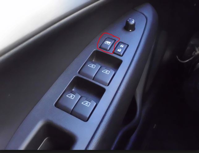

Hello....hope I'm putting this post in the right spot but I have 2009 infiniti g37x sedan n last night my passenger window n both back windows stop working n also the locks stop working but the locks do work if u lock or unlock the doors with key fob n I checked the power window fuse under the hood by the battery already n it's good....so can someone please help me with this issue .? I also did some research on the web n some ppl are saying it might be the circut breaker but I can't find that... One last thing even tho none of the other windows don't work...but the driver window does work ...very strange

Not trying to be smart, but did you happen to push the window lock switch? Circled in red:

Of course I checked that

Same exact issue here as well. Driver's window works fine. Passenger window and both rear windows do not work. Power locks don't work except on key FOB. It is not the window lock feature. Anyone ever solve this?

Hi im new this forum but when i bought my infiniti back in nov 2014 i had same problem with my windows i had to take back where i bought it they had to change whole button pad in door he just put new one in everything worked i didnt have to pay for it hope its not ridicoulus price but that may be problem.

Same problem here. I did all the things that GAWD suggested before reading this thread and nothing.

It must be something related to the driver windows controll module, the one on the picture.
Try to remove that module, disassemble and clean it.

I had the same problem last year, I had to replace the module for the driver's door and everything worked fine after.
The reason mine didn't work anymore was due to the snow entering when I was cleaning the window.
Change the module.

Do you happen to have the part number for the window locking module? Just to make sure, it is the module that GAWD has circled in red on the photo in earlier post. In addition, where do you suggest buying for the the best price?
