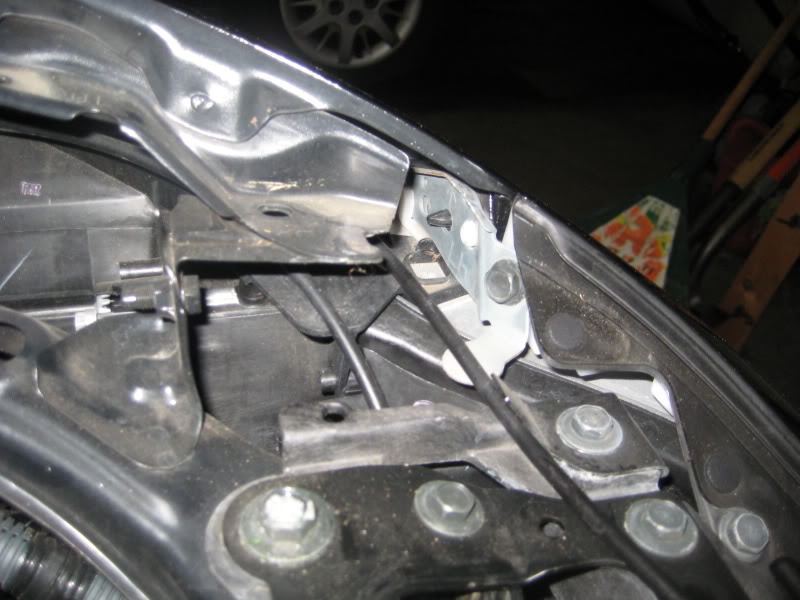

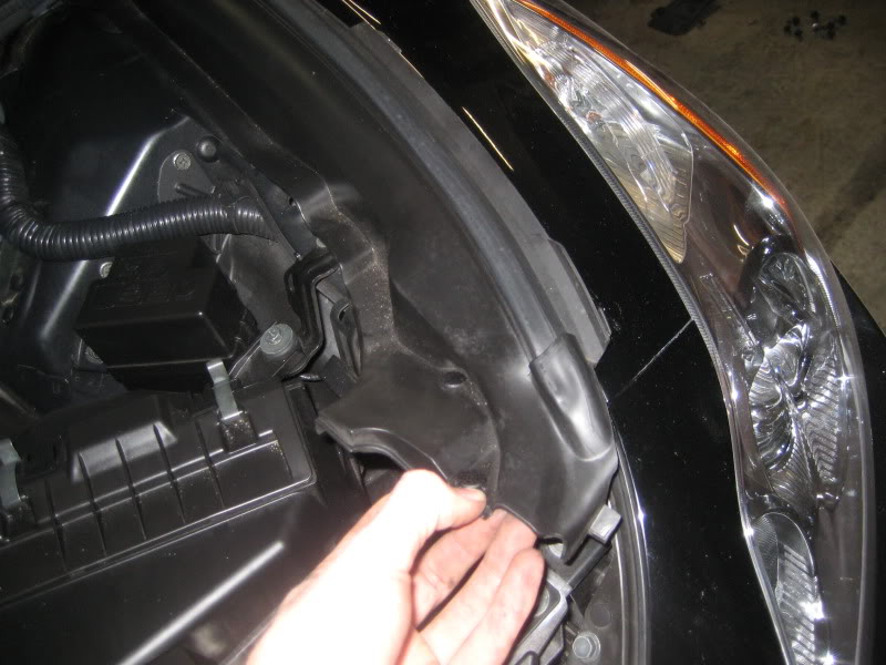

all screws on the bottom plastic piece, 2 the in the wheel well on each side, the 4 or so expanding rivets when you open the hood.
lastly there is one on each far end when the hood is open right where teh fender meets the headlight area.
the 2009 DIY shows those in these pics:
so its literally the same, just the extra bolt in the wheel well
