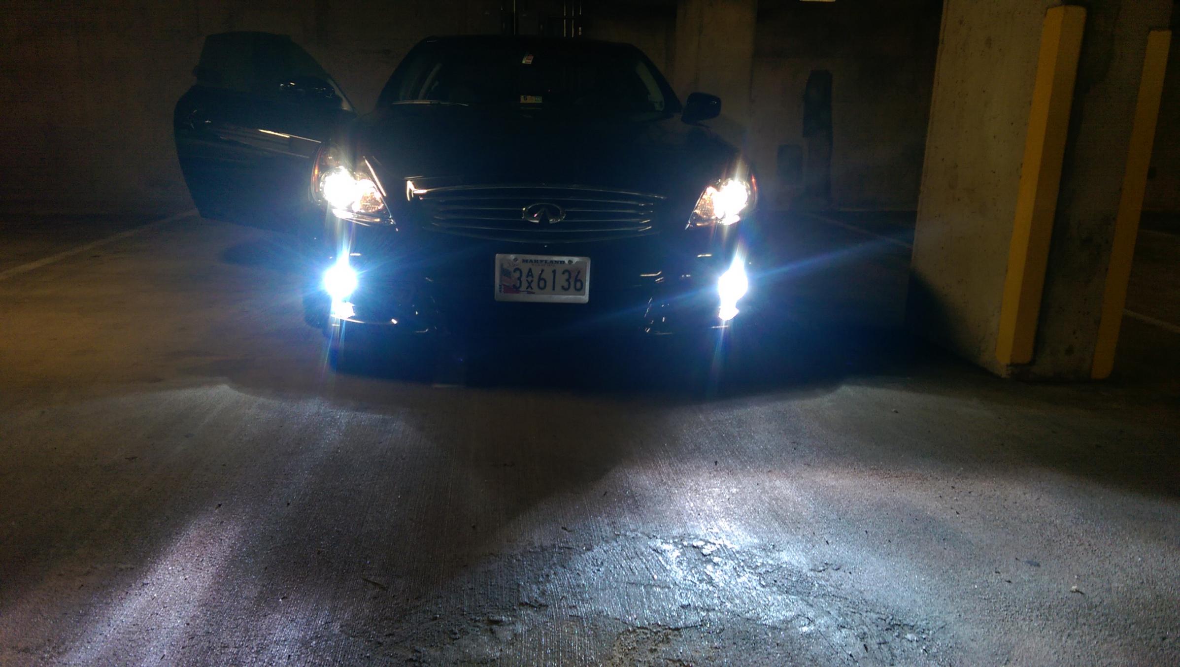

Hi all,

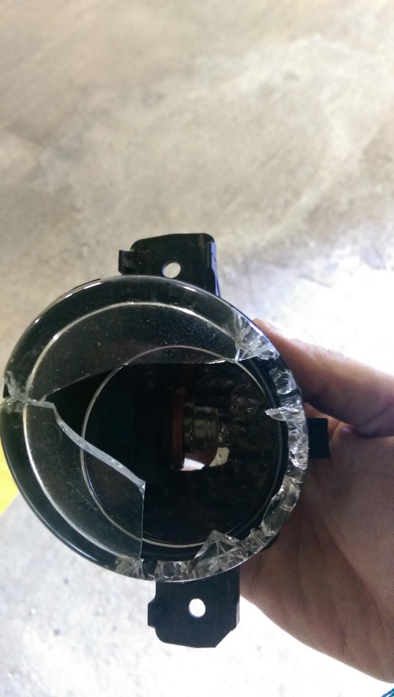

After a bit of hail in Virginia my fog light cracked and the bulb busted too. I needed to replace one but decided to go with HID's on my g37 IPL coupe.
After a bit of research thanks to you guys on the forums, I decided to go with the HIDeXtra H11 6000k HID kit (HID Kits | Conversion Kits | Xenon Headlights | HIDeXtra) which was only about $60. I also purchased the TYC fog light passenger side that was busted for only $55 from amazon (
Robot Check Robot Check
I then followed a DIY to remove the bumper here:
DIY: Quick G37 headlight removal w/ pics
Then I added in the ballasts and soldered the wires in and tested the HIDs and was all set!
Gone are the old hazy yellowish white lights!
Here's the result for only $110!
Attached Thumbnails 2012 G37 HIDeXtra Fog light install-2014-07-19-16.31.54.jpg   2012 G37 HIDeXtra Fog light install-2014-07-19-16.31.41.jpg

Looks good! I installed 6,000k as well.
Did you use a relay wiring harness to draw power from the battery and not the factory plugs?

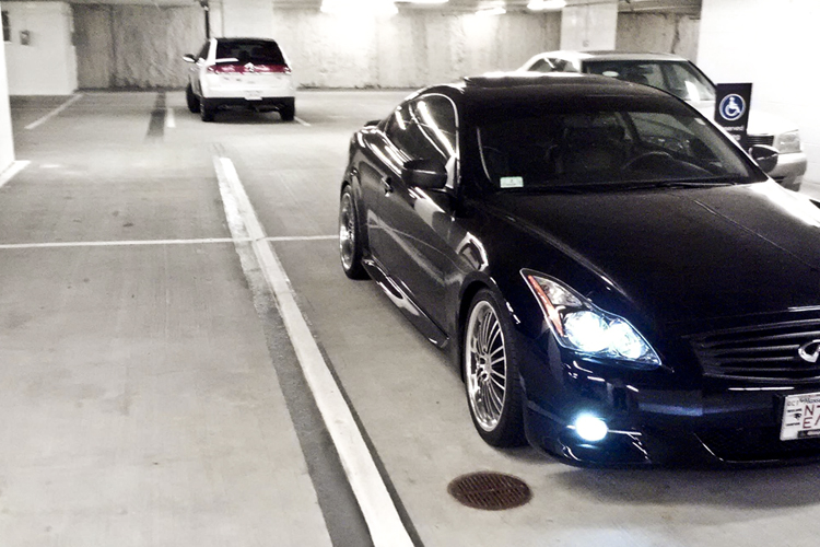

No you need to have you headlights match Looking good
My HIDS were 8k, DRLS were 8 k and fogs were 8k
Attached Thumbnails 2012 G37 HIDeXtra Fog light install-my-g37-8000khids_fogs.jpg
