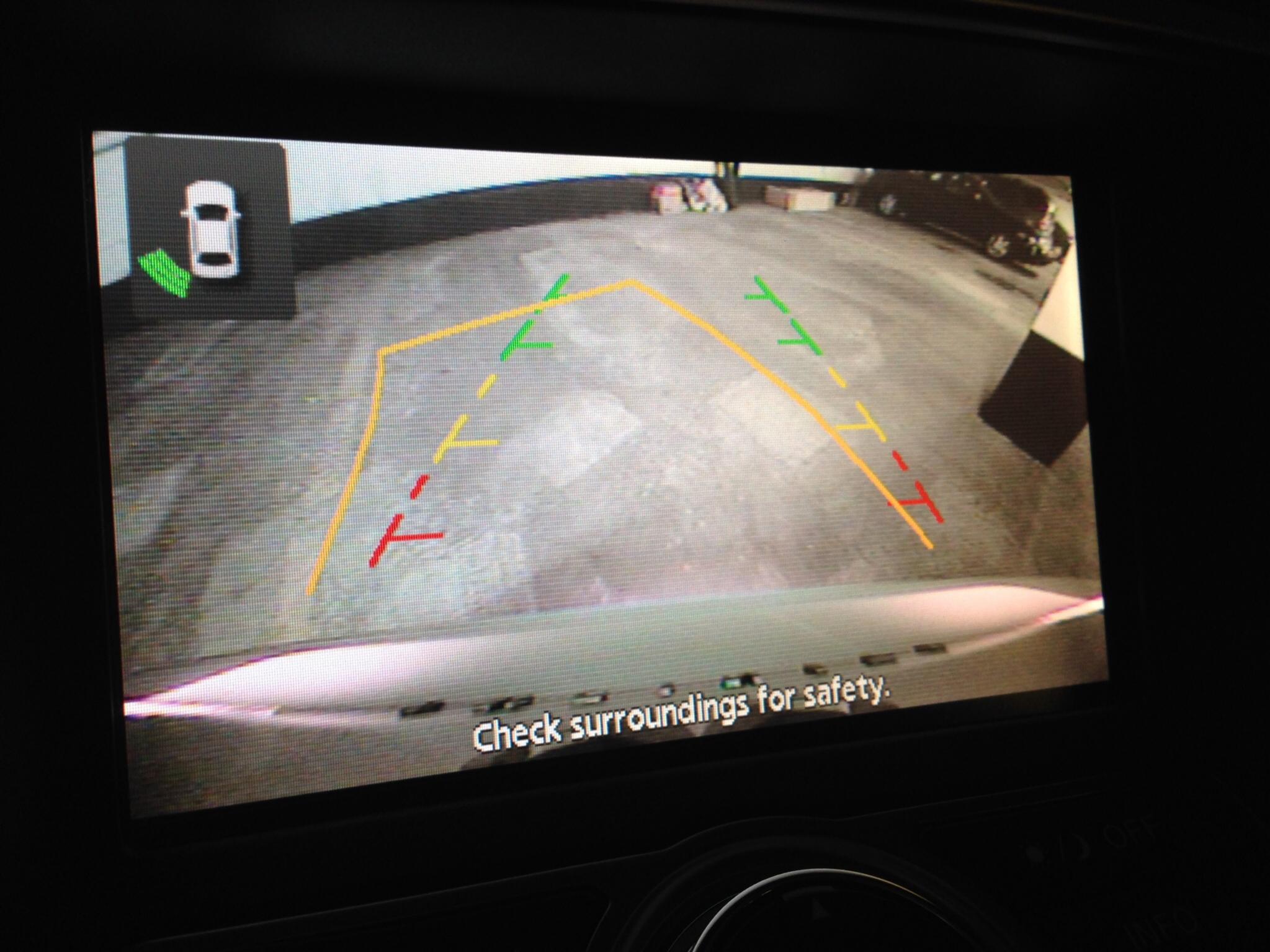

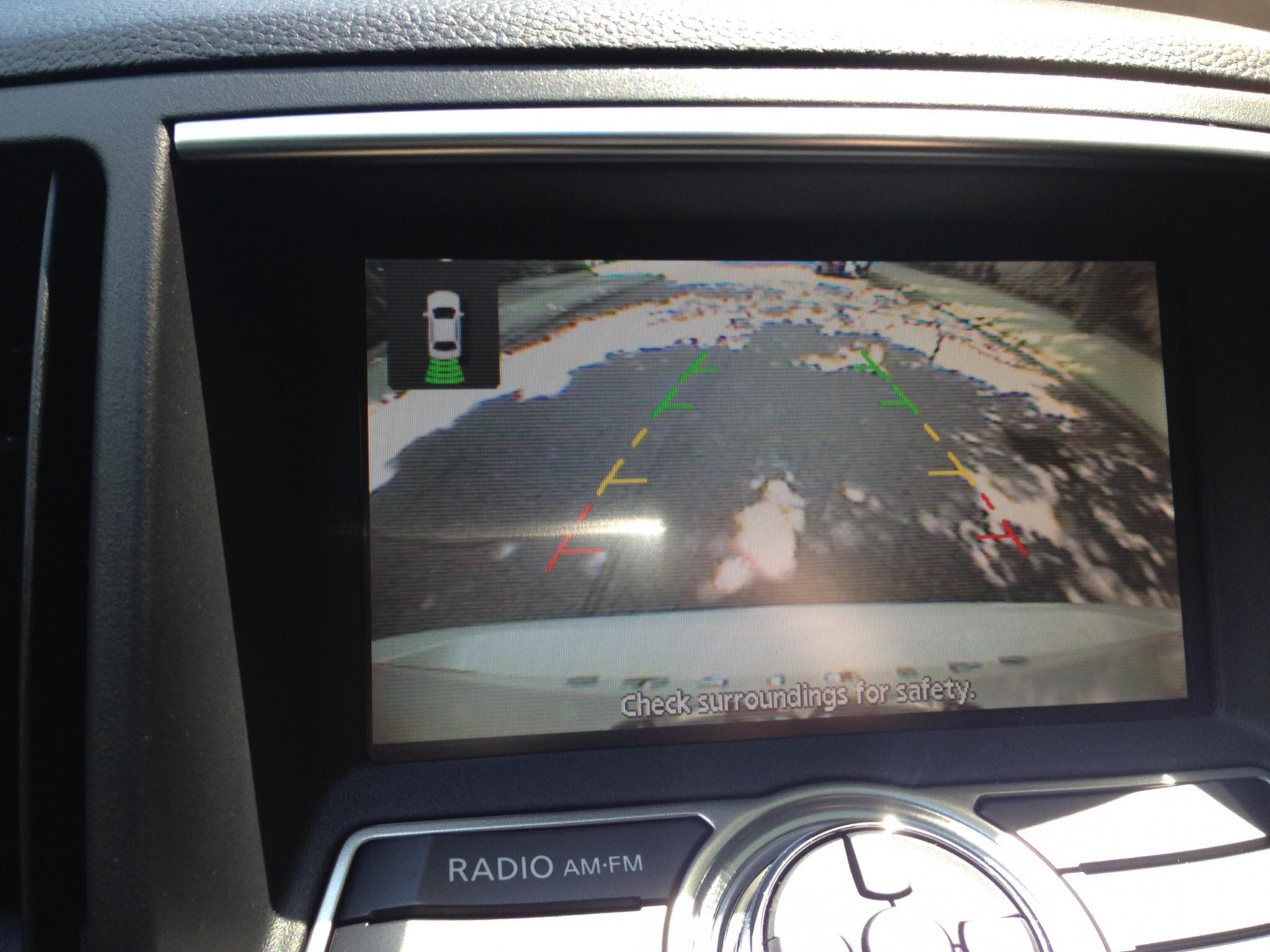

I am not aware of any settings. I'm going to upload some photos to show the symptoms. The sonar system appears to be working fine when there are objects in its close proximity but it's triggered randomly when there's nothing nearby.

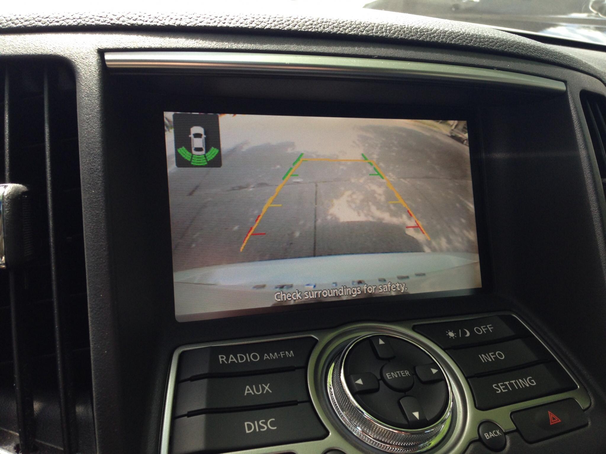

Another photo...

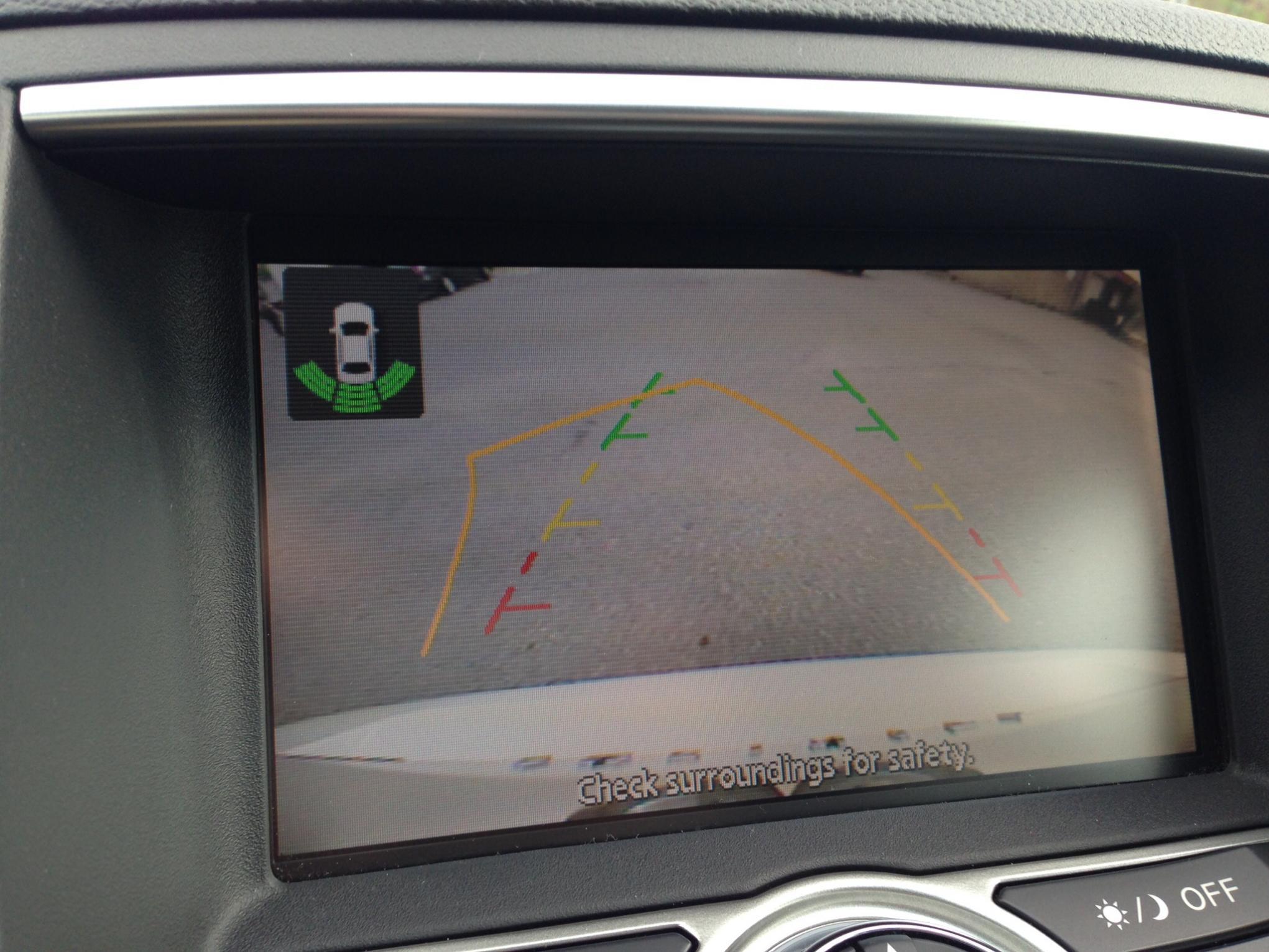

The system is triggered when there's nothing behind.

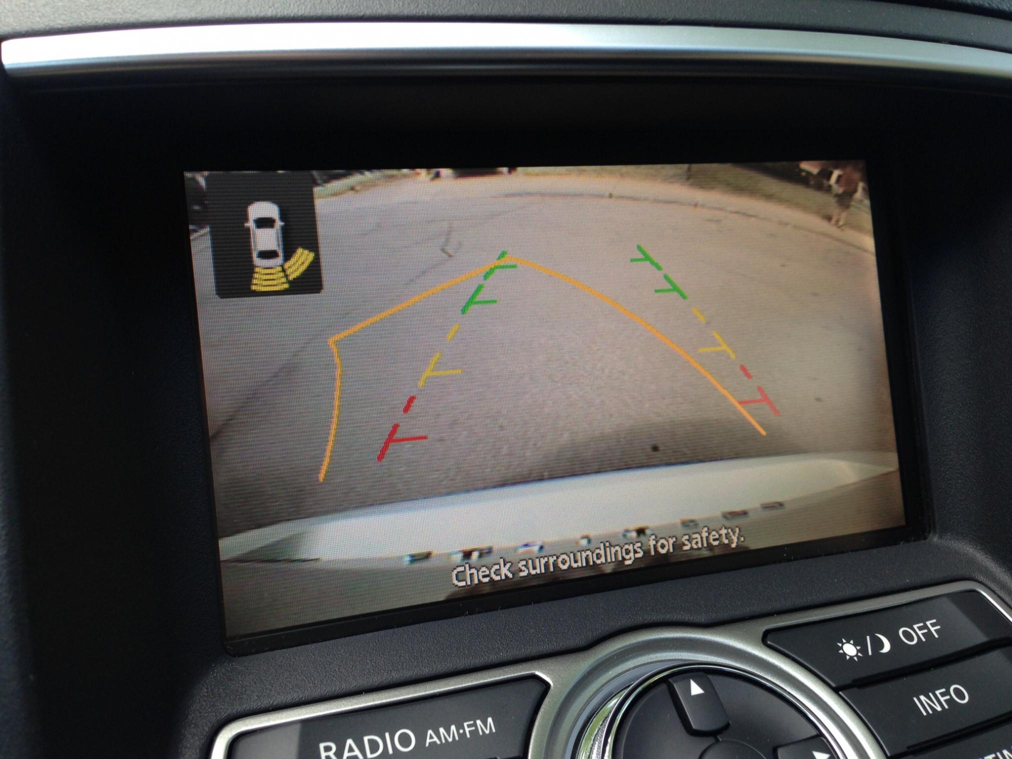

Another similar situation.

And here is a last instance of this weird behaviour. What should I do?

I would say reduce the sensitivity, found in "Settings >> Sonar" on the main screen. Most of your photos look like you are backing out of, or backing into a steep driveway and when set to the highest sensitivity the sonar can see the ground as an obstacle.

Thanks very much. Only the second photo and possibly the third one were done with the car on a very mildly inclined slope. The other three were taken on horizontal ground.

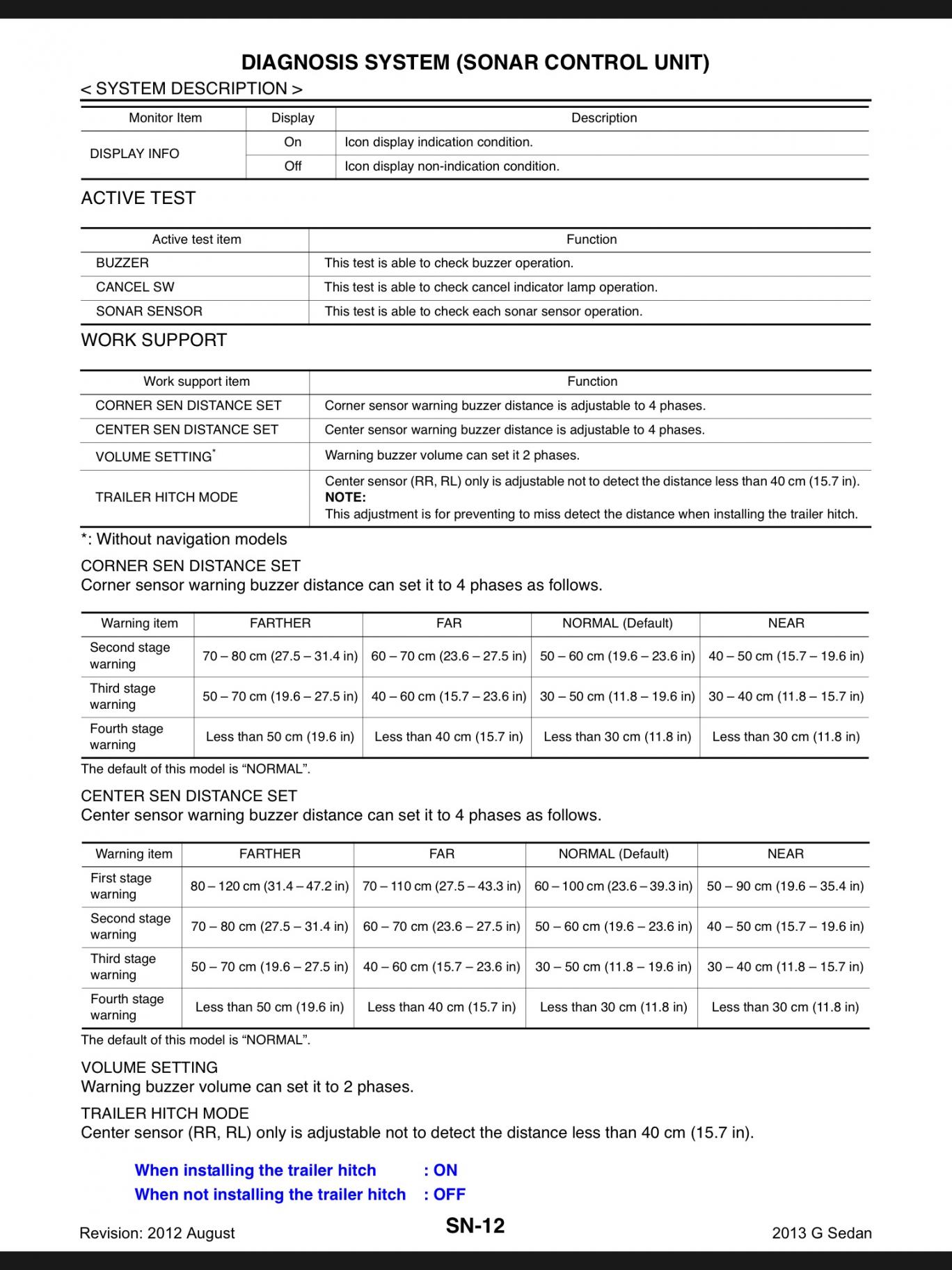

I also noticed on page SN-12 of the N03-SN section of the Service Manual that the sensitivity can be adjusted in four steps with a system (Consult) that only the dealer would have. I hope the body shop did not mess with this setting.

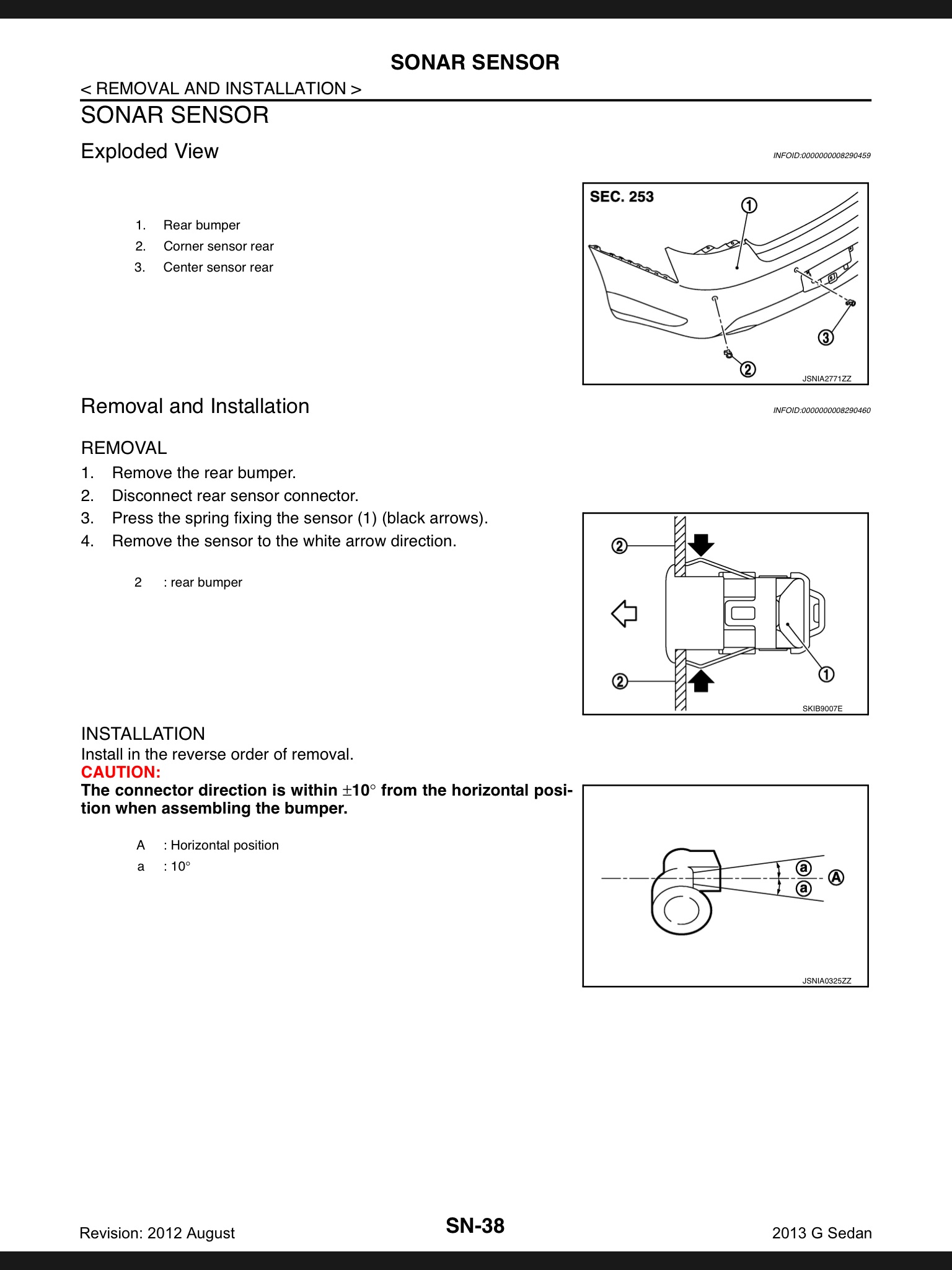

Also, it appears that the position of the sensors is very critical - a +/-10 degrees tolerance. Could it be that the body shop reinstalled them incorrectly? It's a large, reputable and expensive body shop in Toronto, but that does not mean that they could not make mistakes.
Is there a way to check the position of the sensors without having to remove the bumper? Thanks.
