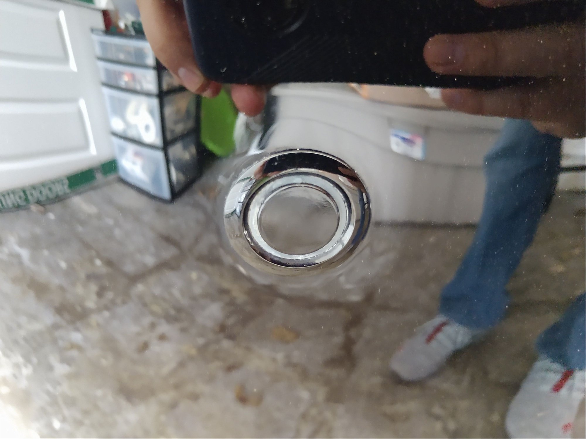

Hi Michael,
I have a question, I just too received work done where they had to repaint my bumper and am now having sonar issues in my 2013 G37x. I was told by my mechanic that there is no way to swap them and they are almost "keyed" for left,right,centers. I have a pic of my passenger side (right side) sensor, is this correct? It is not the center one but the all the way right one, does this look accurate? Sensors are definitely not acting the same as before the repair
