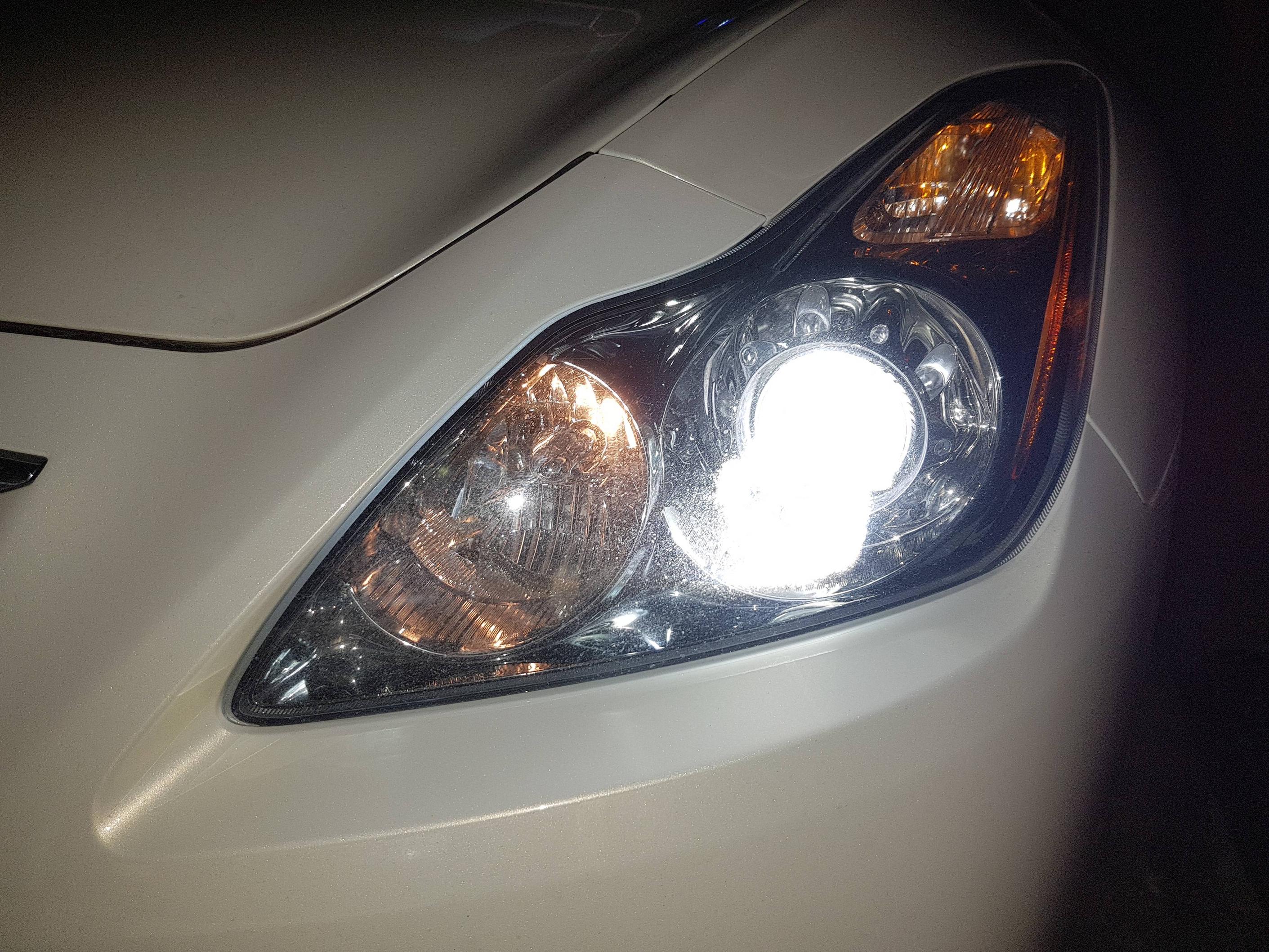

this is how my 2012 coupe's daytime running light / low beam looks like
I don't even need to turn on the lights at night time , it's always like this
