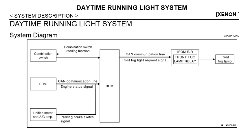

Old Aug 8, 2015 | 12:24 PM
slowbird's Avatar
slowbird
Joined: Nov 2006
Posts: 59
So I yanked the DRL relay to see what would happen. The front lights still function the same. They are still on all the time except for the fogs.
The only difference was the rear tail lights weren't on....and they wouldn't turn on even when fully activating the headlights.
Now another member on here has a 2009 and his DRL's are his fogs only.
https://www.myg37.com/forums/g37-cou...e-as-drls.html
Looking at the 2 schematics for the DRL's for those 2 different years you can see the difference.
I wonder if the DRL relays are swappable? EDIT: (on second thought I don't think that makes any sense)
Attached Thumbnails Canadian Car DRL Disable-drl2009.png   Canadian Car DRL Disable-drl2012.png
