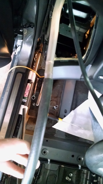

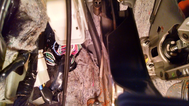

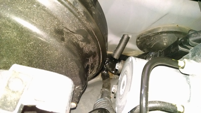

Originally Posted by scotts99snake

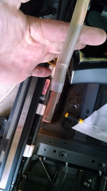

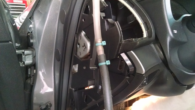

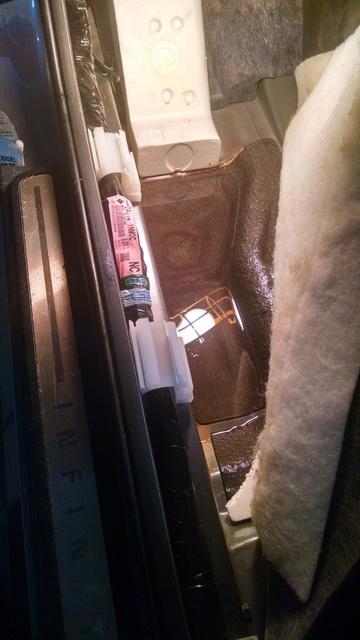

I had this same problem in my girlfriend's car. The sunroof drain runs from the sunroof down behind the a-pillar and connects to a plastic coupler behind the dash. This coupler runs through the firewall (you can't see it in the engine compartment) and drains the water. Apparently, the gasket deteriorates over time and the water then drains down the kick panel and under your carpet. Unfortunately, you don't notice it until it has been leaking for quite a while. When I pulled her car apart there must have been 2" of water on the floor board. By the little bit of research I did, the fix is to pull the dash and silicone the coupler to the firewall. I wasn't going to pull the dash so I crammed my fingers behind there and tried silicone-ing it....twice. No help. Then I started to worry if I did get it to seal that it would eventually leak again. So, I fixed it another way.
I had already started sucking the water out...
Attachment 136953
Here is the sunroof drain along with a piece of copper tube I used for a coupler.
Attachment 136954
Attachment 136955
I slid a piece of rubber hose over and added zip ties so I didn't slide off.
Attachment 136956
Attachment 136957
I then routed it behind the dash, under the brake pedal (I had to unbolt it - not shown) and through the hole in the firewall.
Attachment 136958
Here is where it comes out in the engine compartment.
Attachment 136959
Maybe not the "proper" thing to do but it cost me nothing and I will never worry about it leaking again. I did remove the driver's seat and some trim allowing me to lift the carpet up. I sucked out all the water and allowed it to dry in my garage for a couple of days with a fan on it.
Attachment 136953
Attachment 136954
Attachment 136955
Attachment 136956
Attachment 136957
Attachment 136958
Attachment 136959
what about the passenger side? I’m planning on doing this and run the extended hose to the ac drain

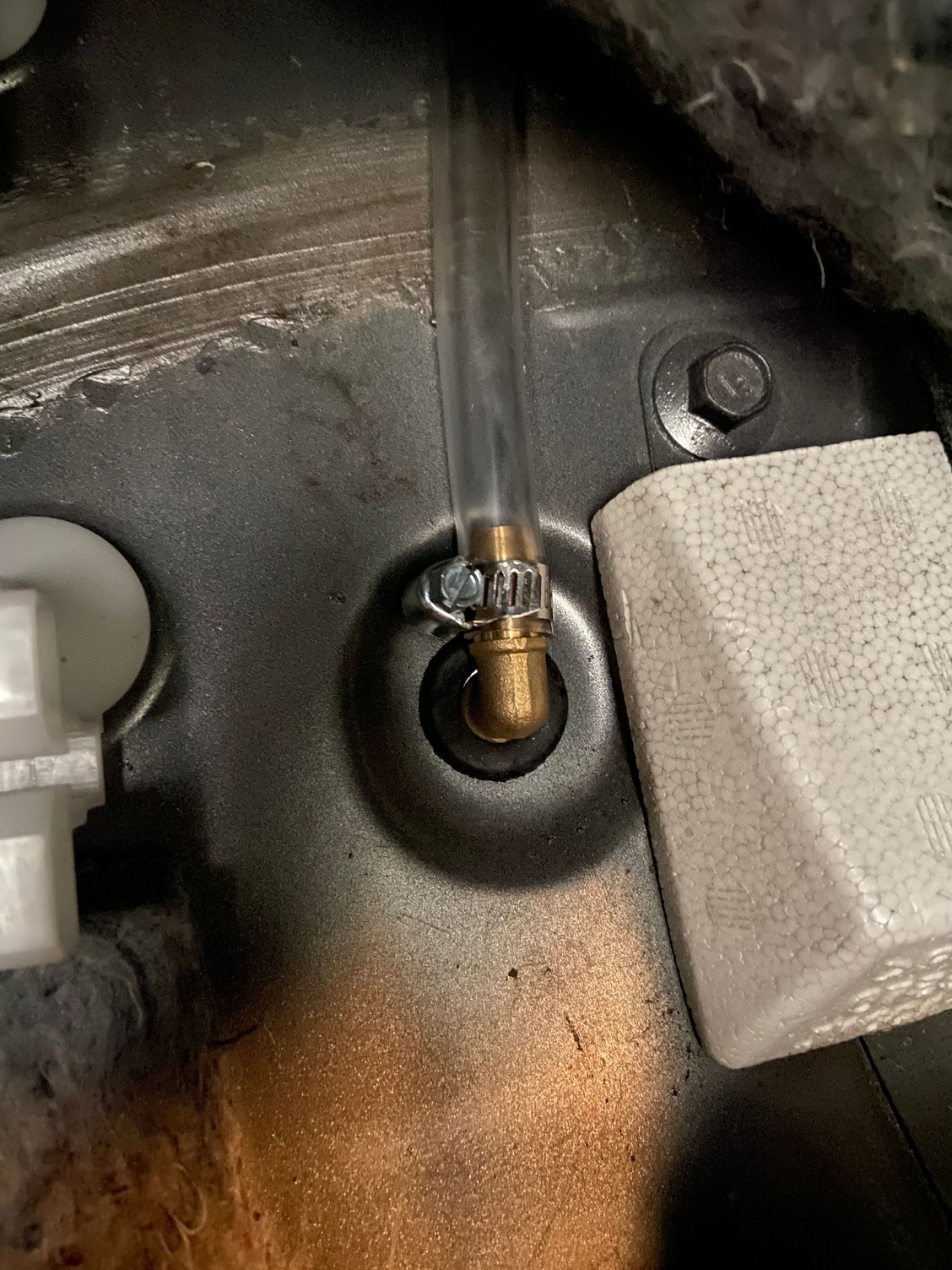

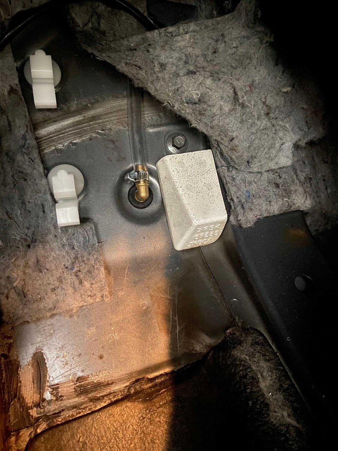

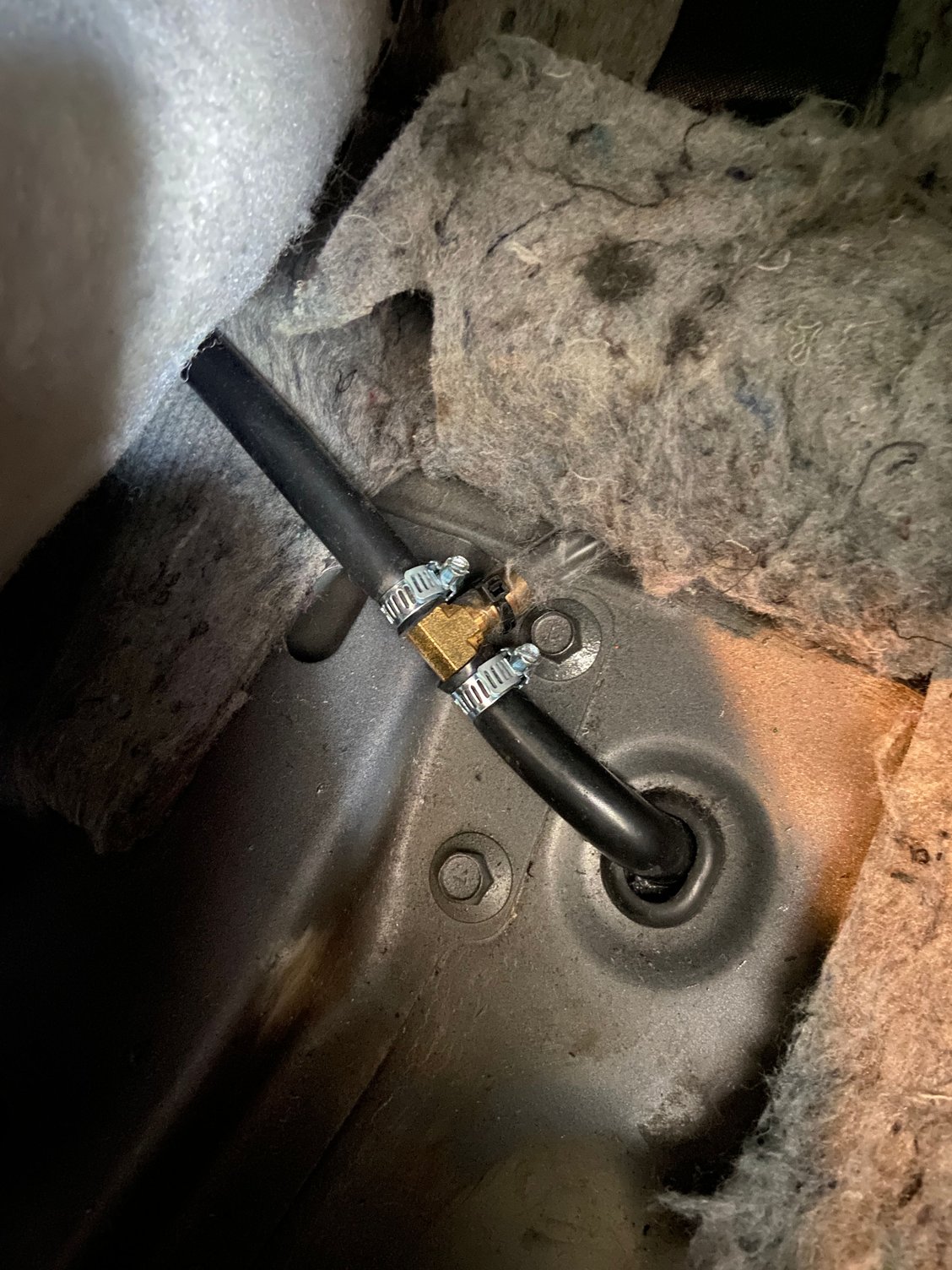

Fixed once and for all.
So today I re-routed both driver and passenger side drains. I tried the YouTube straw extension on both driver and passenger sides. Worked for about a year. Then leaks returned. So fed up decided to reroute. It’s actually easy. Passenger side splices into AC drain tube. Drivers side, drilled through firewall near dead pedal, elbow joint and out a pre drilled opening in floor board. Easy actually.
