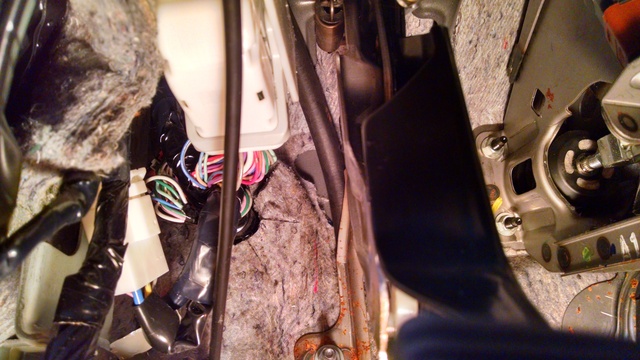

I had this same problem in my girlfriend's car. The sunroof drain runs from the sunroof down behind the a-pillar and connects to a plastic coupler behind the dash. This coupler runs through the firewall (you can't see it in the engine compartment) and drains the water. Apparently, the gasket deteriorates over time and the water then drains down the kick panel and under your carpet. Unfortunately, you don't notice it until it has been leaking for quite a while. When I pulled her car apart there must have been 2" of water on the floor board. By the little bit of research I did, the fix is to pull the dash and silicone the coupler to the firewall. I wasn't going to pull the dash so I crammed my fingers behind there and tried silicone-ing it....twice. No help. Then I started to worry if I did get it to seal that it would eventually leak again. So, I fixed it another way.

I then routed it behind the dash, under the brake pedal (I had to unbolt it - not shown) and through the hole in the firewall.

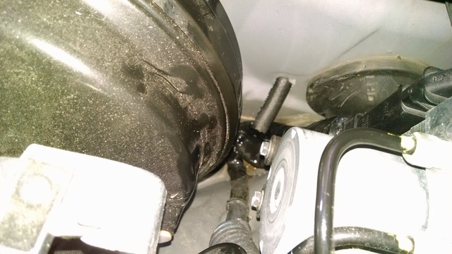

Here is where it comes out in the engine compartment.

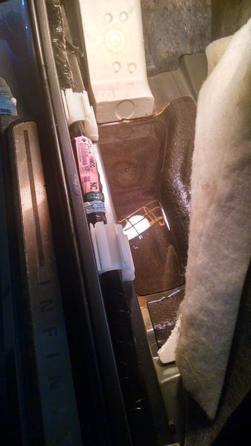

Maybe not the "proper" thing to do but it cost me nothing and I will never worry about it leaking again. I did remove the driver's seat and some trim allowing me to lift the carpet up. I sucked out all the water and allowed it to dry in my garage for a couple of days with a fan on it.
