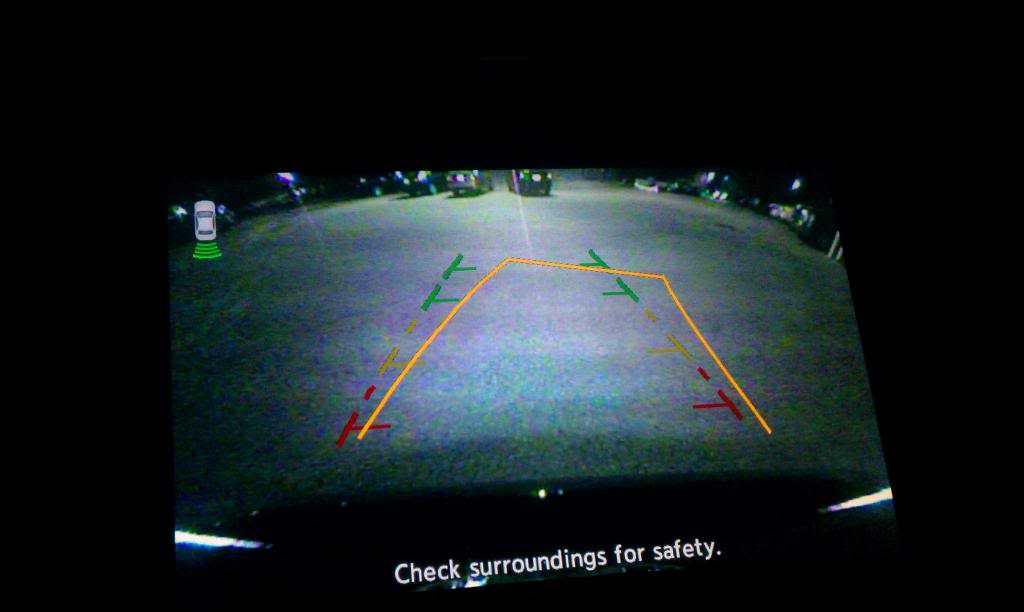

nothing behind me

i dont think so, i had my gf, walk behind the car, and it went from green to yellow, on the side which was damage, probably should have turned red, not sure how close she walked. and sometimes it doesn't go off until i start going backwards.

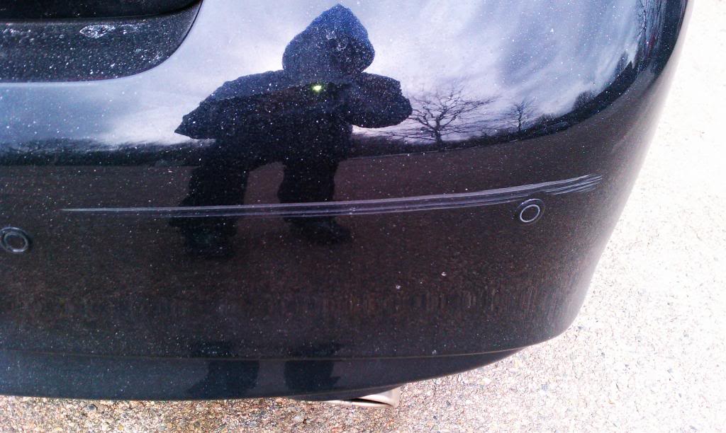

This was my damage.
I'll take a new pic tomorrow. after looking at this pic, i thought maybe the middle senors was pushed in too far, but that how its suppose to be. Appears to be some type of calibration that's needed.

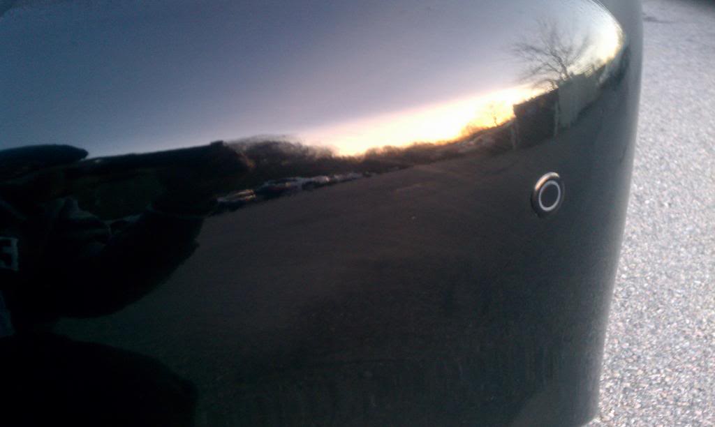

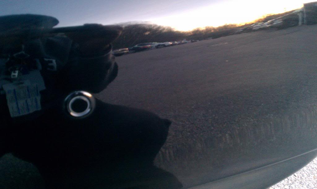

After paint job;
