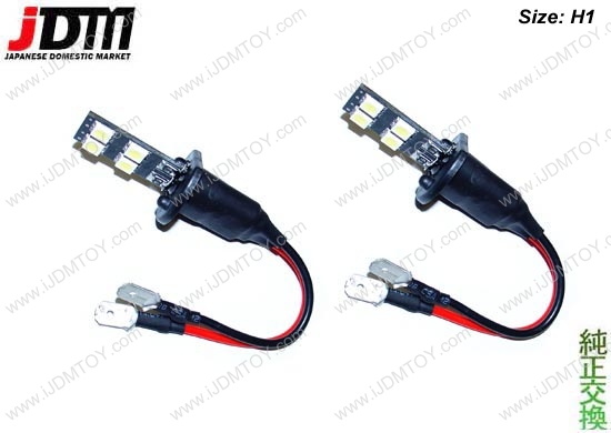

so i ordered h1 led bulbs for my FOGS and they came lookin like this ..
first when i tried plugging it in, i couldnt figure a way for the clip to hold the bulb steady, and secondly where to plug those wires? from what i understand from the email, is plug the red into the yellow wire? and what do i do with the black one?!?!?!?!? :confuse d2:

This is for your fog right?
Plug the red into the yellow and the black into the black. If that doesn't work, plug the black into the black when it is on the headlight metal part.
Im a bit confused to which black wire am i plugging the black one into? When i checked the housing, i only saw a yellow wire to plug into. The black wire is just a cover to some little red metal piece? and yes this is for my fogs
Old Feb 10, 2009 | 03:01 PM
ucla bruin's Avatar
ucla bruin
Joined: Nov 2007
Posts: 6,776
From: Orange County
When you open your fog cover, there are 2 wires, a black one and a yellow one. The yellow one is plugged into the bulb, the black one is plugged into part of the metal housing.
i will check again, but i remember seeing the black one kind of welded into the metal housing.. where do i plug the black wire into? to i stick it in to the black rubber cover of that metal housing?

Old Feb 10, 2009 | 03:18 PM
ucla bruin's Avatar
ucla bruin
Joined: Nov 2007
Posts: 6,776
From: Orange County
That black wire is not welded. It can be unplugged, but first check if there's room for you to just stick the black wire from your new bulb into the black wire on the metal housing. Peel back the rubber cover so you can expose the plug more.
