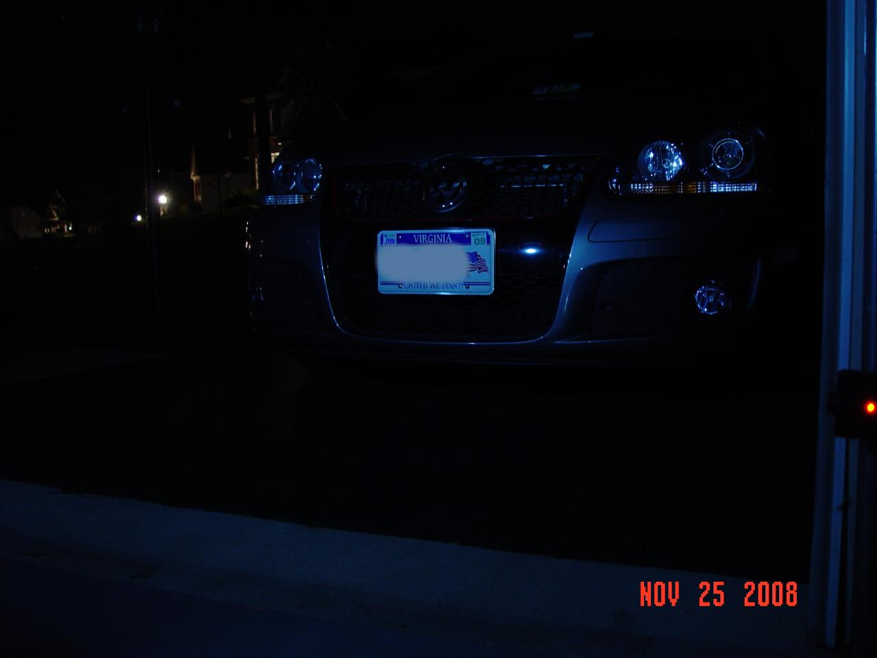

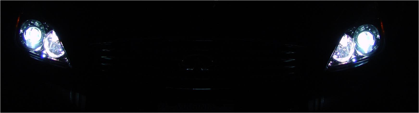

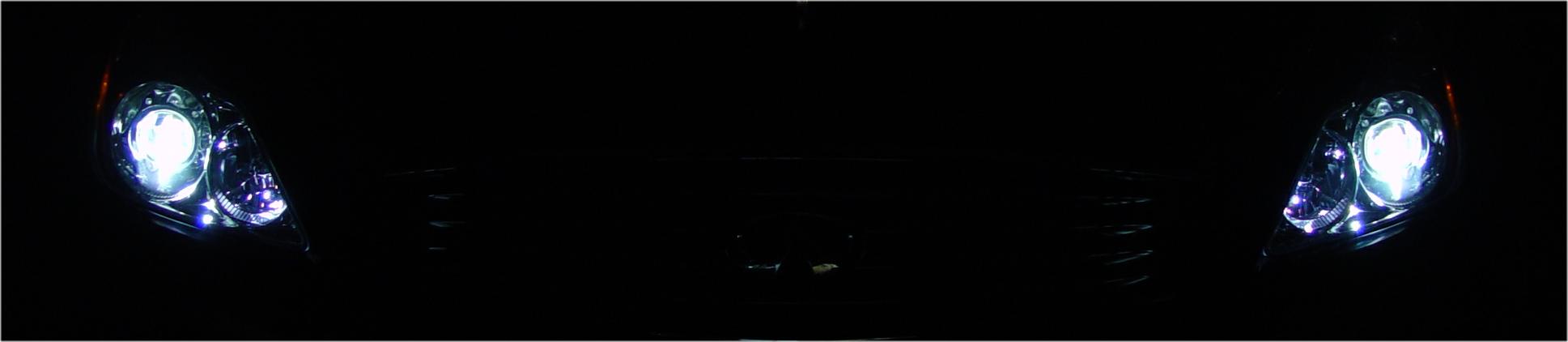

More Conservative Light Change – Part 2
Overall, my goal was to get as close to the stock headlight color (4300K) inside and out. I posted all of my LED changes in this thread in Post #73 and they came out real good.
Today I changed my Fogs, City and Backup lights as follows:
Fogs: PIAA Part #11655 H1 Xtreme White Plus @ 4000K
City Light: PIAA Part #19172 168 Xtreme White Wedge Bulb to match Fog
Source: amazon
Backups: 25 Led SMT Tower III 194 168 W5W 2825
Source: autolumination
There are many before and after pictures of the front light changes. So I am only posting my results to let you see how close it is to the stock HID in color. The City light is the closest match. The Fog is much whiter than stock, but not quite a perfect match up close. However, it is close enough for me so I’m done with this project, BUT if I was doing it over I would probably try the 4700K PIAA instead of the 4000K.
I used this DIY for the Fog and City. Fog and City DIY. It has great pictures that helped a lot. However, I went in through the top instead of the wheel well. I took off the stock air boxes and you can do it without disconnecting the wiring……just one bolt and one screw on each side. On passenger side also take off the washer filler neck.
For the tail lights I used this DIY. Tailight DIY. It gave me the basics.
All of the pictures were taken about 4-6 feet from the car. The farther away the closer the color match.
Attached Thumbnails LEDs installed for vanity mirrors, doors and license plate-just-city-on.jpg   LEDs installed for vanity mirrors, doors and license plate-fog-and-city-on.jpg   LEDs installed for vanity mirrors, doors and license plate-reverse-light-left-is-led.jpg

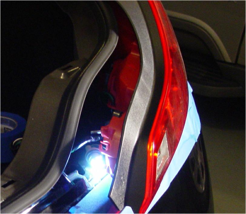

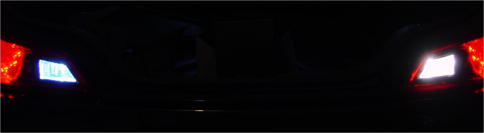

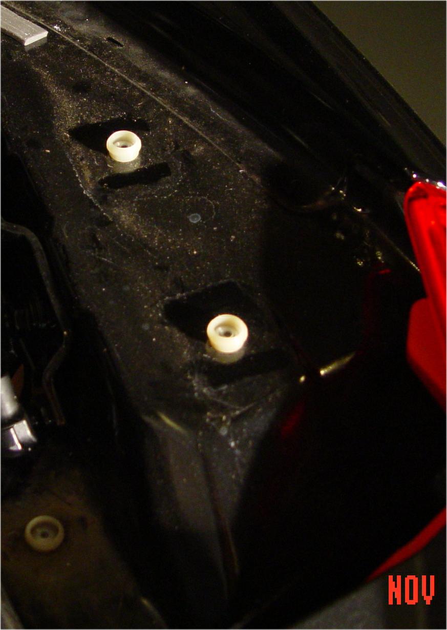

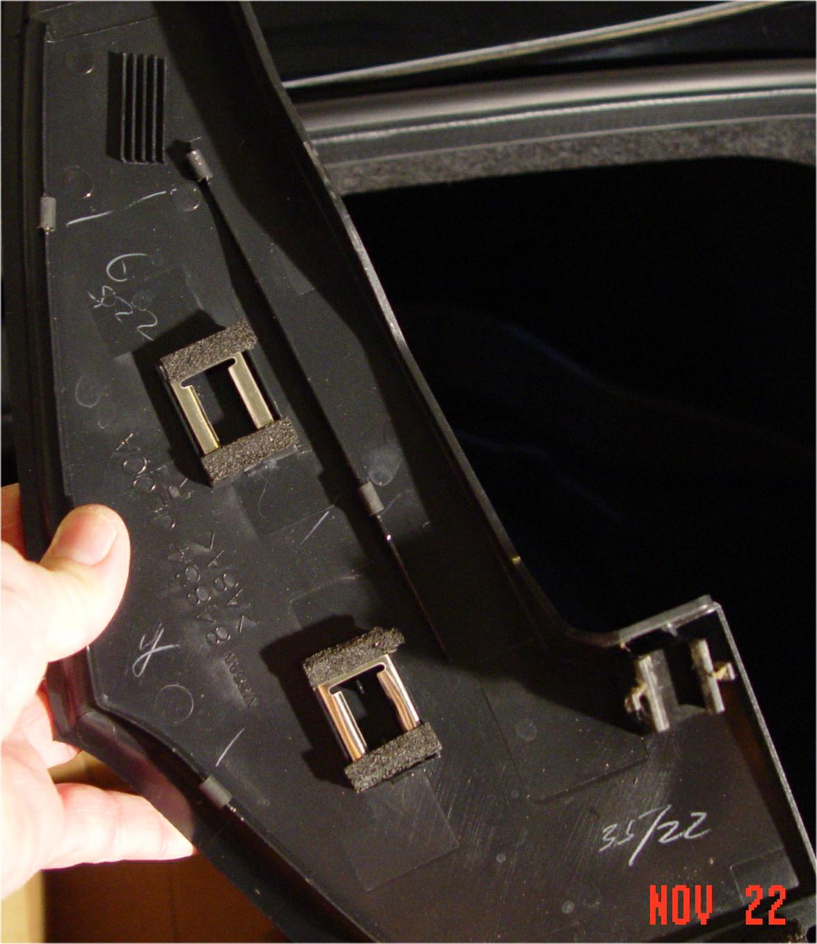

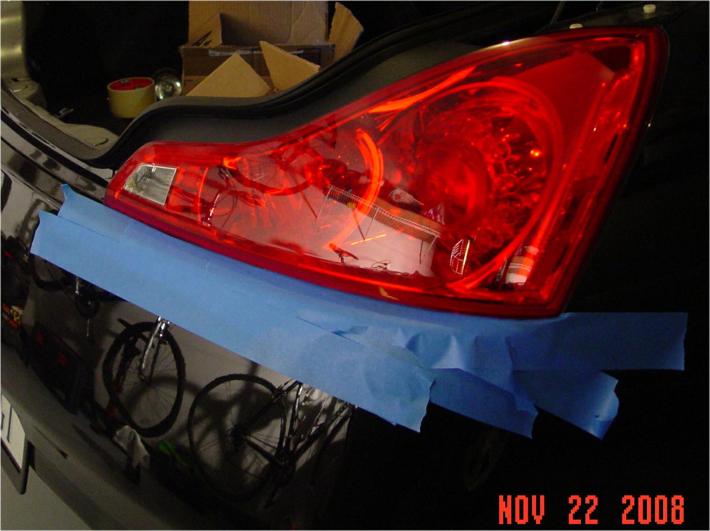

Couple of Suggestions on Reverse Light Change
Here are a couple of things to consider when changing the reverse light. It made it a little easier for me.
Picture 1: Strongly suggest you blue tape off the fender. Prevents scratches and helps with my way of changing the bulbs.
Picture 2: When you pop off the cover, it may look like this. However, my clips (in picture 3) stayed on the white taps you see in this picture.
Picture 3: Note that the little tabs are bent up. This will happen normally if they stay on the car when you pull up the light cover. If they stay on the car, then carefully pry them off the white tabs.
Picture 4: Put the connectors from picture 3 back onto the cover. Take a flat screw driver and make sure to bend up the tabs so the connectors are tightly on the light cover.
Picture 5: When I pulled out the light, I left everything connected. I just reached in by the reverse light and took one cable off its plastic tabs to give me a little room to work. WHile holding the light in one hand, I just reached in and took original bulb out. Sat the light on the bumper. Put the LED in. It was a very solid fit. Sat the whole light assembly back down and tested the bulb. Then put everything back together.
The cover and connectors attached in picture 4 just snaps back on.
Good luck.
