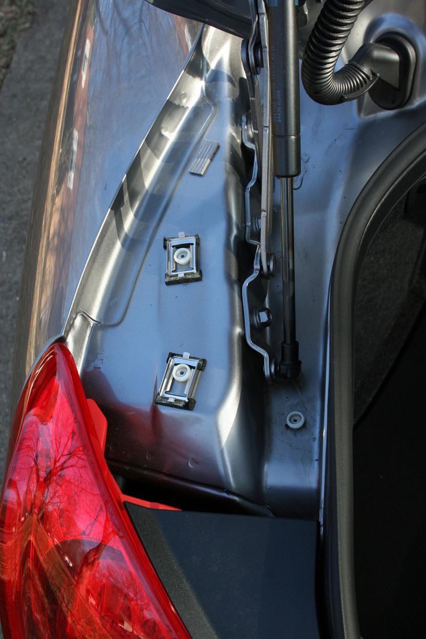

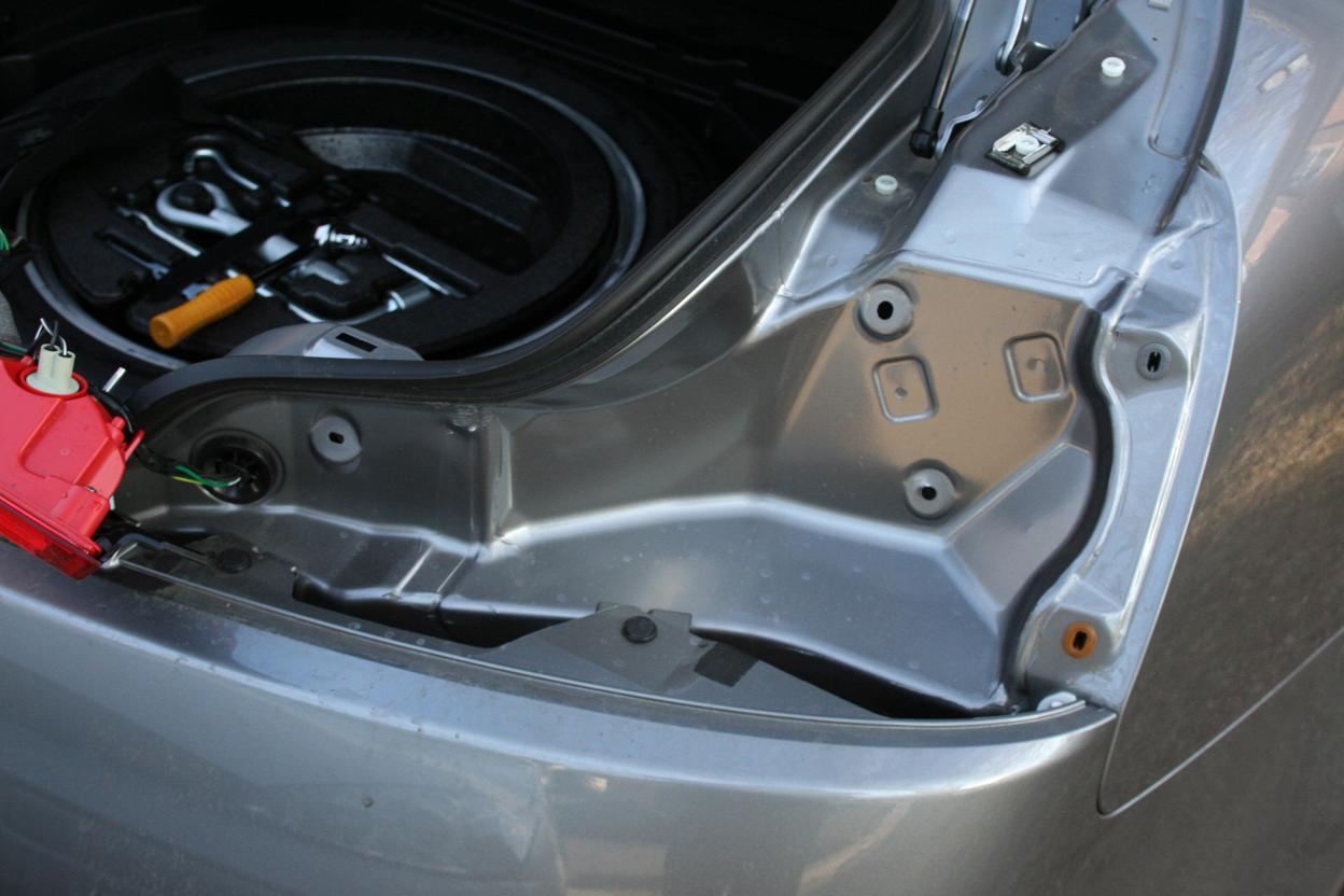

Attached Thumbnails Removing Tail Lights! Frustrated!-img_1558.jpg   Removing Tail Lights! Frustrated!-img_1559.jpg   Removing Tail Lights! Frustrated!-img_1557.jpg   Removing Tail Lights! Frustrated!-img_1560.jpg   Removing Tail Lights! Frustrated!-img_1561.jpg

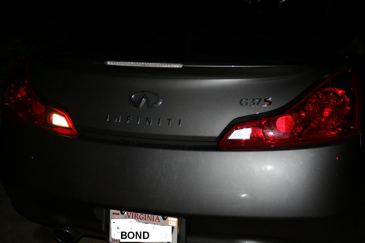

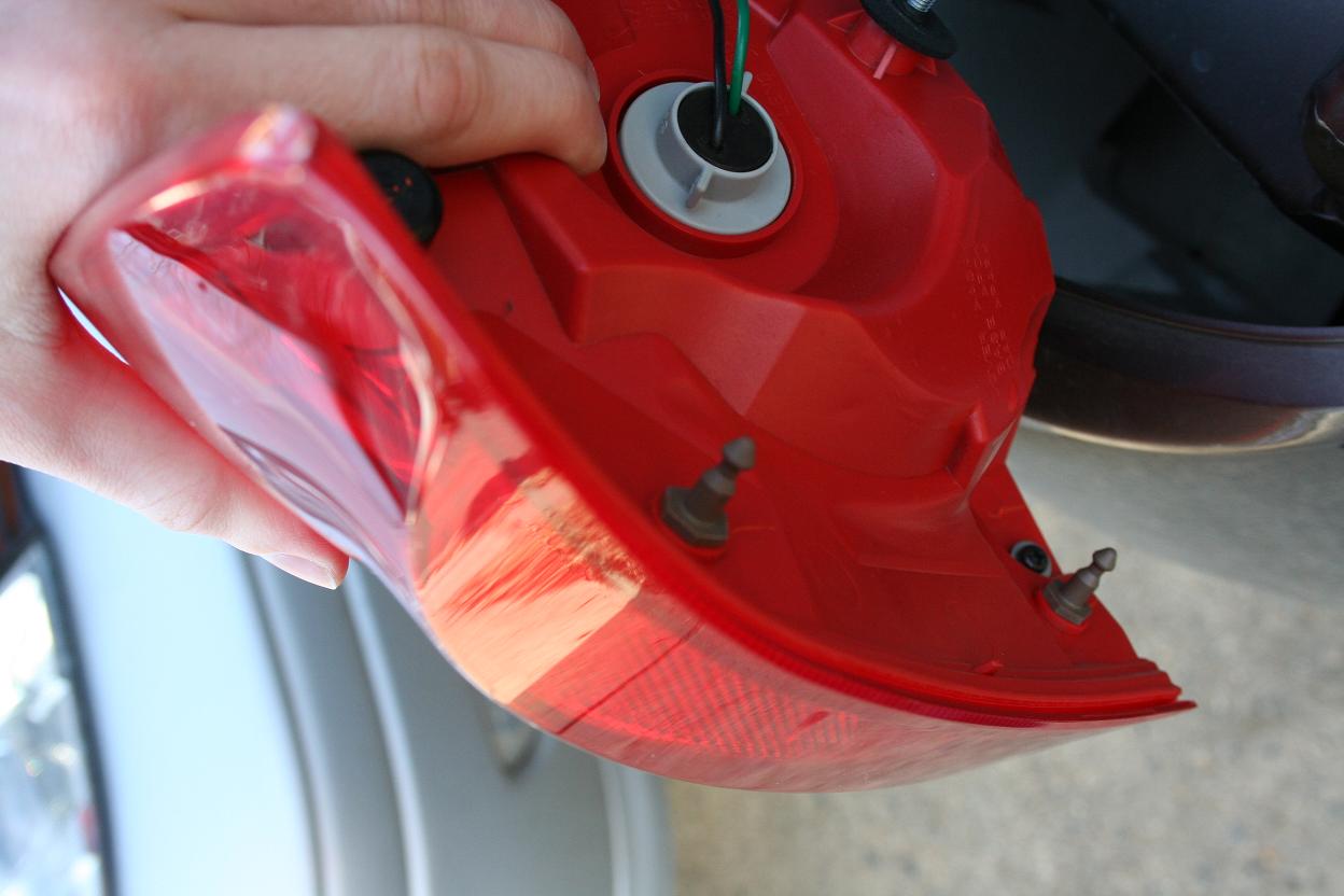

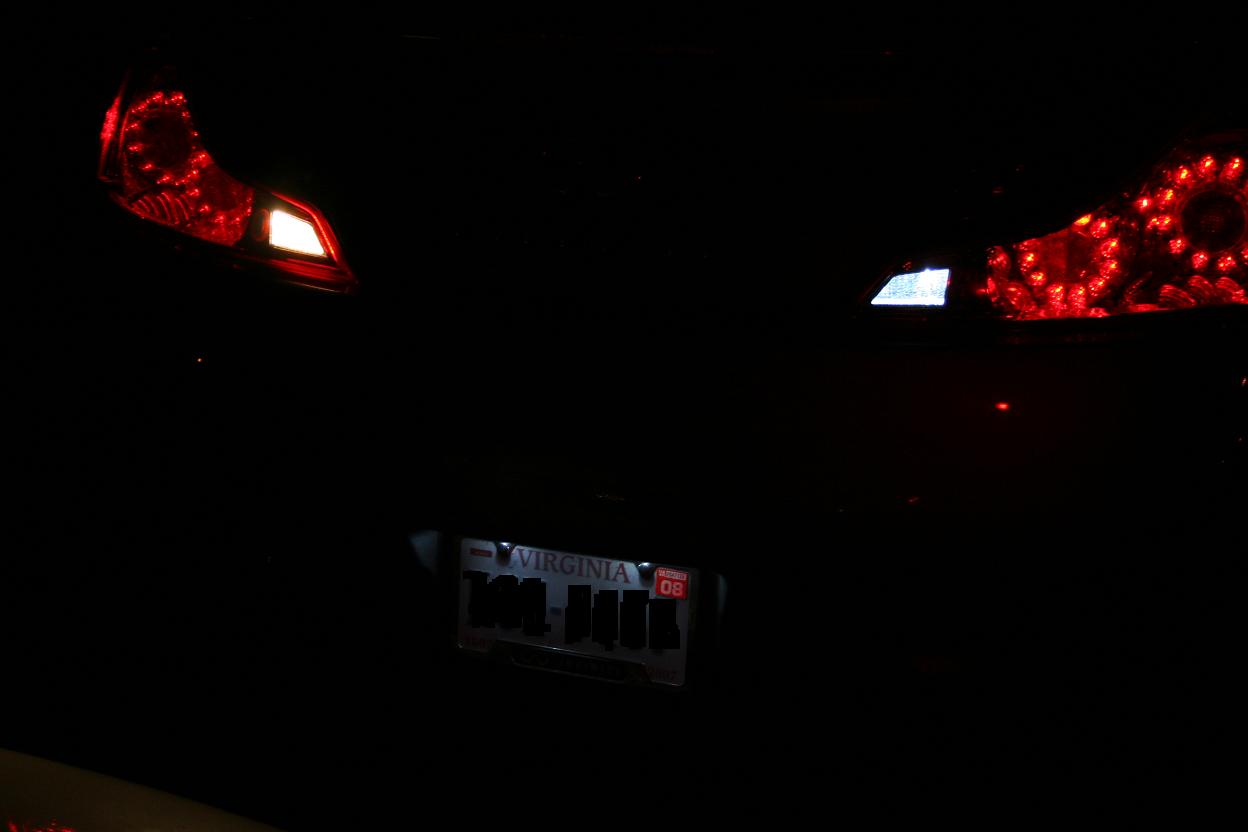

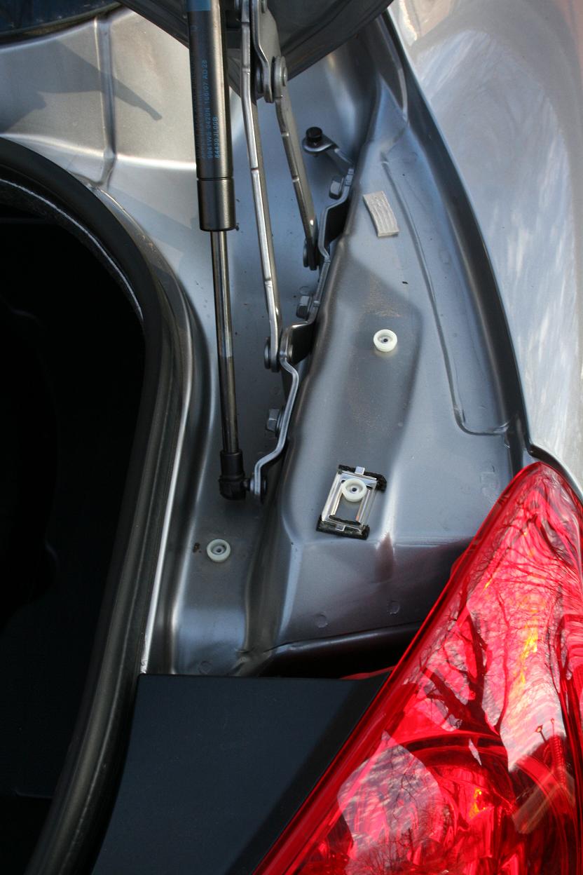

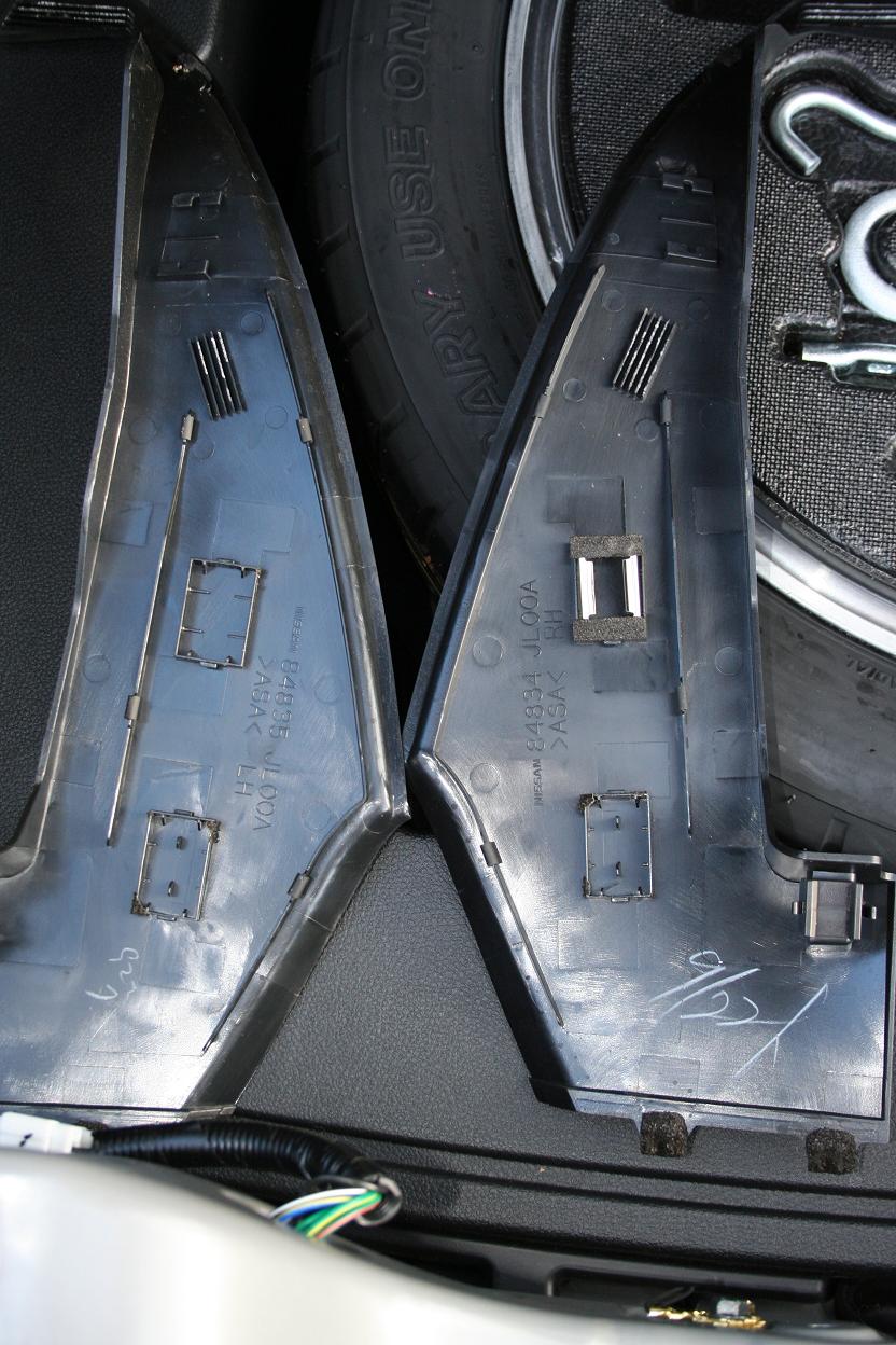

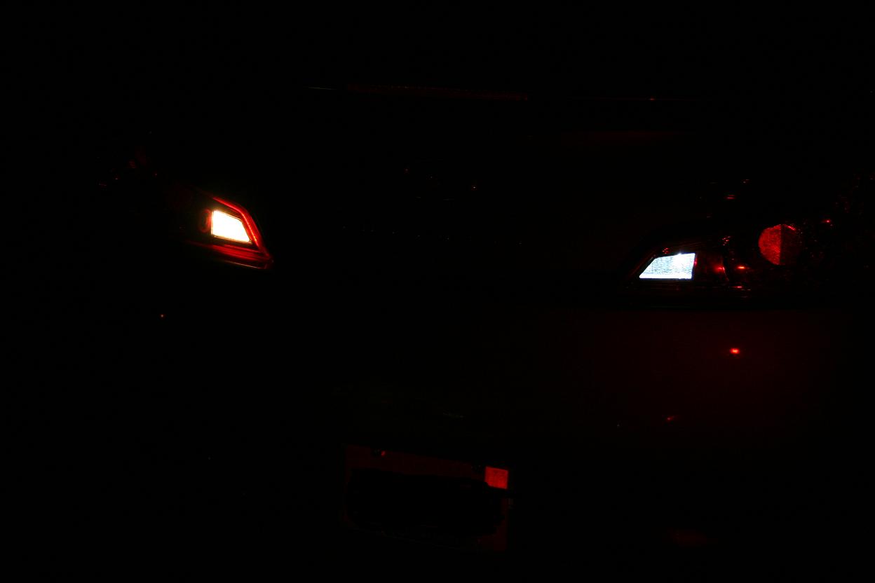

Guys, so I got the light off. Ended up taking off the top covers just to yank them out. Top covers are sticky taped (mostly), so it was pretty easy to take them off. I would recommend another possible solution. When you unscrew the nust that hold the light in place, try to get a small but strog wire behind the light, and then pull on the wire to yank it out. I used New 9 Led SMT Tower II 194 168 W5W 2825 from here: http://autolumination.com/194.htm as reverse bulbs. But I think it might be too dim. So I ordered 194 168 W5W 2825 SMT Tower III. I don't know if tower 3 will fit, but I'll see.

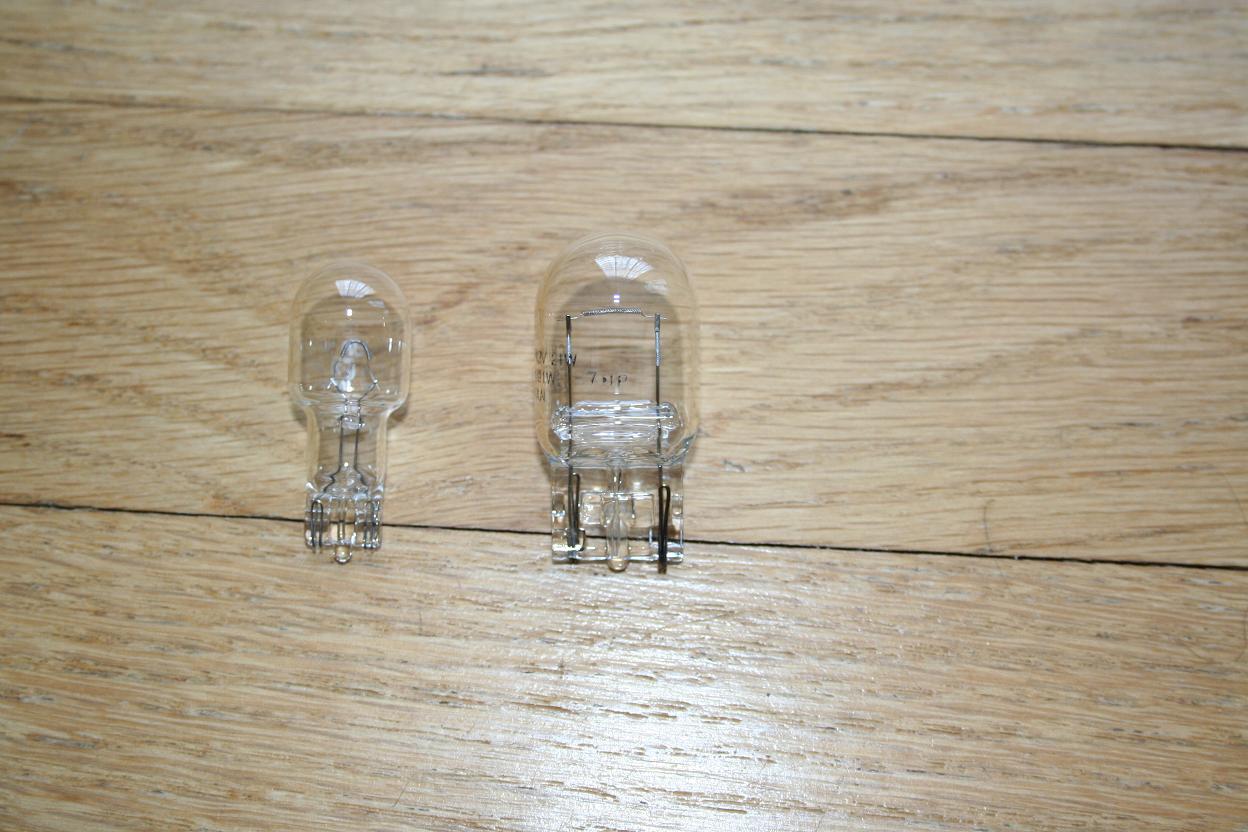

yeah. I'm still waiting for turn signals to come in from superbrightleds. Btw, on the pics, the fatter bulb is the turn signal.
Turn signal bulb markings: ICHIKOH 12V 21W 2DX W21W 7HP 7440
Reverse light bulb markings: TOSHIBA 921 12V W16W 21B A12V18W
