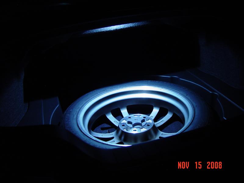

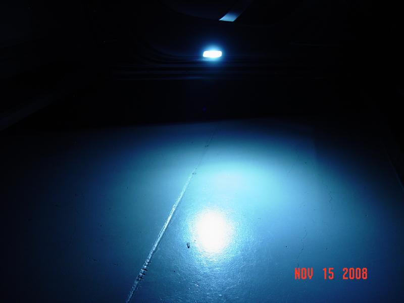

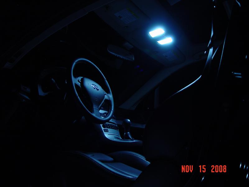

More Conservative Light Change
After trying several different bulbs and temps, I decided on a goal of matching everything inside and out as close as possible to the 4300K temp of the stock HID. Here are my LED change-outs.
Vanity: Vanity Mini 3 LED SMT Festoon, 31mm x 5mm diameter, Super White
Source: http://autolumination.com/festoon.htm
Map: WLED-NW5, Natural White @ 4500K, 220 degree pattern, 12 Lumens
Door: WLED-NW6, Natural White @ 4500K, 35 degree pattern, 12 Lumens
License: WLED-NW5, Natural White @ 4500K, 220 degree pattern, 12 Lumens
Trunk: WLED-WHP, Pure White @ 4500, 120 degree pattern, 20 Lumens
Source: http://www.superbrightleds.com/mini-wedge.html
Some Things to Consider:
1. Seems like a majority of people use the Cool White LED. For the WLED-5, it is 8000K and the WLED-6 is 9600K. I did not notice this when I made my first order. When I installed them it was too blue and too dim for me. So I put them in my son’s GTI and they matched well. When I put the Natural White in I liked it much better. It gets rid of the stock “yellow” lights and I can see much better. Maybe not as “cool” at the Cool White, but better choice for me. If you are not sure, then you may want to order a couple of samples and play with them first before ordering a whole set.
2. Think about the pattern of the light and the orientation of the bulb before deciding on the 5 or 6 LED for each location. I used 5 in the Map to give a glow. The 6 in the Map gave too much of a spotlight effect. Now in the door, I wanted more of the spotlight effect so used 6. In the license I wanted better dispersion so used 5.
3. Tried the Cool White 5 and 6 in the trunk before ordering the WHP. It is much brighter than either and lights up trunk much better especially since it is 4500K.
Pictures were requested in another post. So here is my best attempt. Taken in a garage with no other lights. Used tripod so I could play with exposure to get pictures as close to actual as possible. It was real hard to get the color in the photo to match the real life. However, the first one below named "accurate color" is real close. Hope that helps.
I really like how this came out......
