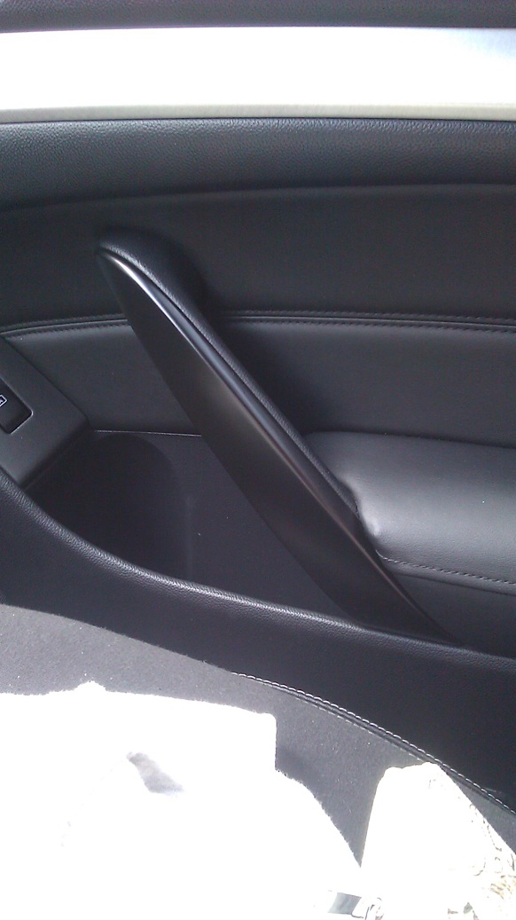

I repainted my door handle trim and now debating on repainting the brushed aluminum on top as well. I work at a cabinet finish shop so paint and spray guns are readily available. I sprayed mine with 2 coats of black primer, scuffing in between coats and and stripping the trim completely prior to the first one. To ensure longevity I hit it with some clear coat.
Wow, looks good. I thing that it would be easy to go overkill with this however. I quite like the look of just the door handle's painted.
That's kind of what I was thinking, going all black would be overkill. But your post confirms it, going to leave the the brushed aluminum trim alone. One other thing I will repaint though is the steering wheel trim where the stereo/cruise controls are...
