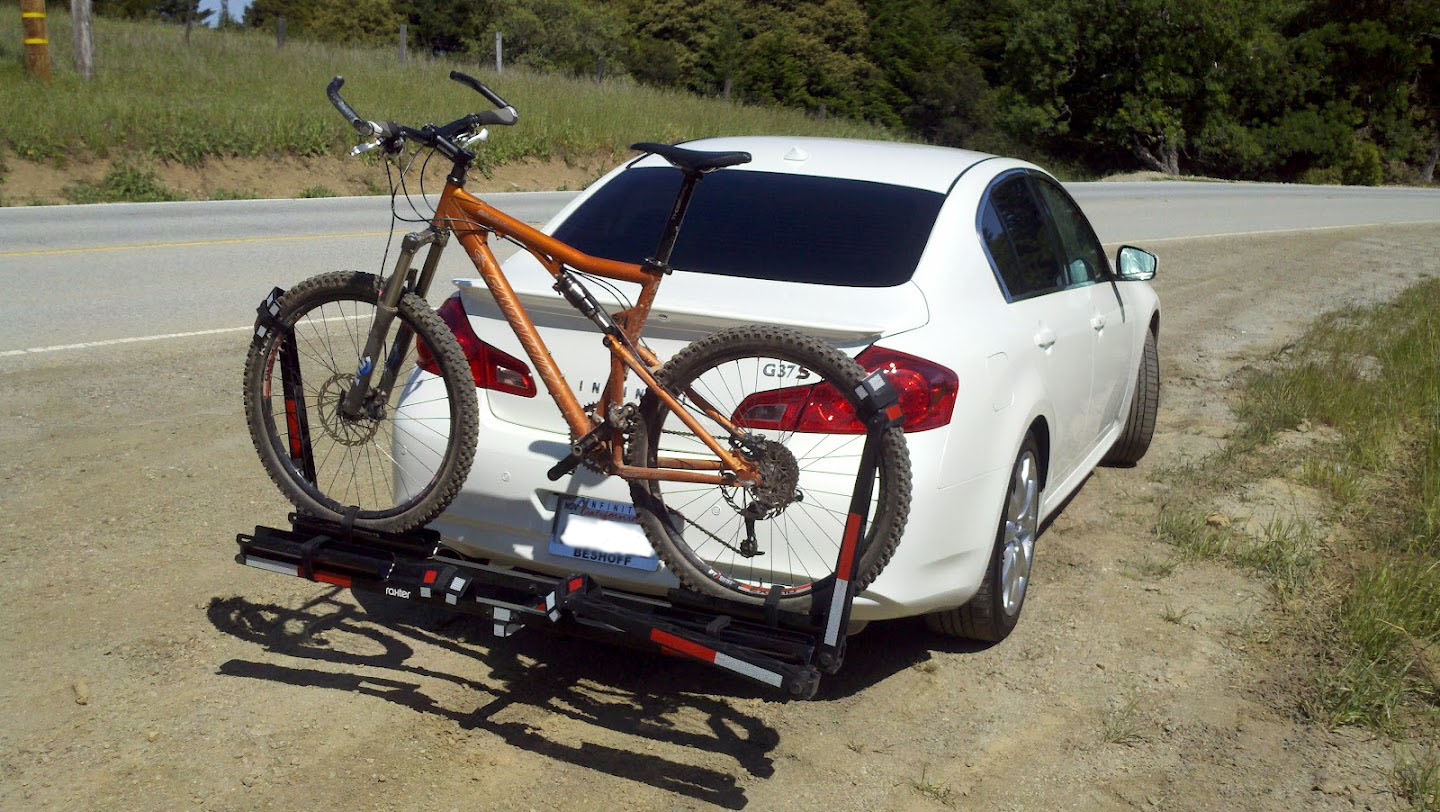

does it obstruct the camera view much? i guess that all depends on where the bike is secured...

I leave the sensors on because I backup a lot more without the bikes than with them and then I don't have to remember to turn them back on. The camera works great...it looks right through the bike frame.

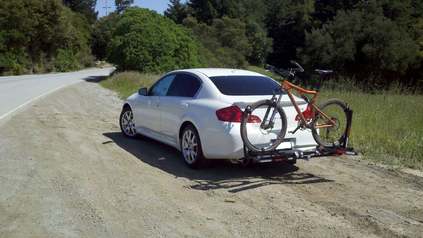

With my 05 Sedan I used to carry around up to 3 bikes on my rack. My sedan was totaled on Monday but here is a picture of the rack I had:
It was is/was a Raxter 3 Bike folding rack for 1 1/4" hitches. I had it on for a few years and it was durable and never gave me any problems. You can check out their site here:
Raxter Racks - Rack Your Bike
Now I am looking at the G37 Sedan and it looks like the hitch available is not going to be as strong as the g35 hitch which connected to the floor of the trunk also. Has anyone placed up to 3 bikes on their fold down rack yet?

From: Georgia
Added my hitch yesterday Model #11499. Straightforward, no drilling. Just a little fascia cutting, which was easy to do with tin snips. Used a dremel to weaken the aluminum spacer block and then pried it forward with a screwdriver and wiggled it back and forth a couple of times to break the rest of the weld. After that is is a simple bolt on with existing bolts and 1 carriage bolt to attach to the tow hook.
My 1upusa rack + 1 will be here Wednesday.
