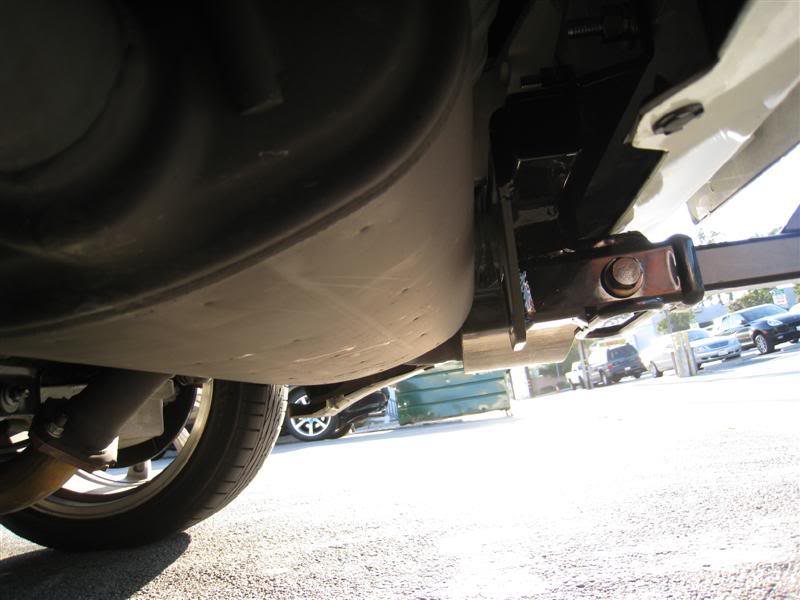

I'm mobile now guys! Excellent idea with the curtis hitch, took about 45 min, chopped off the arm of the hitch, dropped the muffler, took off the licsence plate, drilled the 4 holes with an angled drill, used 1/2in x 4in. grade 8 bolts, bolted the hitch up, put the muffler back up and called it a day.

Well, just wanted to resurrect this thread to thank "Infinite G37S" for all of the info. I mounted my hitch this weekend. I took a little different approach as I did not have an angle drill and didn't want to take the muffler entirely off. I did everything from the license plate side.
Made a cardboard template of the holes from the hitch mounting surface. Slid the template under the plastic licence plate bracket and center punched the bottom holes. Dremmeled notches out of the licence plate bracket to center punch and drill the top two holes. The license plate bracket is still very sturdy. Bolted the hitch on and was done.
If I had it to do over, I would have just bought new fasteners for the plastic license plate bracket and taken it off to do the job. The fasteners are permanent though, so I would have had to cut them off. Worked out fine though.
