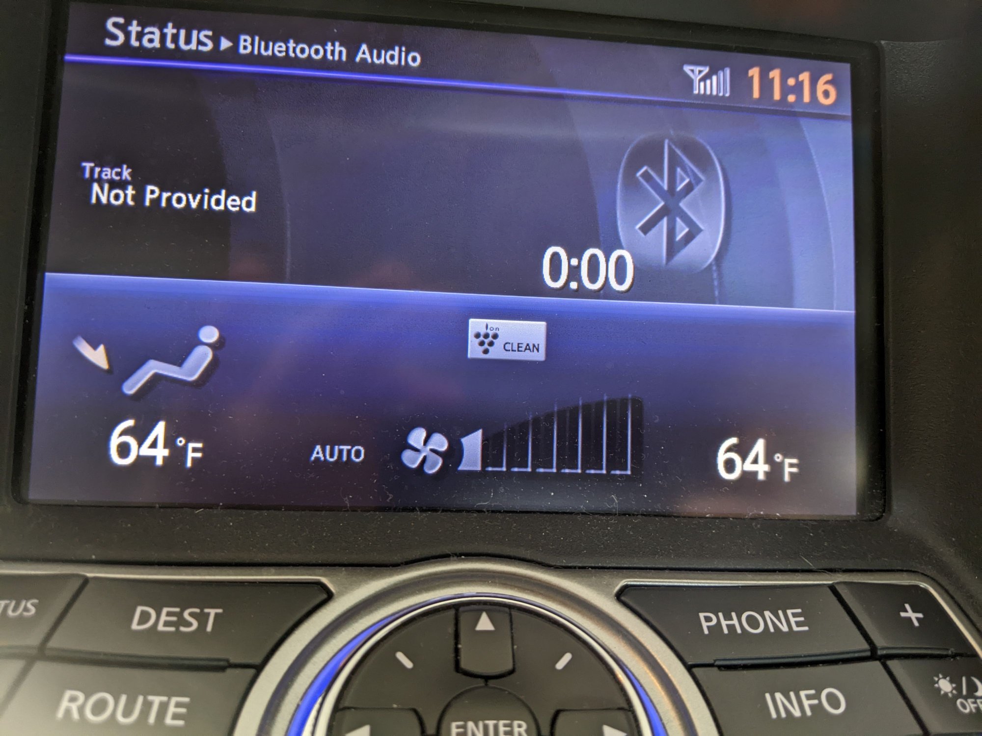

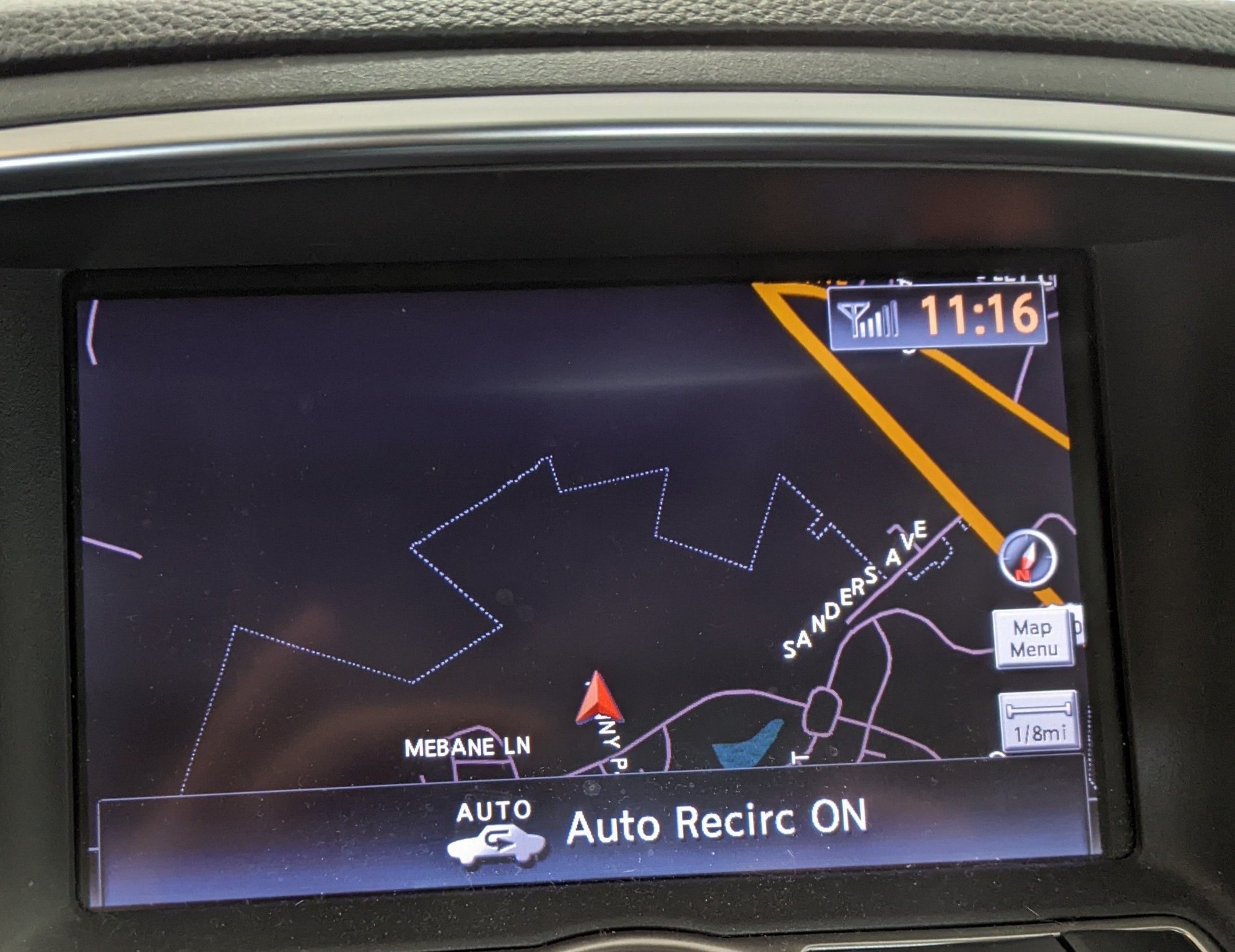

I am attaching pictures that I just took that are tied to the Tech Package AC system
"Auto" Recirculation Button engaged
"Auto Recirc ON" confirmed on Nav Screen when option is engaged
"Clean" logo within Nav screen, which is part of the Technology Package AC system.
\"Quick Clean" logo listed on Nav screen when the air flow is high
Difference between \"Quick Clean" and "Clean" on Nav screen for Tech Package Advanced AC System

I also added two additional photos to my original post, one is a different icon that comes up when the fan speed is on high for the Tech Package Advanced AC
