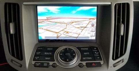

Ok, This may sound wacky but has anyone had their audio/navigation system load slowly. I have a 2012 g37XS and everything works perfectly. However, when I start the car. The Infinity start up process for the screen takes a long time. Until it loads the screen is black.
For example 5-7 minutes. So that means I am in the car driving down the road with no AC/Radio controls at all until that process happens. Could this be the screen or a specific Unit going bad? Bad Ground? Or Bad Connection?
I have a basically a stock Bose set up with a single amp and 10" sub.
Any help would be appreciated.
Not my screen just using as an example:
