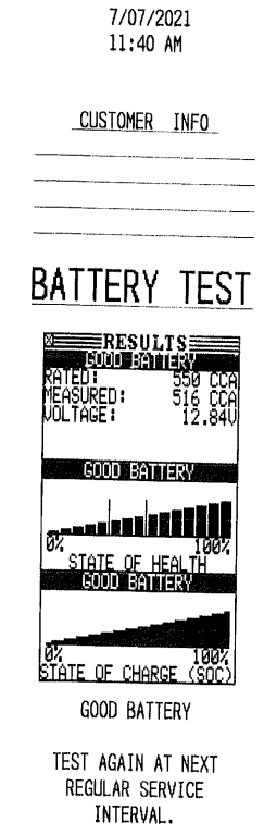

Back in late 2015 I replaced the original battery in the G as part of preventive maintenance. Car still started (albeit cranked slightly slower in the winter). Since then the battery has been used in the garage (unheated) periodically as a 12V source. I keep it on a battery tender when not in use.
Given the battery is almost a decade old I brought it a local shop to get tested.
Surprisingly it's still good. No G anymore to test for cranking, but it did fire up the accord just fine.
This was the key to your battery's long life.
