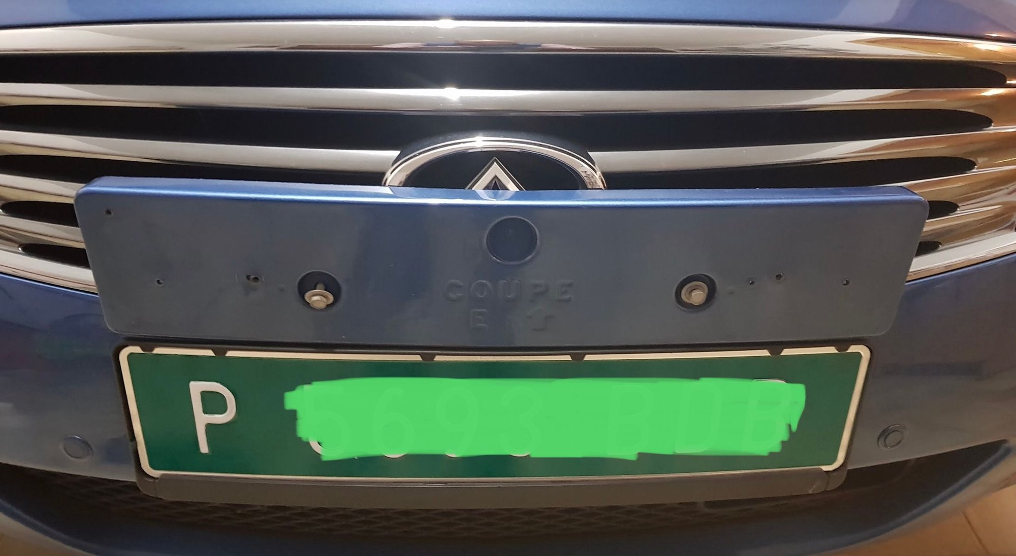

Update: not solved, but nearly. After reading some comments about bent license plates, I decided to remove a part that sits between the plate holder and the bumper. It is just a piece of plastic, screwed to the bumper and painted its color, that holds the plate about 20 mm away from the bumper and allows it being completely flat. I removed it and screwed the plastic plate holder directly to the bumper. Now the sensors buzz now and then. I still need to test drive it, so far just a static test in my garage. Weird, because that part must have been there since new...
on the other hand, I think I could reach the sensors from underneath, just removing the under tray. I will try to do so this weekend if needed

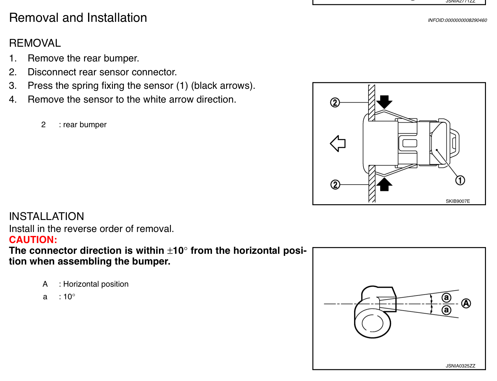

Nice idea. Would be great if that helped! Here are a couple more details from '13 US sedan FSM (rear bumper, but I think the front and rear sensors are the same).
I believe the center sensors are 25994PA (plus numbers following the dash indicating color) and the corners are 25994P. Could be tricky to find your color match but this may be one:
https://www.ebay.com/itm/NEW-OEM-Gen...4AAOSwQ61bZiCf
If you are lucky enough to be able to reach them from below, first make sure they're not turned - as the pic below shows. And beyond that, I wonder what would happen if you found the offending sensor and left it unplugged?
