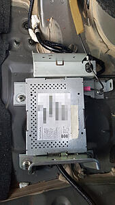

Cleaning my trunk out and checking to see if i could mount my amp where the spare tire is, I noticed an xm receiver.. Ive pushed every button on the head unit but nothing is showing xm radio anything. Any suggestions?

yeah i've pushed it a million times.. theres only one wire from what I can feel plugged into the receiver unit in the trunk.. I'm assuming it's the antenna, and reading some other threads it might just be unplugged and the harness tucked away. I'll let you guys know, when I check tommorow.

Check the wiring harnesses, there should be two if I remember right. Plus, you can access the diagnostic menu on the headunit to see if they're connected or if there is a problem in the CANBUS.

Well I do have xm in my base, for some reason it was never cut away from the wireloom that it was taped to. This is odd that when they sold the car originally they never hooked it up for the first owner... I'm happy.

Plug the connectors in (the SAT module has 2 (the little pink one is the SAT antenna on the roof) the TEL module has 3), turn the car on and press the AM/FM button to cycle to SAT radio. If it comes on you can call XM (or go online) to get the free 90 day trial subscription. The novelty will likely wear off before then once you experience the poor audio quality, spotty reception, and overly repetitive programming but then again you might be one who actually enjoys the option.
