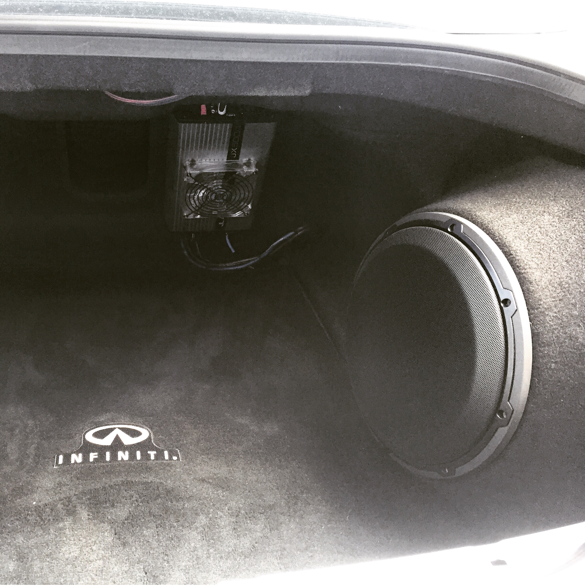

I have this exact setup in my G. Sounds great in my car.
Attached Thumbnails Thinking of a new subwoofer/amp combo-photo839.jpg
