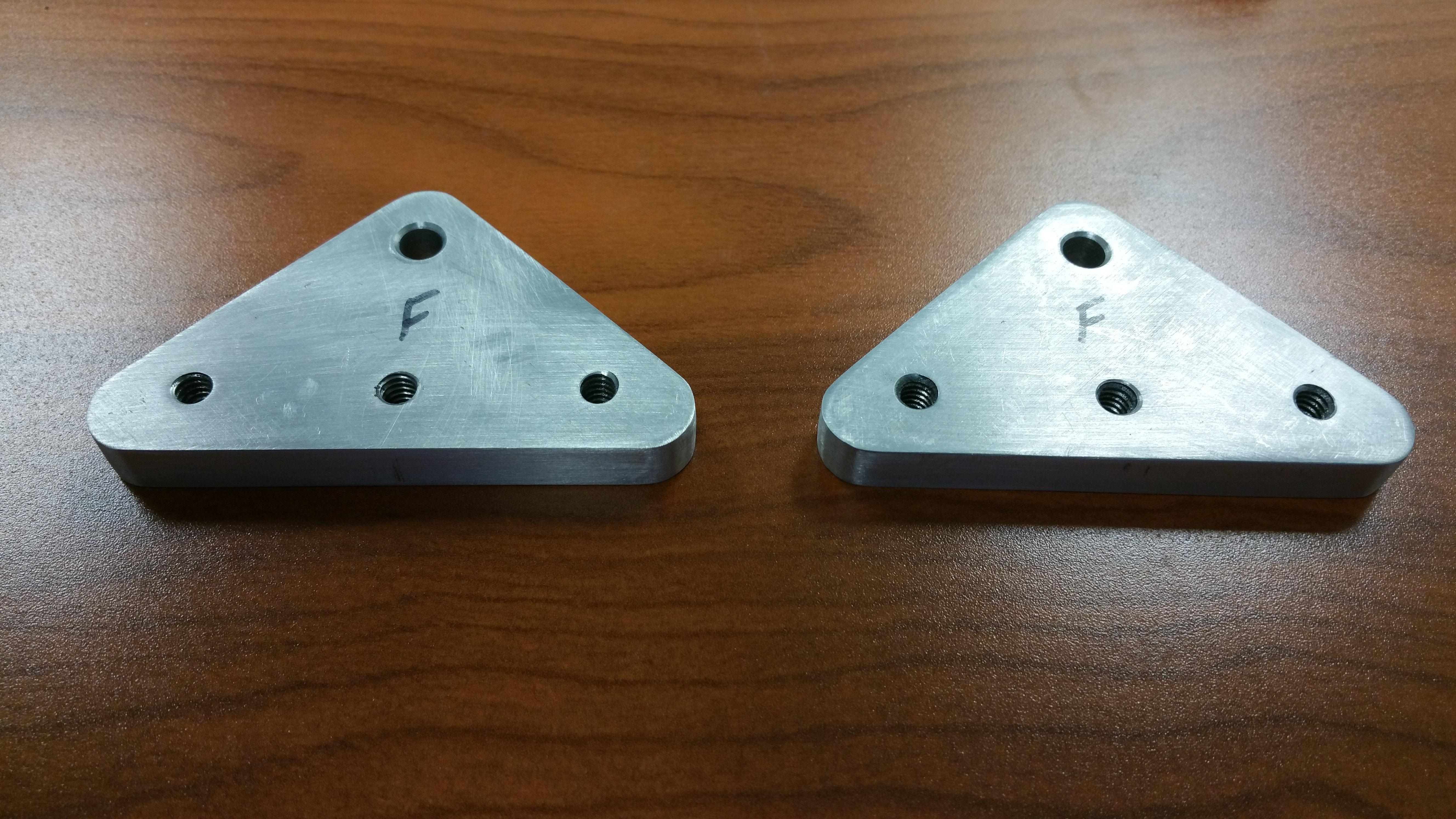

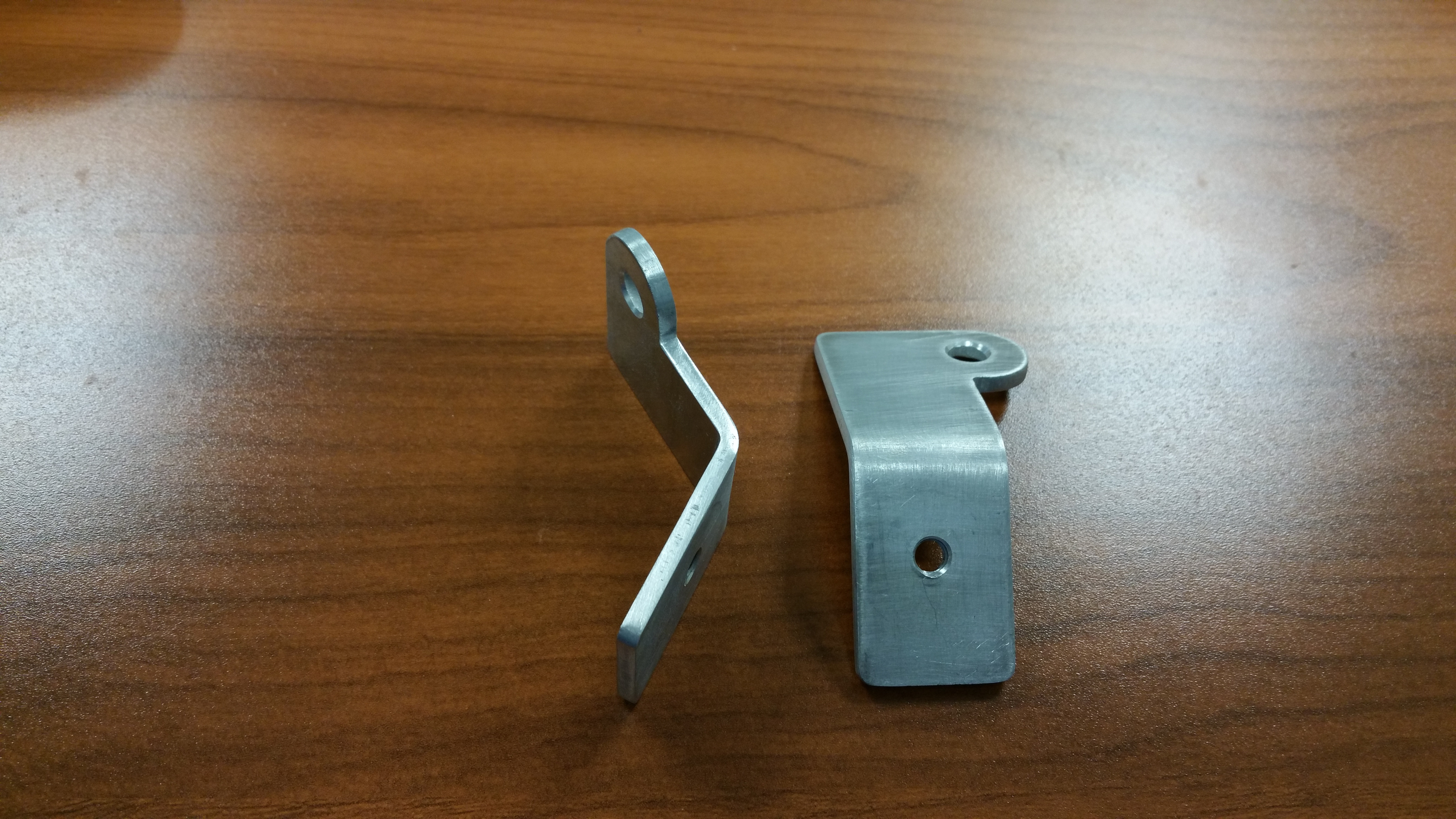

So I decided to make my own grounding kit. Instead of stringing the wires serially, I decided to make some custom aluminum grounding blocks. Since I have a Stillen cold air intake, I thought I would make use of the empty bracket space in the fender where the stock airboxes were. Luckily, my work has a machine shop with a waterjet. I designed the blocks with AutoCAD and had them cut on the waterjet, then cleaned up and tapped for 1/4x20.

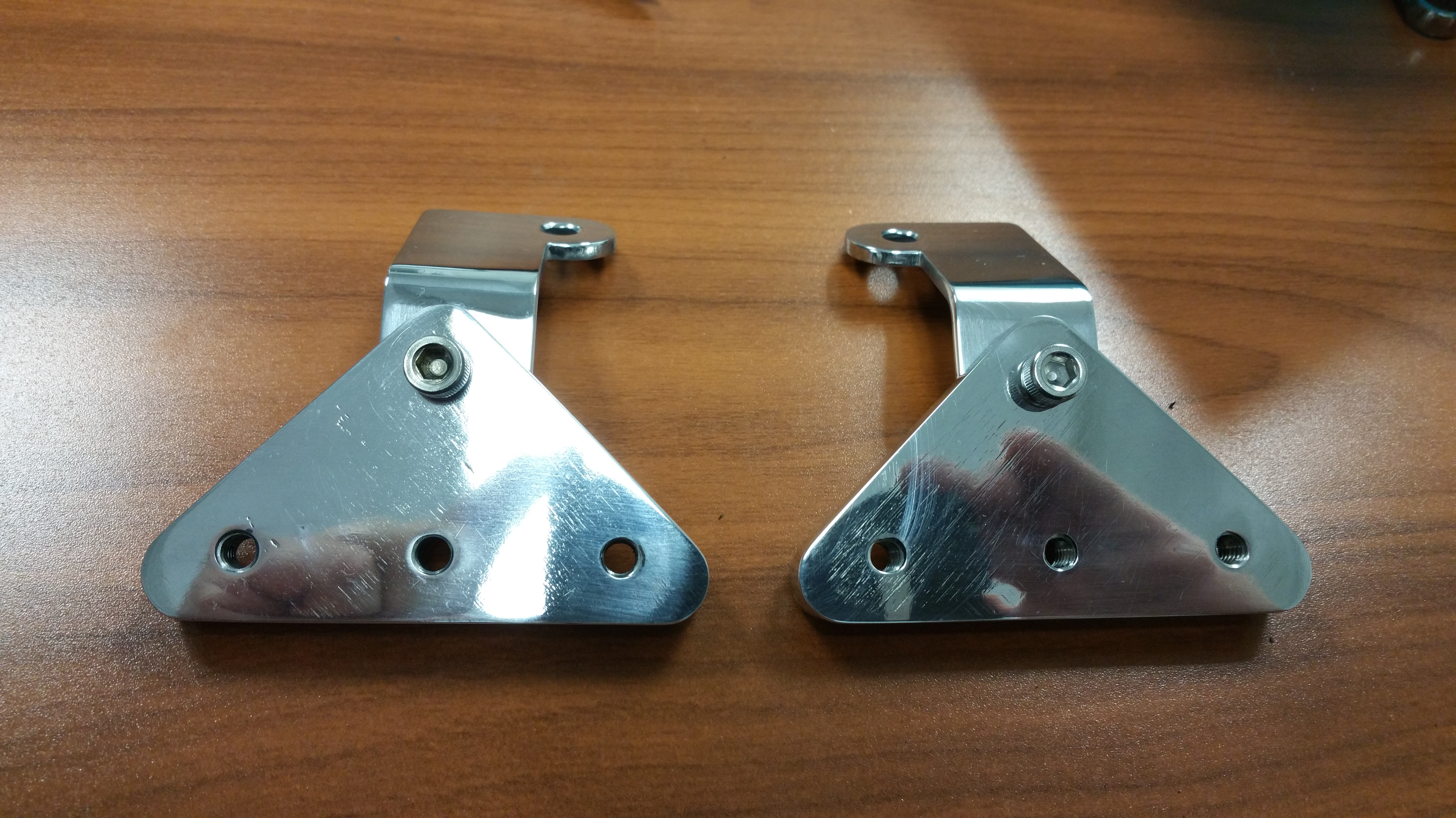

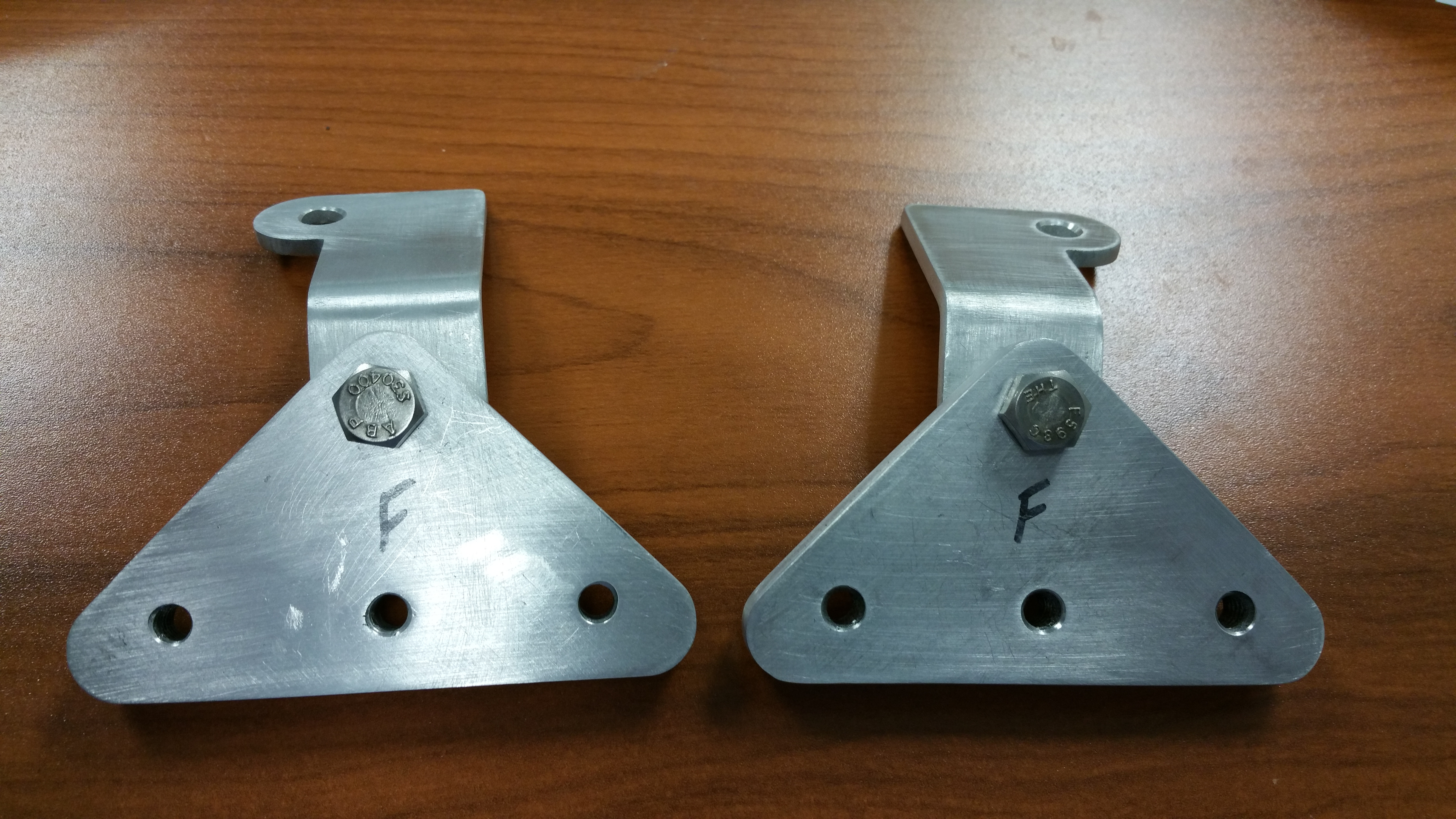

Here are the brackets. Bent at about the same angle as the airbox brackets. Cut from 1/8" aluminum. Through hole for the 10mm bolt (gonna probably end up using VMS fender washers) to the fender and 1/4x20 threads for the block.
Here are the grounding blocks. Made from 3/8" aluminum. The top has a clearance hole to mount to the bracket. The bottom 3 are 1/4x20 to mount the 8awg grounding cables. Passenger: 1x to the battery, 1x to the wheel well, 1x to the engine. Driver: 1x to the engine, 1x to the wheel well, 1x open (haven't decided what to use that for yet).

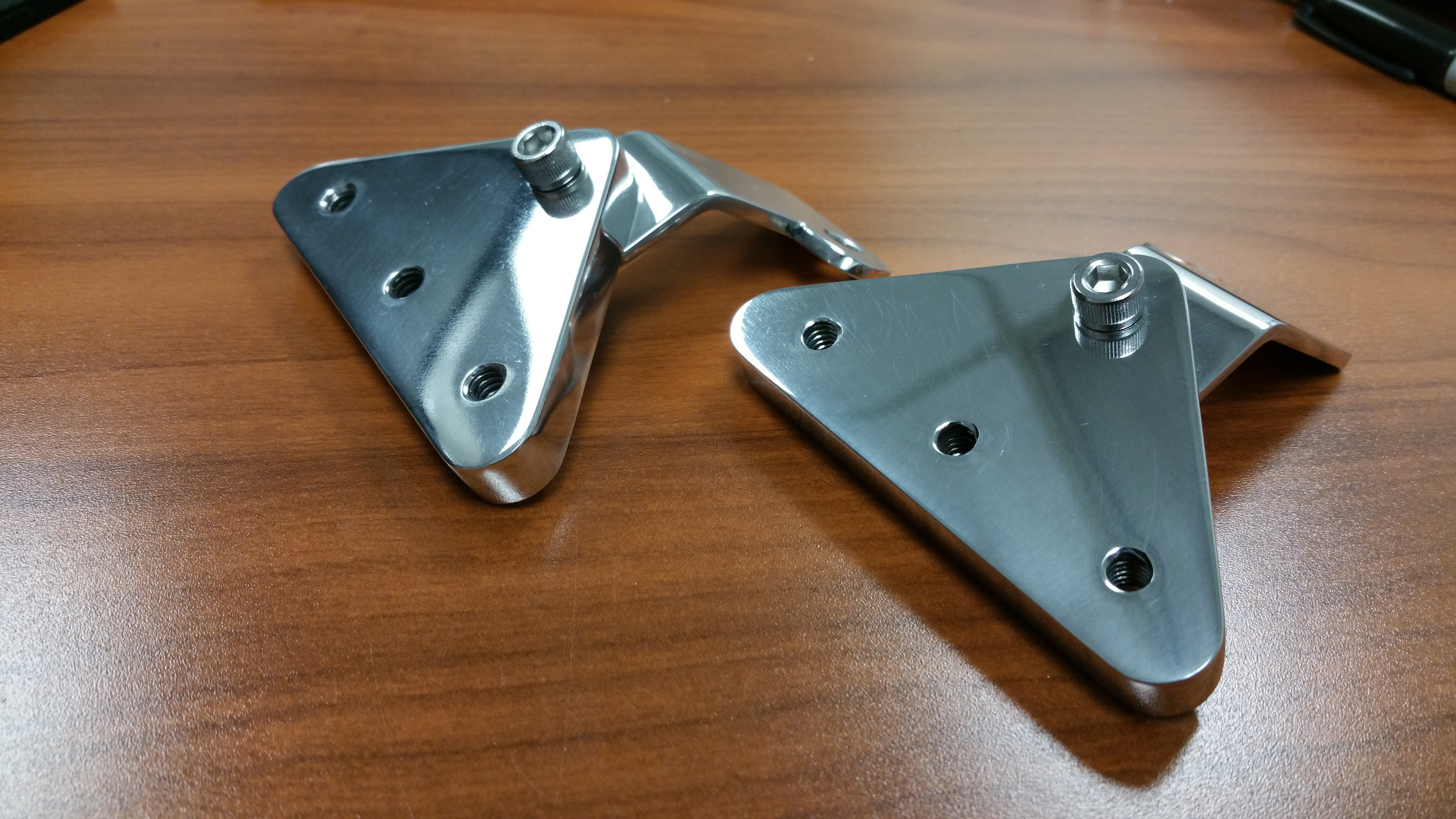

Here they are connected. The next step is to clean them up, hit them with a couple of coats of etching primer, 2 to 3 coats of black, and then a couple of coats of clear.

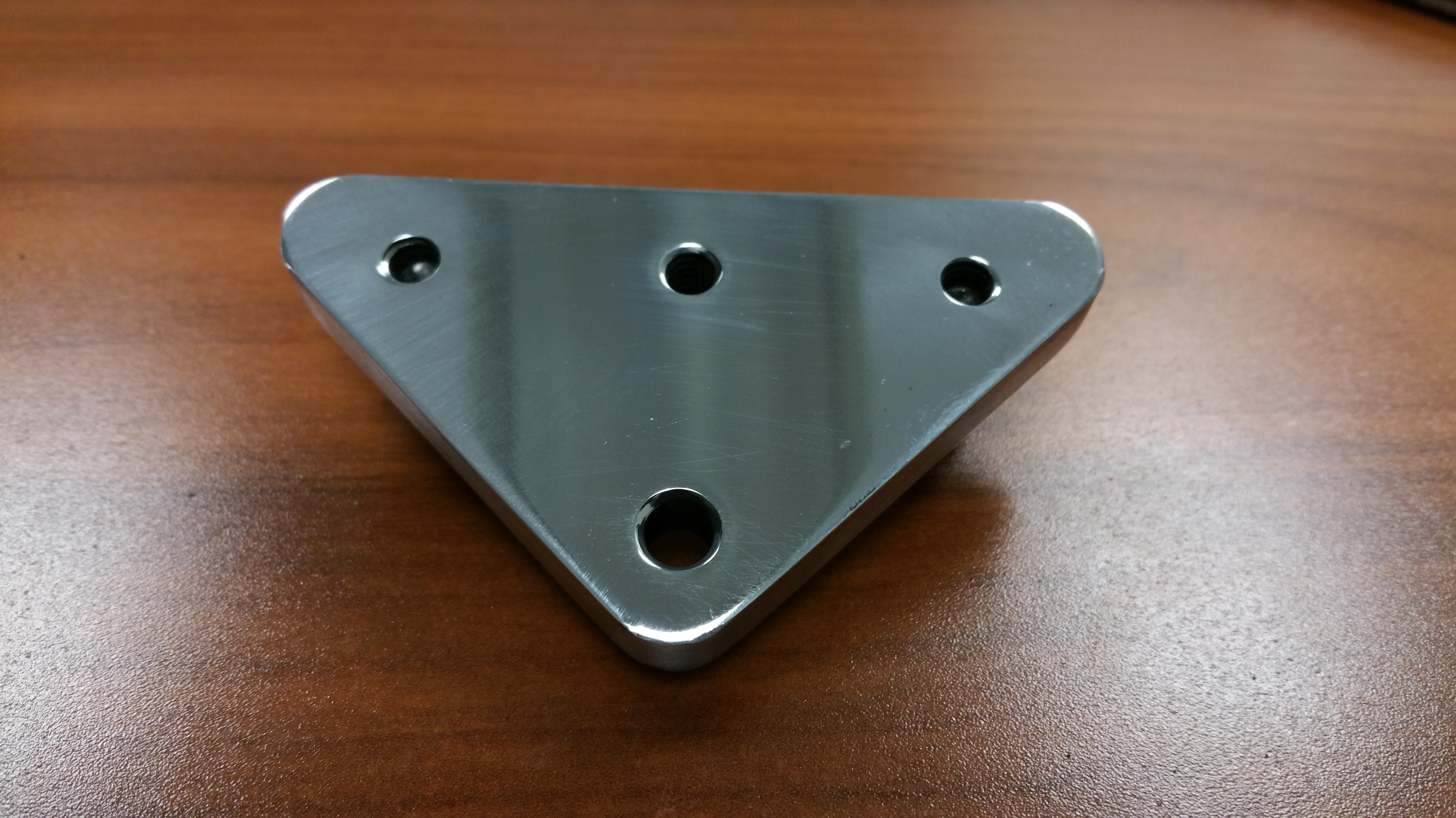

This is about as good as I'm gonna get it with the buffing wheel here. I think it hasn't been used for quite some time. Even raking the wheel didn't help a lot. Looks better though. The scratches are gone and it can stand a little cleaning up. But its good to go.
