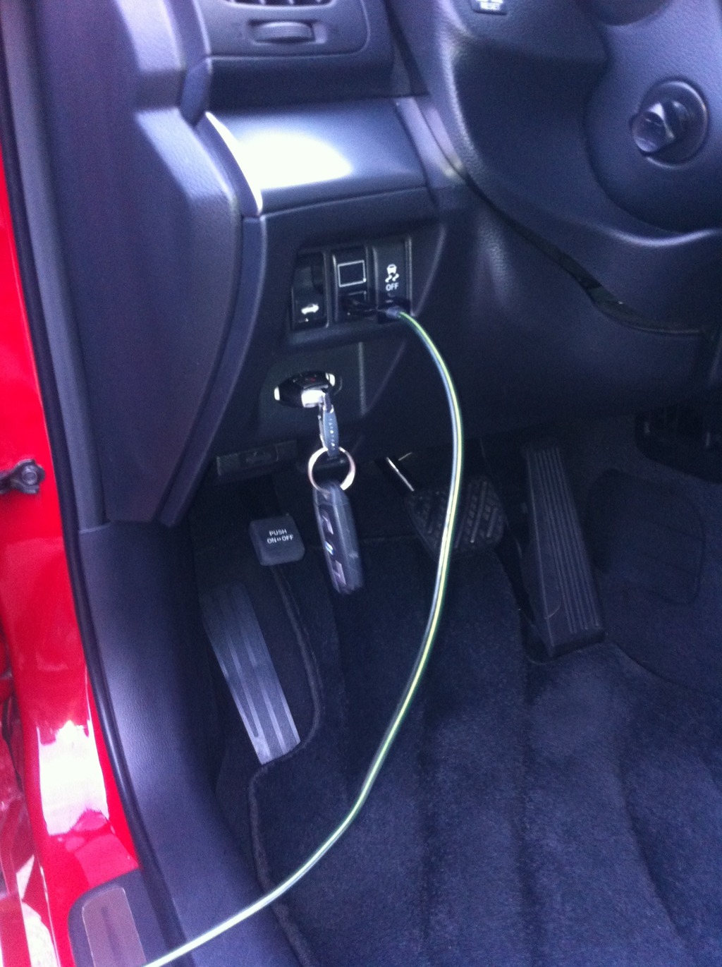

Wife had mentioned anytime the console USB port was used to charge a passengers phone that the car wanted establish bluetooth paring or whatever. So I thought I'd add a dedicated USB charge port. She keeps her phone in the drivers door pocket while driving so left side of the dash made sense. Ran across this novel Nissan switch blank solution. Moved the power trunk release over to the far left, installed this in the middle, placed the traction control far right, and relocated the never-used sonar silencer button down a few inches to the switch blank next to the hood release. Its still in reach if ever needed. There was plenty of slack in the factory harnesses to support this so no wiring was messed with.

@Gawd, relocated to where? Pics?
When you did your bench testing, was the volt/current output stable or fluctuate significantly? What did you use as your load?
If I had to guess, I'd say he put it here
To the OP:
Why did you move the switches around the way you did, especially the trunk release? Is it cable operated our electrical? Did the cord not reach the far right position by chance?
I would have left the trunk release alone, relocated the sonar, moved the traction control where your did, and put the usb port in the far left. Just curious why you chose that arrangement.
To the OP:

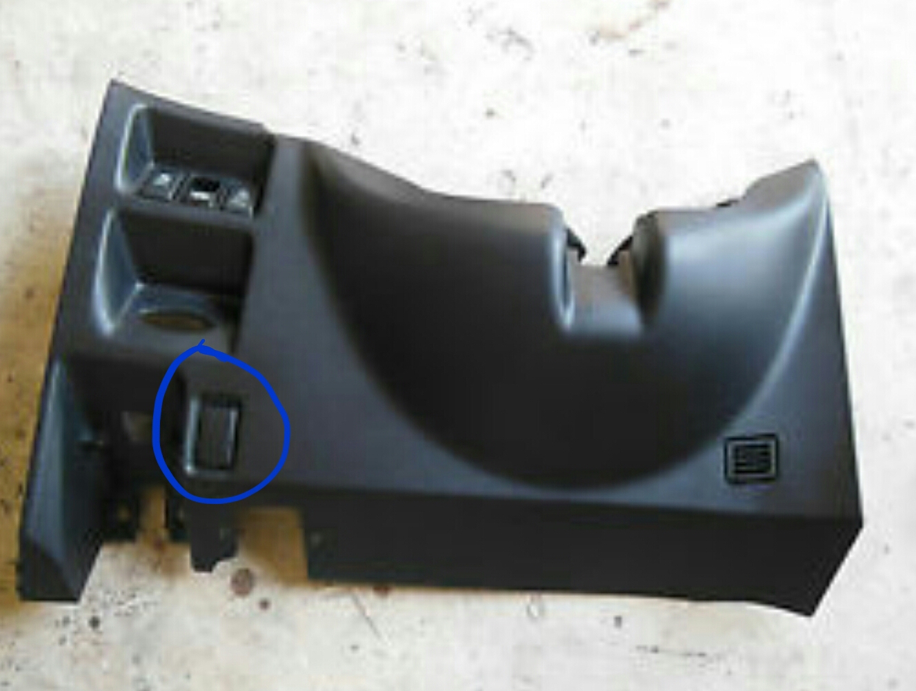

Correct, the rear sonar silencer button was moved down next to the hood release cable. ALL G's have a blank switch insert there, I think Infiniti planned to have lane departure switches at some point. This is where the M or SUV have their lane departure switches.
The trunk release is 100% electrical, the harness can reach 6-8 inches either way. The arrangement: I think this is a case of 6 of one, half dozen of the other. Not sure there is a right or wrong place for any of these (seldom used) switches. For visibility while sitting upright in the drivers seat, having the USB thing in the center seemed most logical.

Thanks for the clarification. It's been a few weeks since I've been in my car. I rarely operate the buttons there so didn't recall what was or wasn't there. Did you have to remove the entire panel to pop them out, or they're removable from the outside?

You do need to pop the panel out i believe, its just a few screws holding it in. Then unscrew the hood latch and OBD port, unplug the plugs and u can have at it .

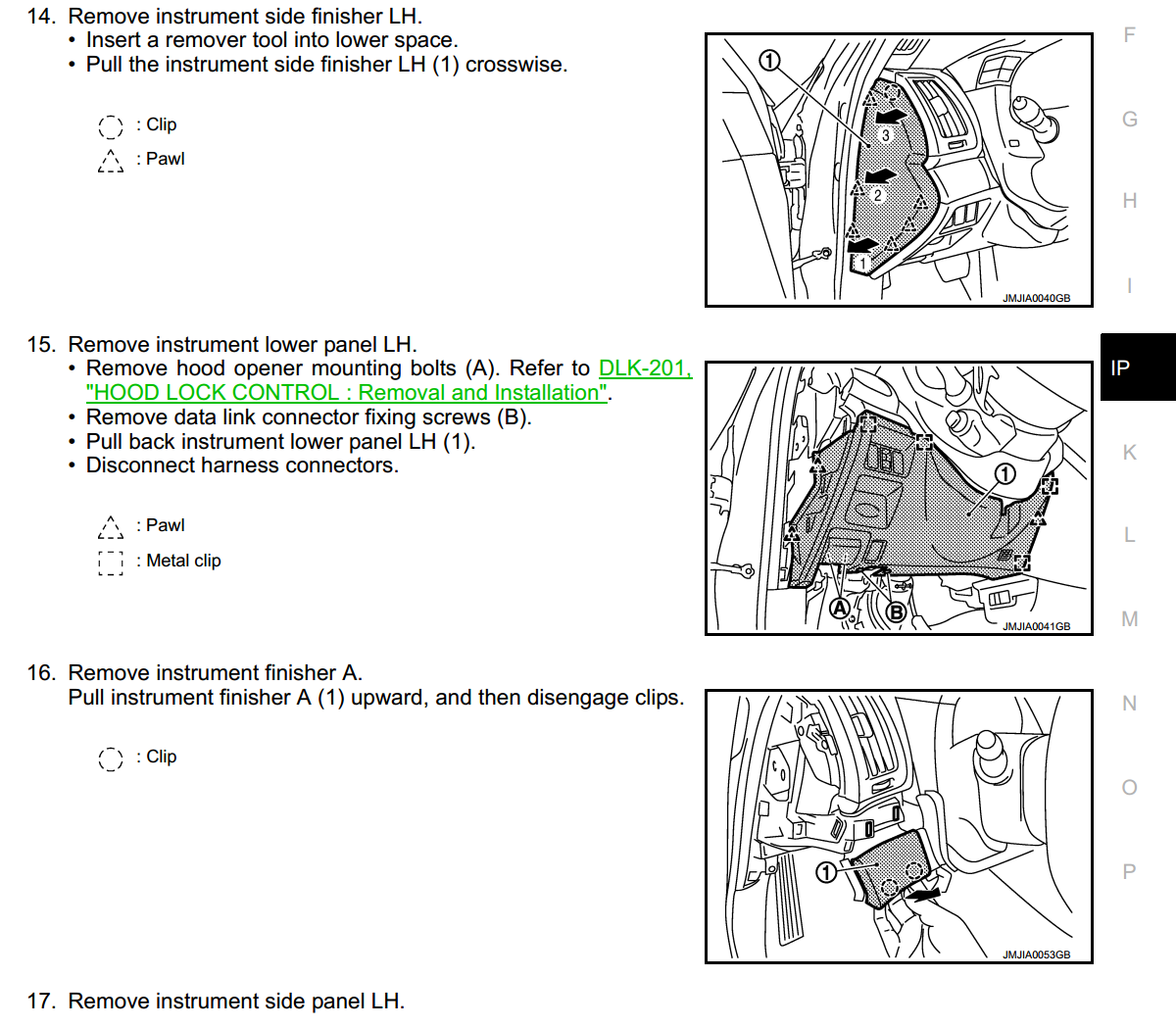

@Gawd,
Did you have to do step #14 to get main panel out? What you use as a removal tool?
Your hands
