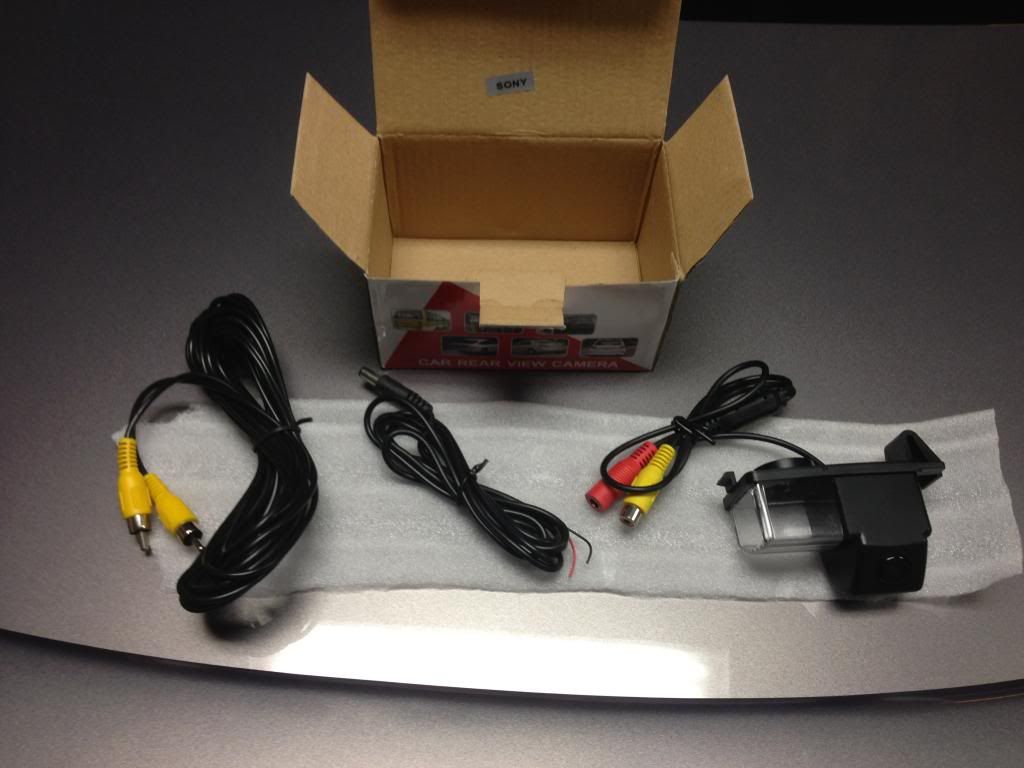

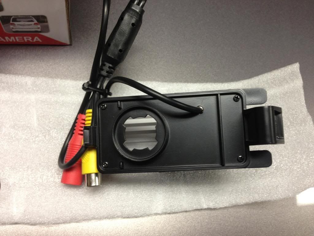

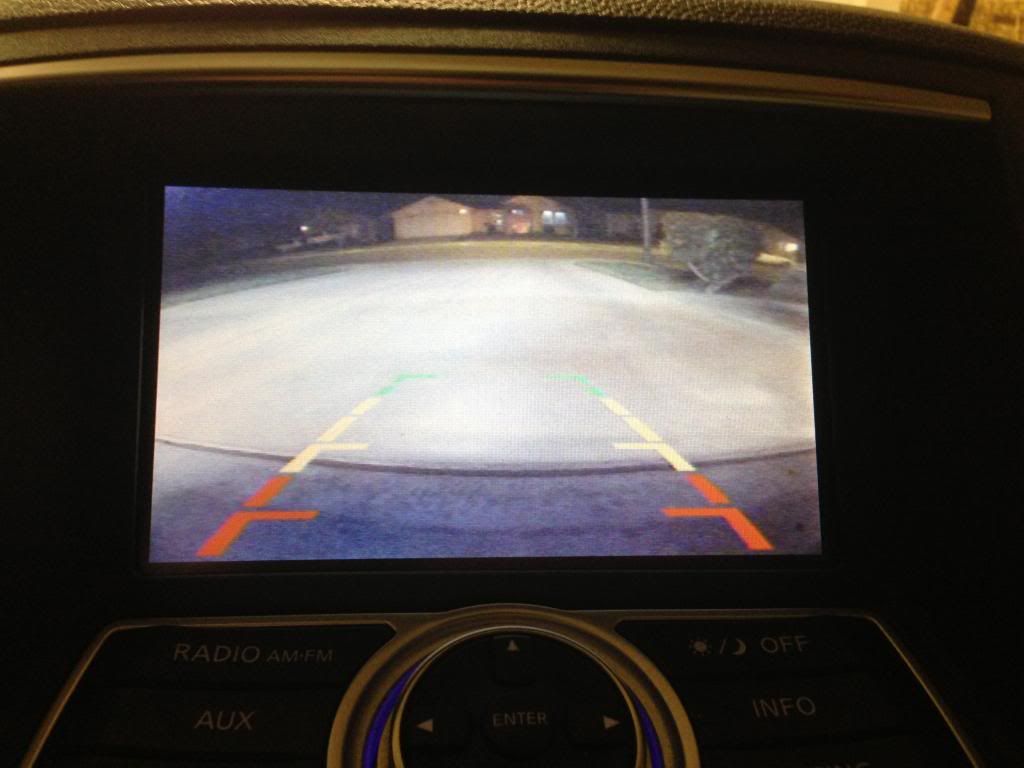

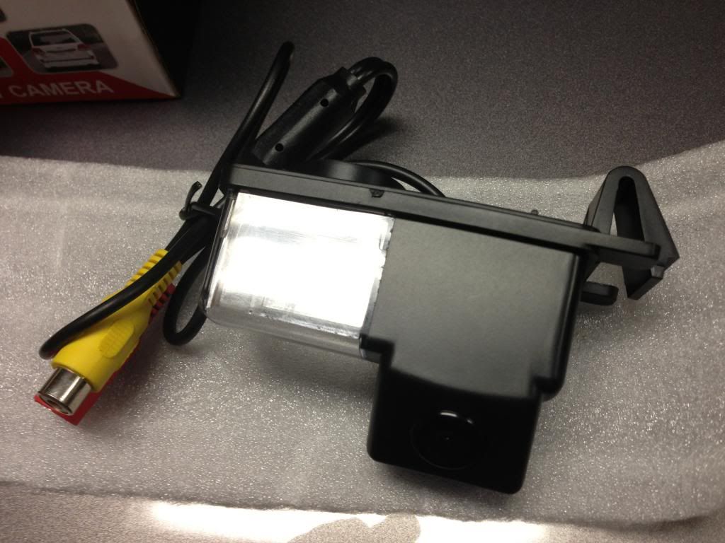

I've been contemplating on adding a backup camera ever since I tinted my rear windows limo black (two years ago, lol). The OEM route seemed too costly, so, I purchased an aftermarket "sony" camera on Amazon for $20 shipped. It replaces one of the two license plate lights and fits perfectly and tightly. Install was straight forward. I'd say 1-3/10 depending on your research, knowledge on electronic installs and removing interior car panels. Google helped as usual. For anyone interested the reverse light wire I tapped into, at least on my 2008 coupe, is black with a white stripe.

Did you connect this camera to the video input inside the console or is there a factory input on models that didn't not have reverse camera OEM?
Old Jan 21, 2014 | 10:53 PM
daicon0's Avatar
daicon0
Banned
Joined: Jun 2011
Posts: 91
Yes, I connected it to the yellow video RCA jack inside the center console. Based on what I've read around, if your car didn't come with a camera then you don't have the necessary hardware for a plug and play into oem inputs/plugs. Did that make sense?
