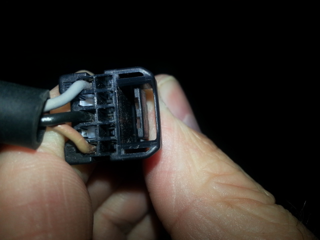

I wonder if our plug is the same? Mine is so tight. Even putting a small finishing nail doesn't see like it would work but I am still gonna try. See picture. Also did you tap the gold or silver wire?

I just gave it a shot with the smallest nail I could find and as I expected I can barely get the nail into the plug. Its just too tight!

I don't know how small your nail is, but mine was very tight too. You are using the nail to create more room in there, so it should be very tight. I used a finishing nail, like th small nails used for paneling or baseboards.

Does my plug look just like yours?

I used a sewing needle with a pair of pliers to make room inside that plug.
As stated above, they are very tight. Ad ya....your plug is just like mine

Yes, thats it.

Thanks for all the feedback! I am going to give it a try again. Which colored wire did you all tap if your plug looks the same as mine?

I believe brow is the switched power, black is ground, and grey is steady power. I went off brown i think.
Been a while, can't remember.
