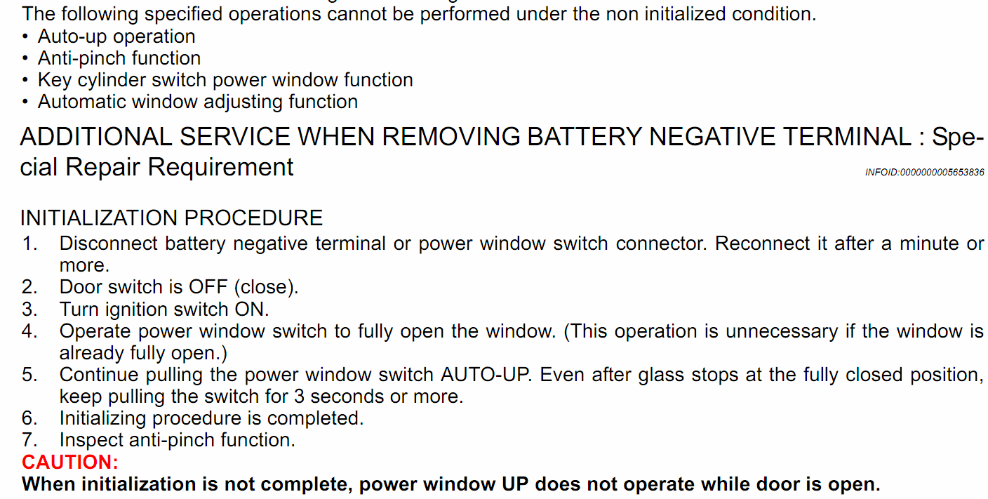

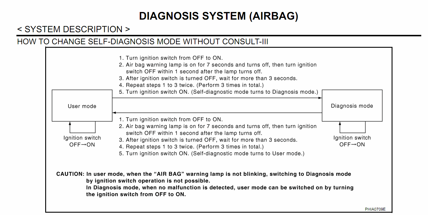

Fyi regarding Power Window and SRS Blink Reset
*** THIS INFO IS A STRAIGHT SCREENSHOT FROM THE FSM ***
********* PERFORM THE SRS RESET AT YOUR RISK *********
Link to FSMs: Index of /FSM
Big Thanks to NicoClub!
Make sure all doors are closed as if you were driving the vehicle.
{Power Window Initialization Procedure. Specifically Auto-Up Won't Work}

{SRS Warning Light Flashing Repeatedly}
Attachment 86755
