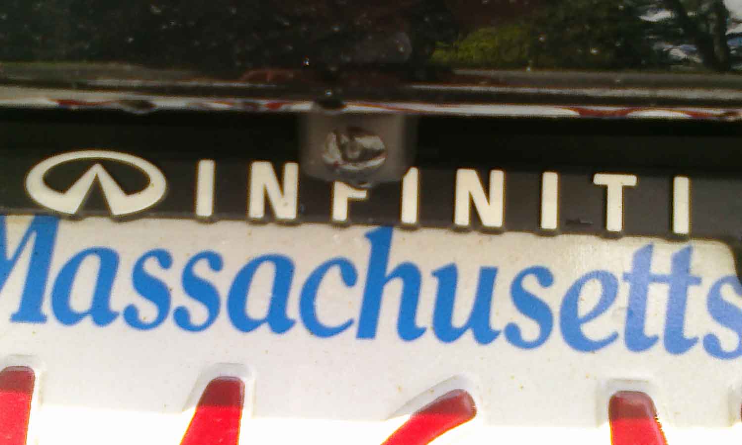

Thanks, the camera is mounted above the license plate. I'll post a picture of that also. Actually, I have to say that the screen looked good from the start. I just adjust the left/right location on the screen and also the touch screen calibration.

Here is the picture of the backup cam.

Do you know where you plan on installing the camera? I hear it's difficult to judge the distance to objects with the license plate cams because you can't see the bumper for refeerence. You should consider installing the camera in a higher position near the trunk release, which is similar to the factory setup. Only problem is it requires drilling. Looking forward to seeing the finished product. Wish it was cheaper.
Don't install car backup camera on the bumper if it's for parking.
It should be looking down on the bumper - usually up in around the boot handle/numberplate lights.
If you have it looking out from the bumper you have no perception of depth.
If it's installed where I mentioned above, it should not be seen. That's where most factory fit cameras go. It will still require some drilling, but just not in as cosmetically sensitive area.
