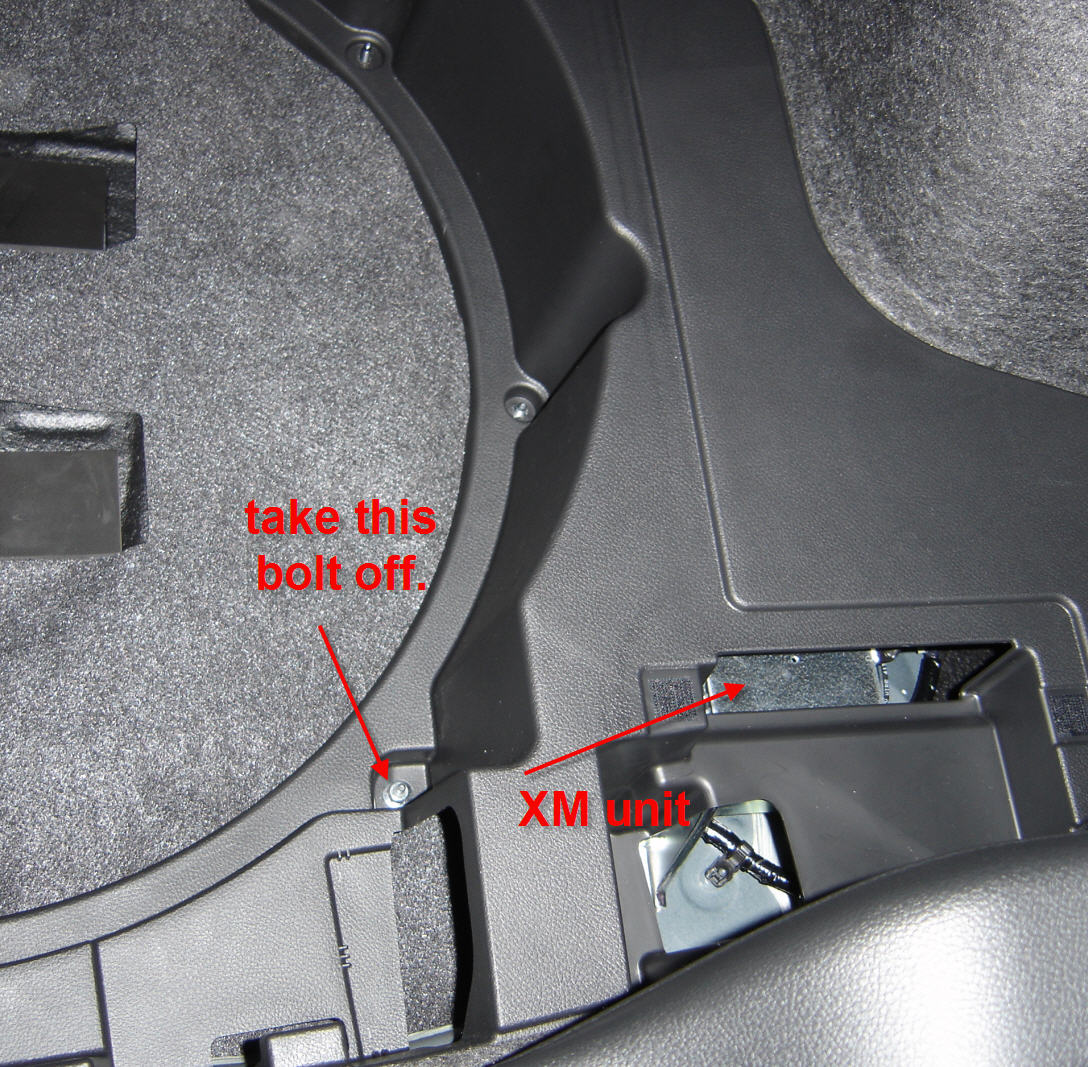

I have a 2008 G37S without NAV. All you have to do is get the Sirius tuner and replace the XM with it and your good to go, its that easy!!!!
I got my from Grubbs which is advertised on here:
http://www.grubbsperformance.com/servlet/Detail?no=2905
Kit comes with more than you need! Sticky tape pads, etc etc,,,but no antenna (i'll get to that later)

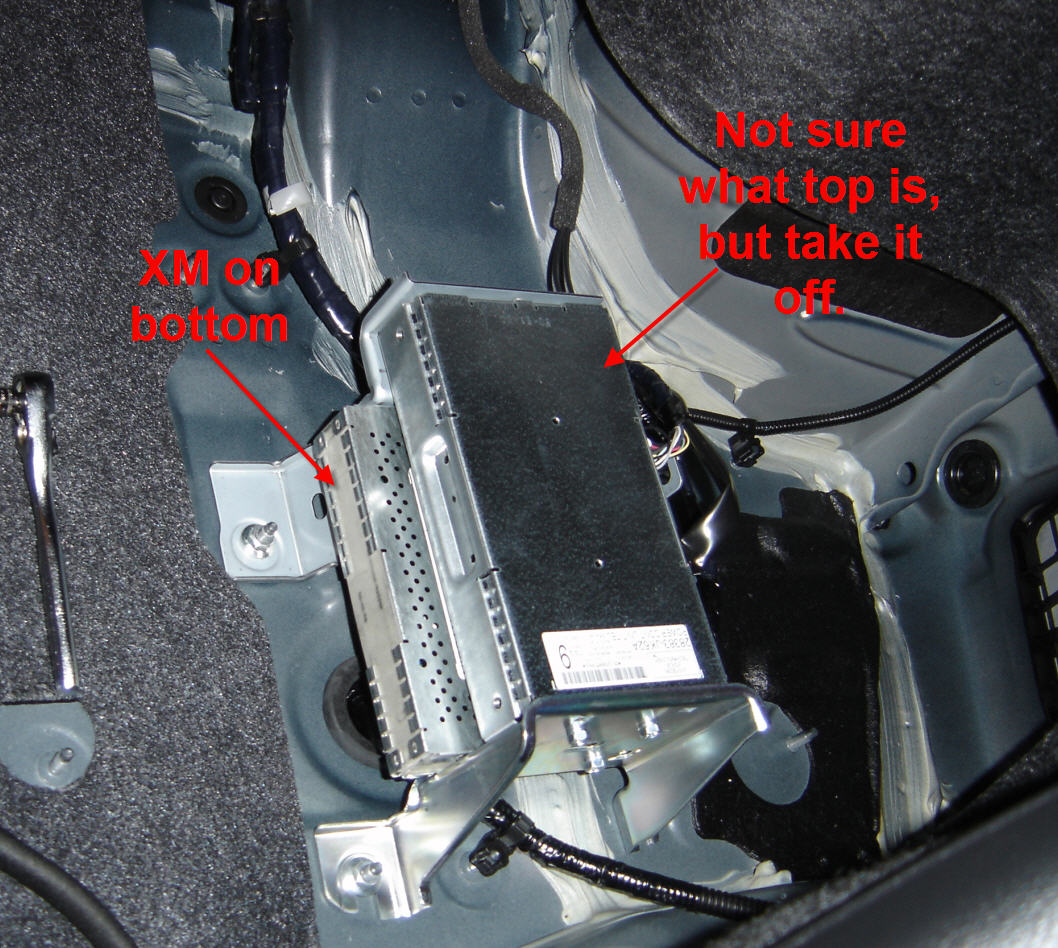

All you have to do is take out the trunk mat, the spare tire. From this point it is easiest to take out the black plastic molding that is towards the front of the tire well area(where back seat meets trunk), the part that is held down by 4-5 black round clips, these clips also hold the carpet, some of them anyways. Once they are out, pull that piece directly towards the back of the car, there are two white clips holding that in place, they will pop when you pull. Then remove the black right side plastic in the trunk area by pulling towards the left side working it free. (OH you need to take the one nut out as seen in my pics attached, and there are two spikes sticking up to work around.).
Once that is done, its easy! Just take off that top box, and the XM is under it, you also DO NOT NEED AN ANTENNA FROM SIRIUS. Do NOT BUY ONE, you don't need it! (i did based on folks recomendations on here)
Since the plug for the antenna(pink) for XM doesn't fit into the size of the pastic clip on the Sirius, just cut apart the pink plastic housing(on plug for antenna comming from car), if you look at the XM and Sirius tuner the only thing different is the housing, the inside connector is the same. IT WORKS! so no extra antenna needed for Sirius!
Simply plug it all in and put all pieces back, and wallah, you have Sirius fully integrated!!!

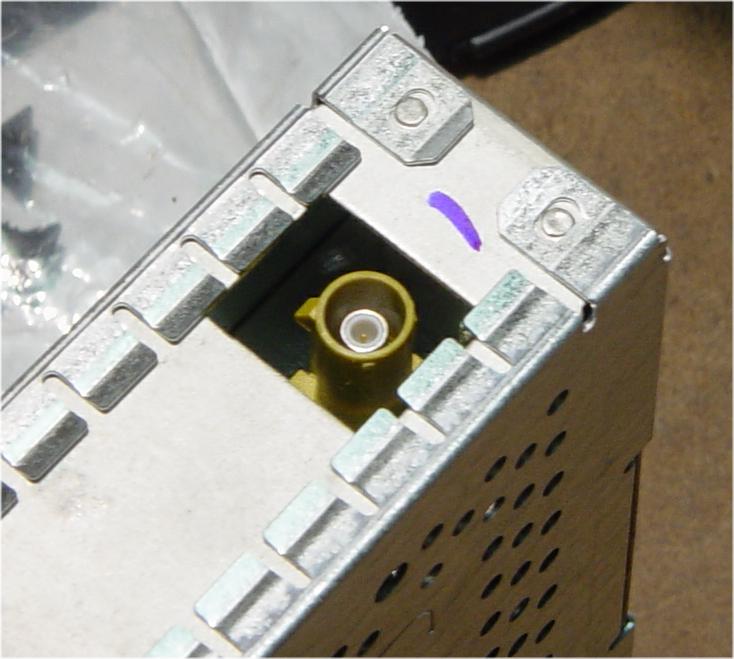

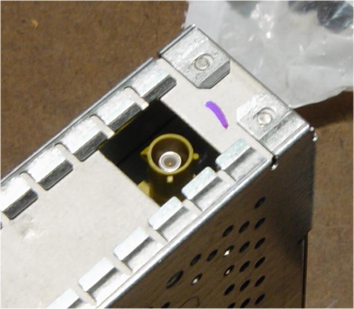

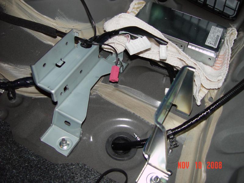

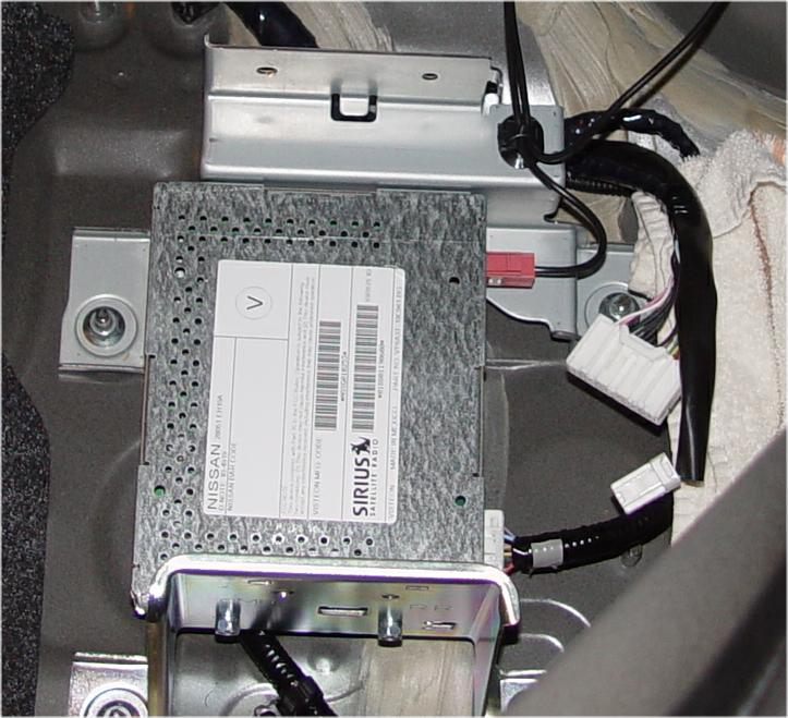

Just installed mine - here is another suggestion on antenna connection
I received mine today from Grubbs. To answer my earlier questions about new or refurb, I called Grubbs and they said it was new. The box was a sealed Nissan kit as OP described with everything needed to do an install in several different model cars.
I attached 4 pictures to help.
1) All removed. The box on top is the voice integration module.
2) With Nubs. This is the back of the Sirius unit. Look closely at the two nubs. This is what prevents the XM antenna attachment from slipping on.
3) With Nubs Cut Off. I took a razor knife and cut off the nubs. Now the XM antenna attachment will slid on and the locking clip will still work and keep it from coming loose.
4) Installed. Sirius unit installed and antenna connected.
Activated, set the channels. Works perfect and fully integrated.
