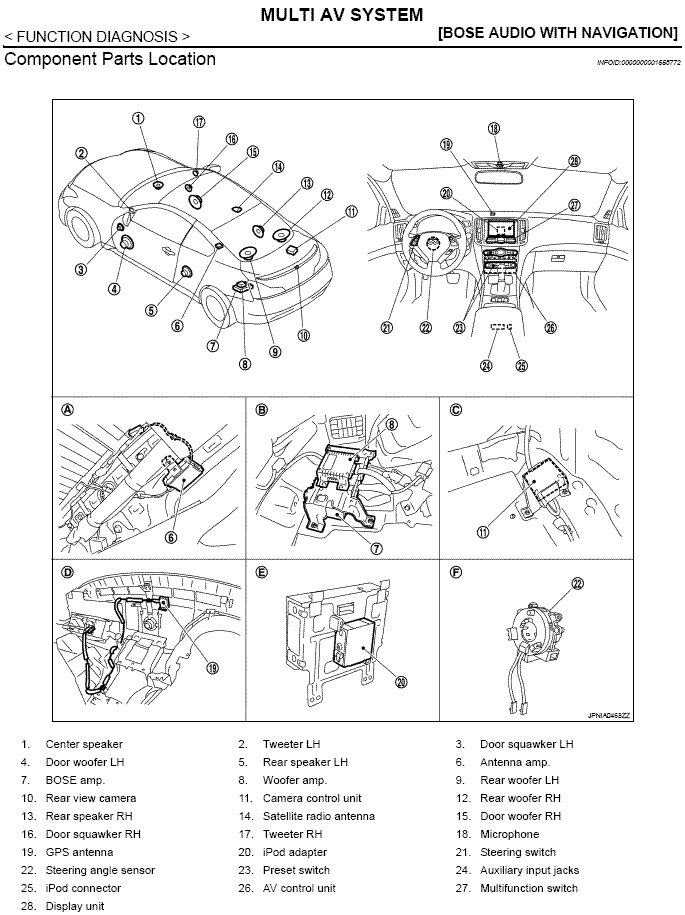

Silly. Someone wants to sell you ceramic tint. The navi antenna is in the dash. As long as you don't tint your front windshield you will be fine. Anything on the rear window is stereo antennas. The car has multiple ones in the glass.
Anyway, see (19) in this image.

I had a GS300 back in the day that had the GPS antenna in the rear panel, and metallic tint interfered with it...
I think most cars these days have them in the front dash/front windshield... I know my SC430 had a thin strip running down the middle of the windshield, and now the G37 in the dashboard.

Pg 5-5 or our fantastic owners' manual
Do not place metalized film or any metal
parts (antenna, etc.) on the windows. This
may cause poor reception of the signals from
the tire pressure sensors, and the TPMS will
not function properly.
