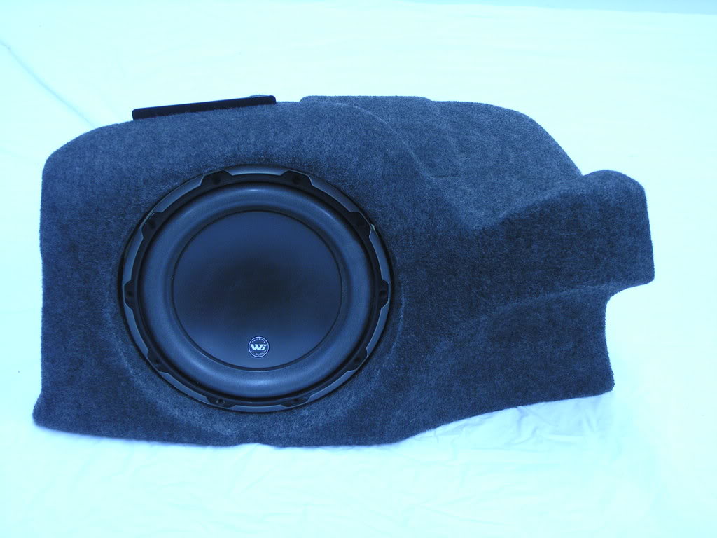

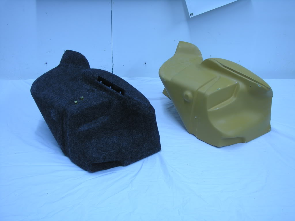

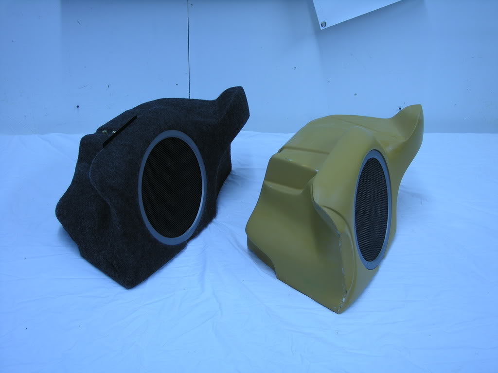

Originally Posted by 4080
Here is the first completed enclosure pulled from the moulde. The enclosure has been wrapped in custom dyed carpet that matches the G37's trunk perfect. One of the pics proves that a JL 10W6V2 will fit perfect in the enclosure. We should have in car pictures very soon. We are still on schedule for mid March. We hope to start laying up boxes this week actually. I will keep everyone updated on when they will ship.
Thanks, 4080
Can we get some larger pictures? Those are really hard to see any detail.
Thanks

Originally Posted by dillyyo
Actually, .85 is volume WITHOUT displacement. So it could easily end up with an internal volume of .5 ft cubed. Roll off on many subs with an enclosure that small, is way to high. Might be able o handle a lot of power, but sub frequency extension will surely be sacrificed. When I'm HP it at about 45 hz or so, that really does a system no good!
This is what is concerning me. Like another poster mentioned, I'm looking for the best "quality" of sound, not necessarily volume (which will come anyway).
My fear is that the size of the enclosure might mean that the bottom end is going to drop off too early.
Is there any sub that will perform "perfectly" in this enclosure? 4080, was the enclosure designed to fit in the space optimally as the primary goal, or did you target an optimal internal volume for a particular 10" sub?
Put another way, which is the best sub that will fit in this enclosure without causing the sub to perform less than optimally (if any exist).
Sorry for the tough questions, I fear the answer might not be what I want to hear ;D
Old Mar 11, 2008 | 07:02 PM
  #150
SantiagoDraco's Avatar
SantiagoDraco
Joined: Jan 2008
Posts: 103
From: ATX
Let me also add that from what I can see the enclosure has the speaker fairly far indented into the space. Could the speaker mounting ring be brought out, even raised somewhat, to help free up some internal space?
Take a look at how the Polk sub is mounted on the enclosure in this car http://www.polkaudio.com/caraudio/in...olk.php?id=29# to see what I mean.
