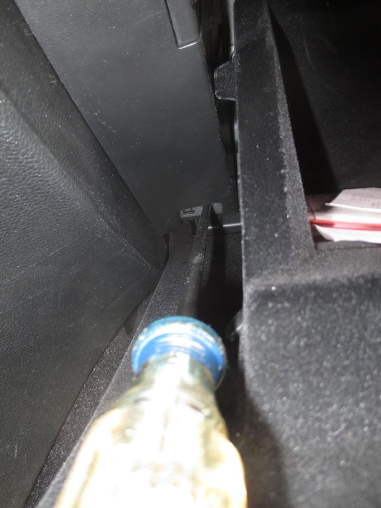

It has been a year since I last changed mine.
Nice 75* day in New Jersey today
Having a #2 phillips with a long shank helps

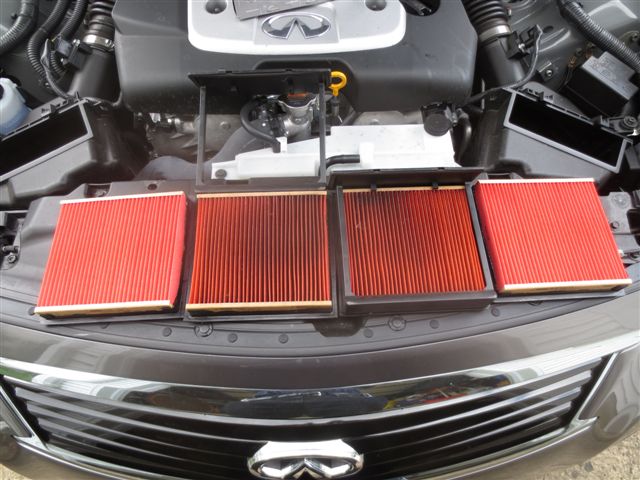

Originally Posted by G10
Hi All.
Can someone please help me understand what the air filter got to do with the technology package, meaning whats the difference.
This thread is about changing the cabin filter.
Air filters are a different filter
Telcoman
