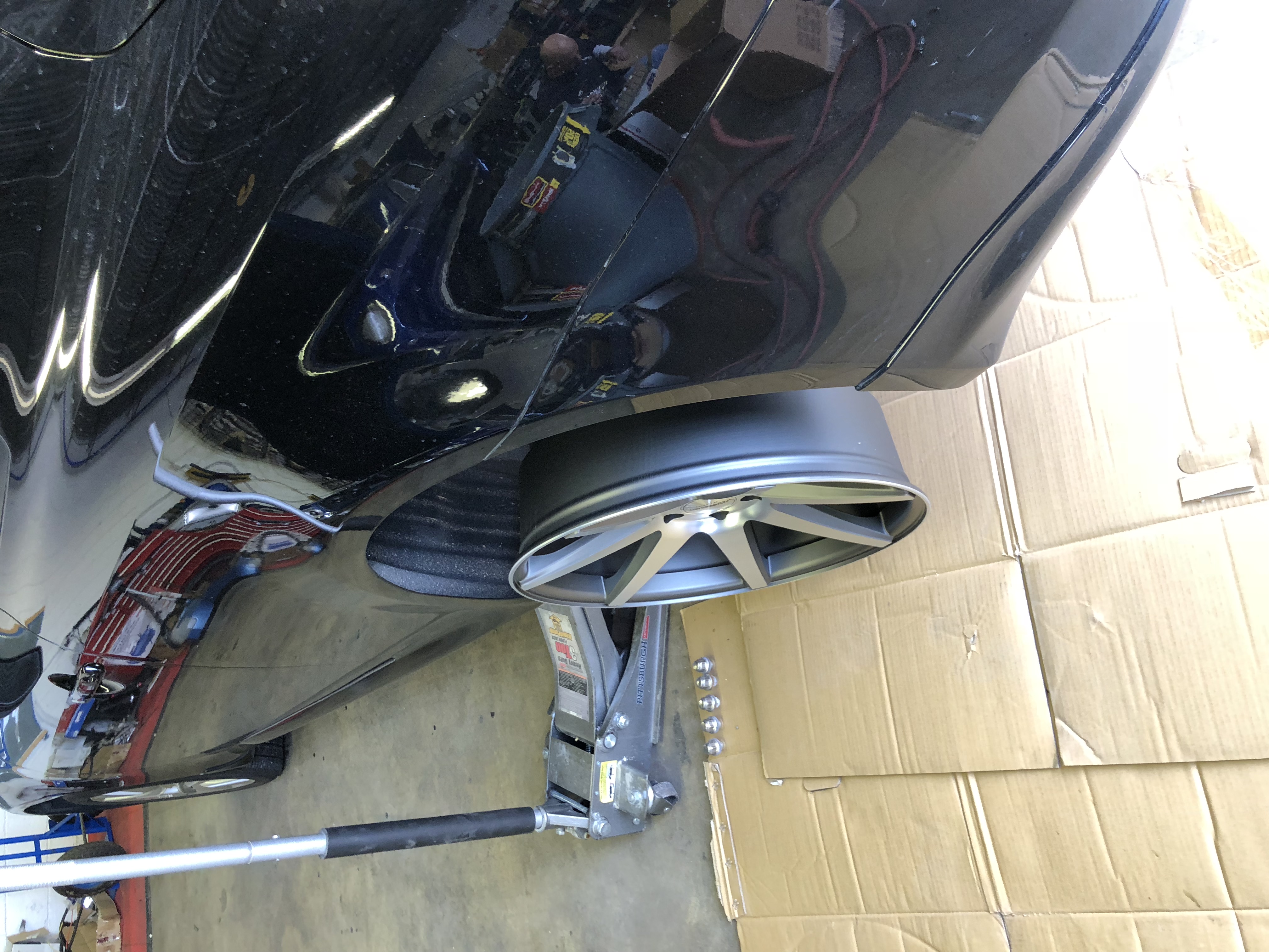

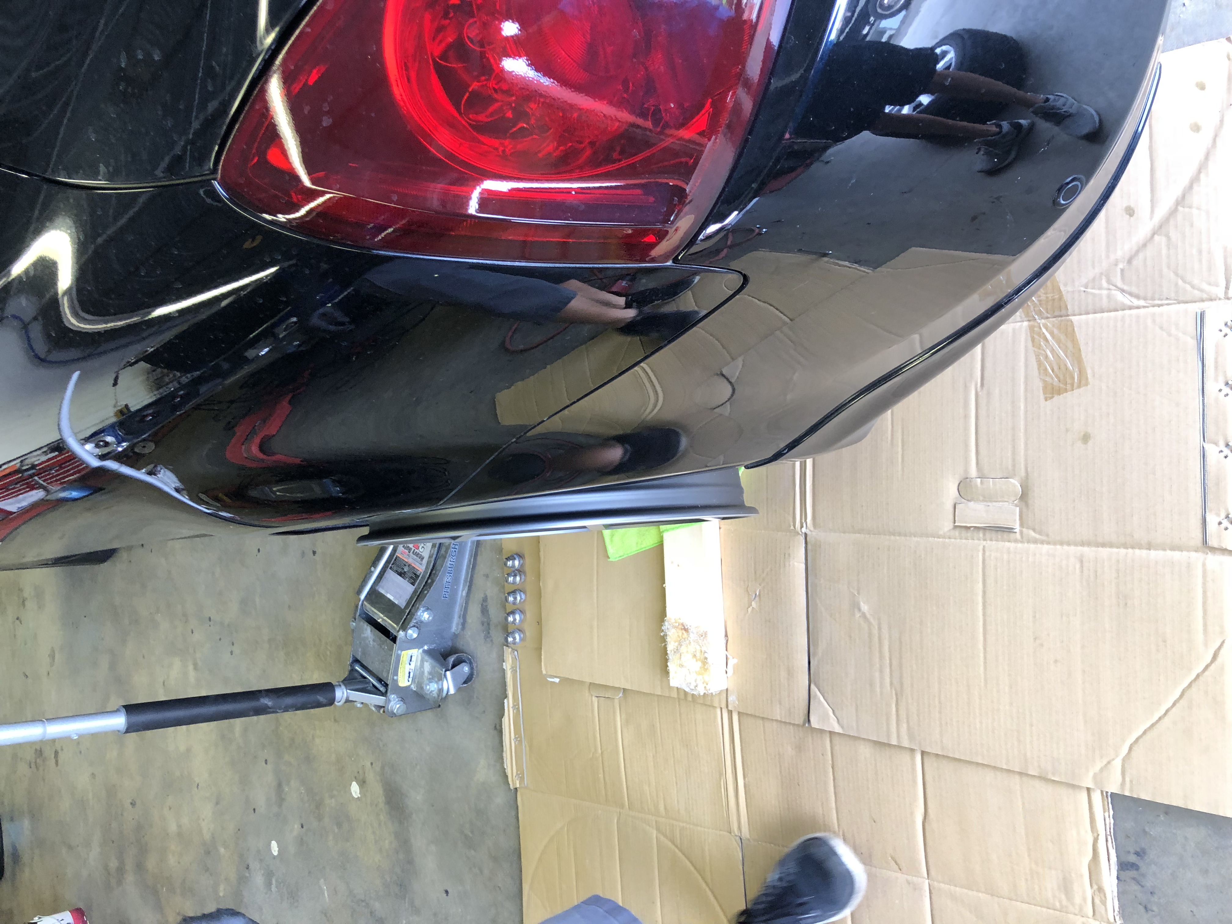

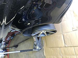

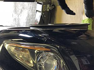

I recently bought a set of Vossen CV7 rims for my g37 coupe. I am planning to stay at the stock ride height for my car because I live in an area with terrible roads and highways everywhere I go; there is no point in lowering the car when I'd just scrape or bust my bumper everyday. What tires can I run without rubbing the inside of my fenders in the front and in the rears? Would there be issues if I hit bumps in the road because of the the rims poking out (as in the rim hitting the quarter panels and fenders)?
The wheel specs are:
fronts: 20x9 +20 offset
rears: 20x10.5 +25 offset
Attached Thumbnails Need help with tires for my rims-img_0412.jpg   Need help with tires for my rims-img_0413.jpg   Need help with tires for my rims-img_0405.jpg   Need help with tires for my rims-img_0407.jpg   Need help with tires for my rims-img_0404.jpg

I don't know why these photos ended up sideways. Sorries in advance!

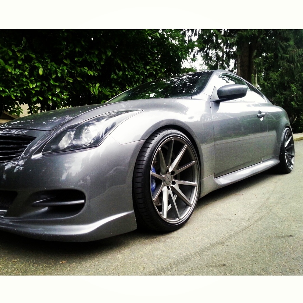

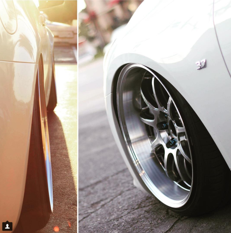

Here's a 20x10.5 +25 running 275s, but this is a lowered G, so the slight camber increase will result in more fender clearance, a 265 should get you a similar fit at stock height. This G is running 10.5 +25 & 275s front & rear.
