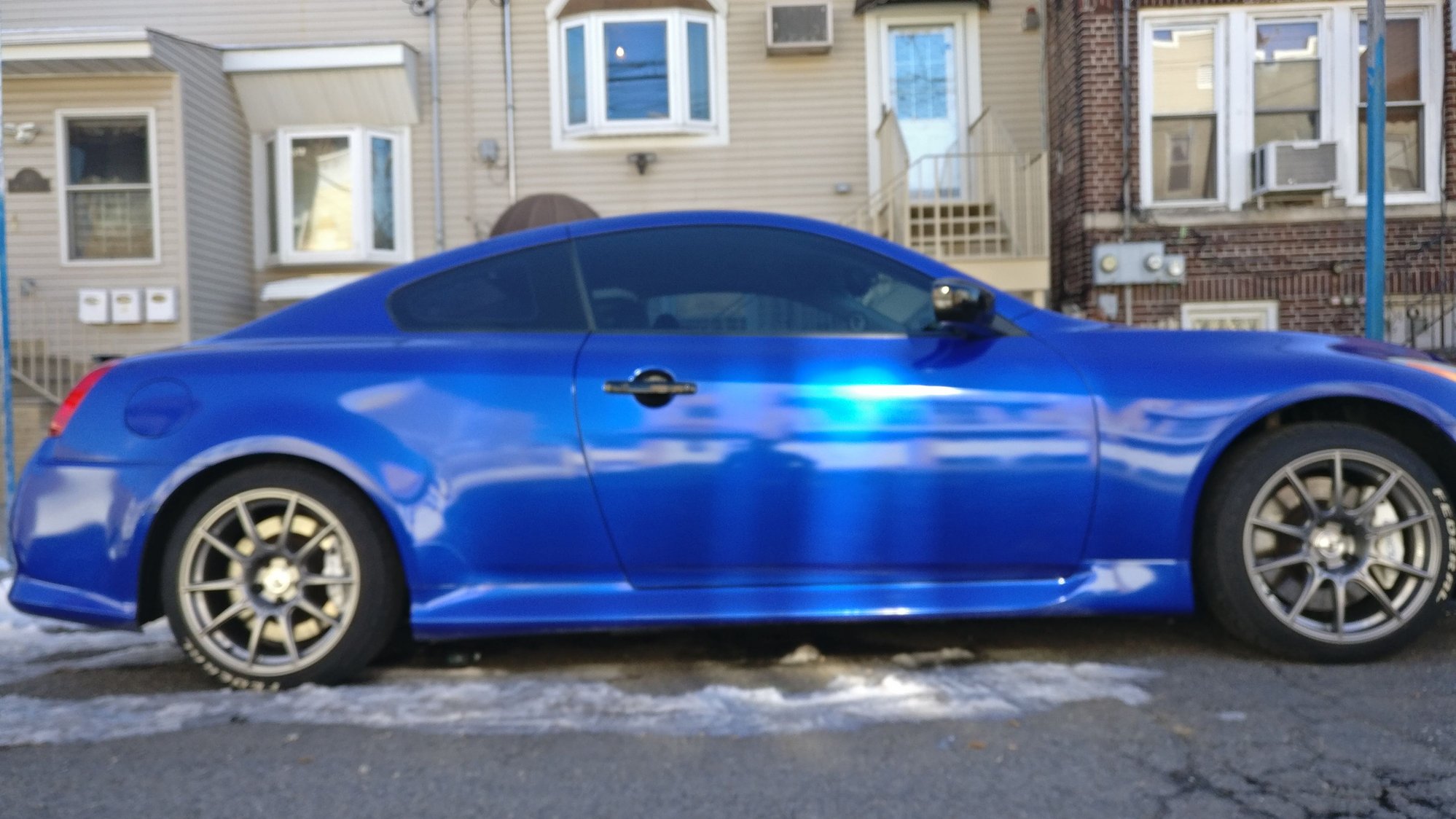

Old Mar 13, 2018 | 09:06 AM
kickintheglass's Avatar
kickintheglass
Joined: Oct 2015
Posts: 841
Likes: 113
Bought the GTX01's last month. The previous owner had 235/40-18 Federal's and there was, as to be expected, enough wheel gap in the front to fit my head. The rear wasn't too bad, and to be honest the tires were stickier than I expected. I planned to roast them in an empty lot but they held traction even in freezing weather.
Nevertheless, this wasn't the setup that I planned on running. I've had my eyes on the Indy 500's for the past year now so it was time to pull the trigger.
*Note that the pics have been flipped to provide a better comparison.
The much thicker sidewall closed up the gap - there's still some space in the front but Jersey City has some nasty bumps and potholes, so the extra travel is needed. After all, I switched to 18's for the comfort (and cheaper tires!). I've never had such wide and sticky tires before, only 275's in the rear from my last summer setup, so this is quite an experience. Any testing on these tires can be thrown in the trash because it's still 30-40 degree weather outside. However, I can say that the soft compound picks up EVERY piece of debris on the road. Bumps are marginally easier to handle, and I feel more reassured that the sidewall gives my wheels more protection. The car still feels skittish at highway speeds but that's most likely because of low temps and my alignment.
Old Mar 13, 2018 | 10:22 PM
Wheels look awesome on your G, so the New Firestones are 275/40s right? Looking like a fun setup!
Old Mar 15, 2018 | 12:31 PM
kickintheglass
Joined: Oct 2015
Posts: 841
Likes: 113
Yup they're the 275/40-18's that you recommended. I'm hoping that the weather gets warmer so I can learn what they can do at an HPDE event this month!
