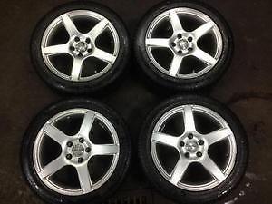

They're listed as 17" x 114.3mm rims. I'm going to contact the seller and try to gather some more information. This is what they look like;

Can we assume the list makes no mention of Akebono fitment?
Old Sep 7, 2017 | 02:15 PM
Likes: 4,949
Yes, I would make that assumption
Those 17" wheels will work ok, if you had the big sport Akebono brakes it would be a no-go, but you'll be ok w/ the base X brakes. I also assume these are 7.5" width, if they are any narrower I would probably pass as a 225/55/17 is a good winter size for your G, and a narrower wheel should also run a narrower tire.

Well it turns out that they are 7" wide. My winter tires are 7.5". The seller assured me that the fit would be fine... What do you think?
Old Sep 7, 2017 | 04:48 PM
Likes: 4,949
That's pretty narrow but just be sure they clear the calipers, they should but a 7" wheel is narrower than anything Inifniti offered on their G lineup. If it's a local sale just do a test fit. You CAN run 225s on them just a bit of a pinch mount, but I doubt you're going to be running hot laps on winter tires
