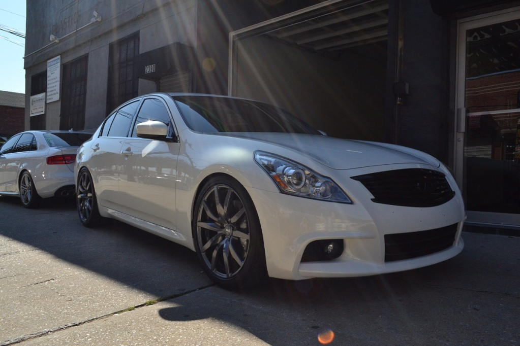

Those GT350 replicas are flow formed too. More and more I am leaning towards those... they look kind of like these GT-R wheels, but they're not 20s:
If they made those or even the original GT-R wheels in 19" I would be all over them. I just want to keep some semblance of ride quality with a baby on the way.

Yea, they only have 10 or 11" width which is a bummer. With the 40mm offset I will poke out another 9mm out back, which is OK, but another 17mm up front, which could be problematic. This is factoring in the 20mm spacers I am running as well.
But there are people running 10.5" square on sedans w/o issue:
https://www.myg37.com/forums/brakes-...ml#post3814746
https://www.myg37.com/forums/brakes-...ml#post3998096
Actually this guy is at my ride height on 19x10 +40s all around, but 255/35s:
If I have to raise the car a hair to fit the 275s that will be fine. The more square sidewall will fill the gap a lot more.
