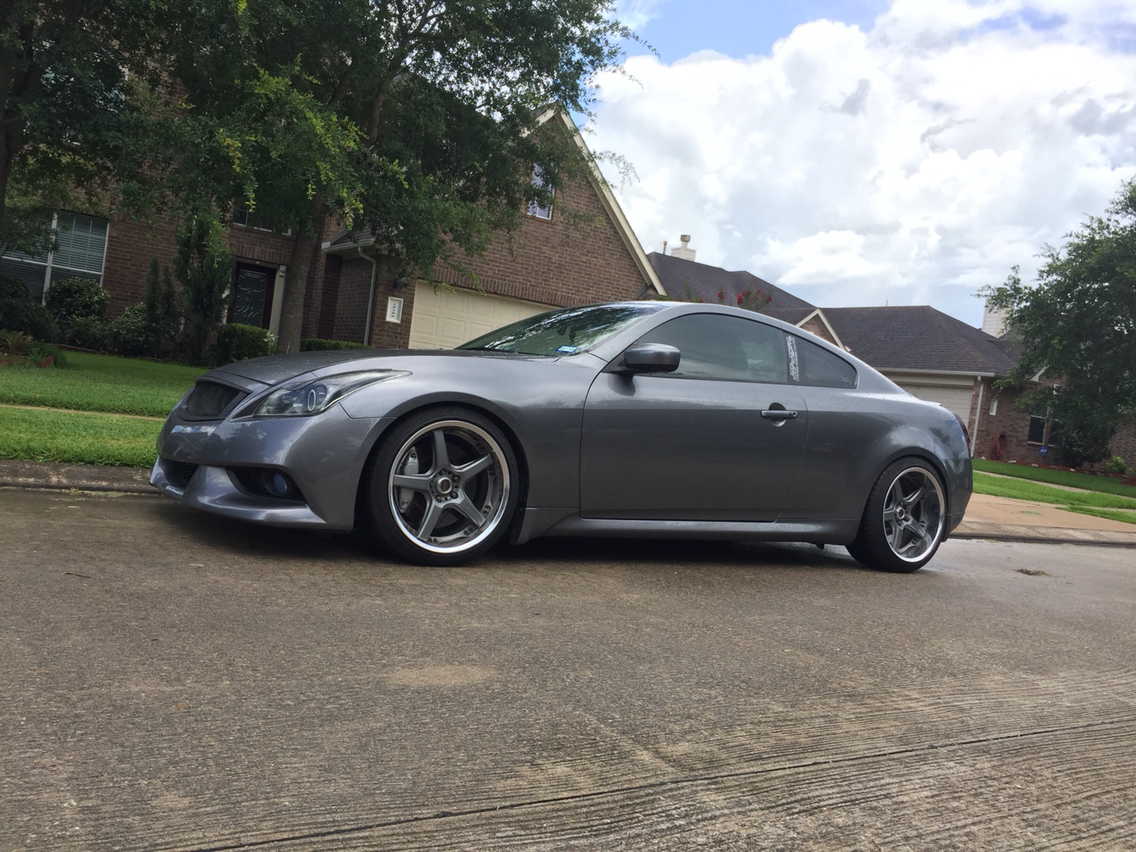

Fitment is perfect! Previous owner had stretched tires. I'm going to run them til the thread wears out. Then I'll get meatier tires on. Volk GTS Wheel fitment question-photo631.jpg
