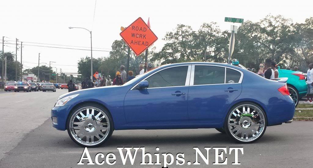

Can't go wrong w 26"

Lol.. the concavity of the wheels is less than the wheel well itself. That's crazy
Ha ha ha!
