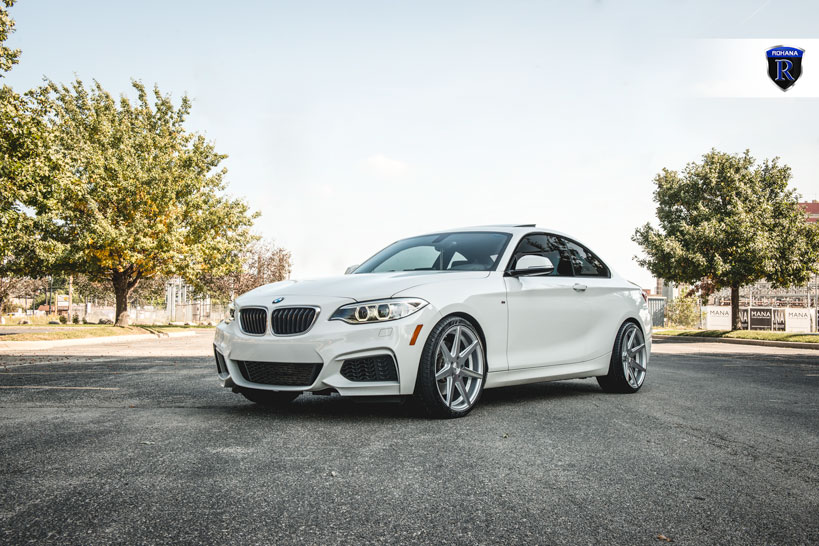

I'd contact Rohana and see if they have pics of the exact wheels/offset that you're wanting. They should be able to help w/ that. Might also contact GetYourWheels (Jason or Josh) for specific info as they sell a lot of those wheels. I looked around and many shots that said 19s were still 20s
Here's some ebay listings but look to be 20s
19" ROHANA RC7 SILVER CONCAVE WHEELS RIMS FITS INFINITI G35 COUPE | eBay

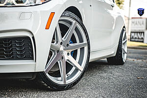

This BMW looks like a 19 set but???

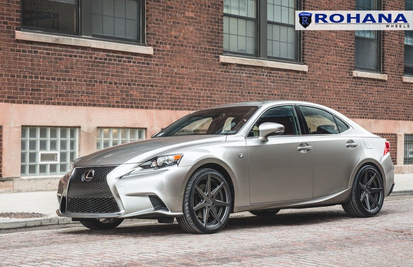

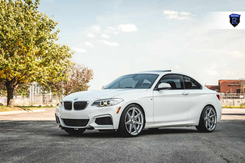

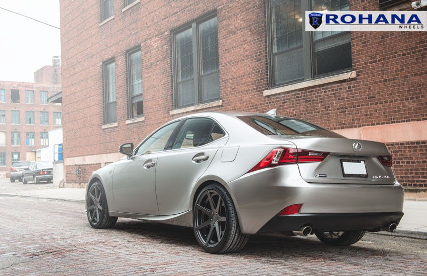

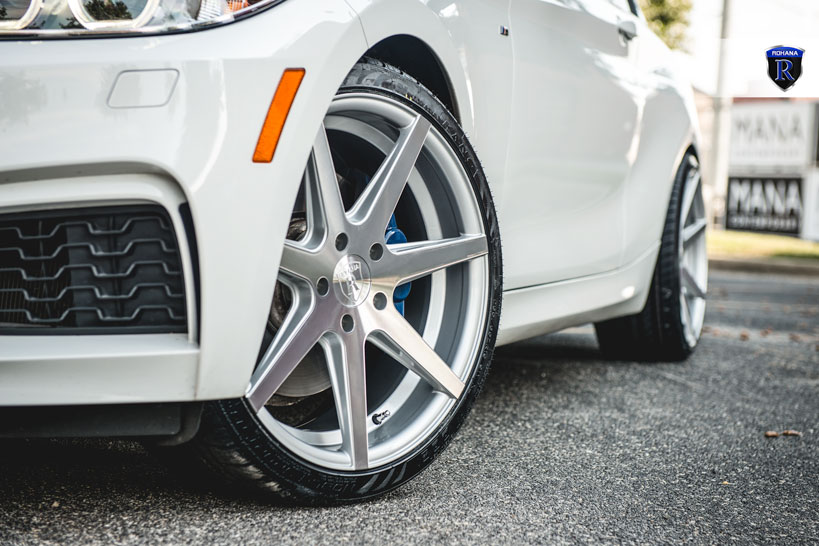

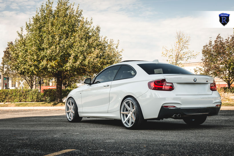

19x8.5 and 19x9.5
You'll have a flat face on the 8.5 and a semi concave on the 9.5

The way the design of the wheel is, as long as you don't have Akebono brake calipers for the front, you'll be fine. The inner barrel where the valve stems seats is inset on these wheels so the inner barrel is more like an 18".

That is exactly what I wanted to see! Sadly (for the wheels), I have Akebono brakes. Guess that is why so many get 20".
