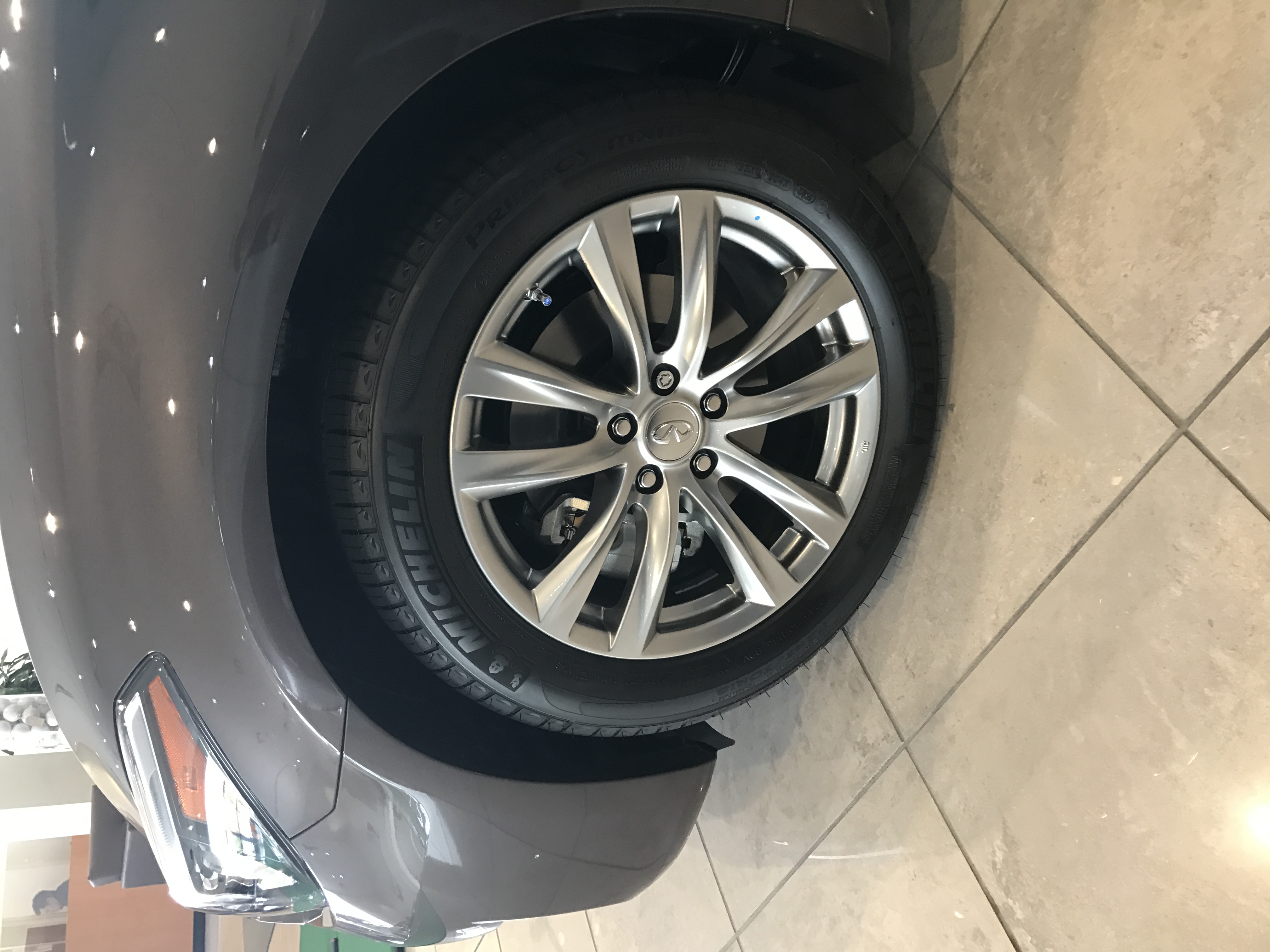

I have a 2013 G37 sedan with stock 225-55-17 tires. My buddy just bought a Q70 & put aftermarket wheels/tires on it. He said I could have his OEM set if they'd fit my car. Can I put these (245-50-18) on my vehicle without issues?

If you're swapping the whole wheel/tire set then yes you can fit

The way I read OP he'd be getting wheels and tires, not just tires. You should be able to run the oem wheels off the Q70 no problem on your car.

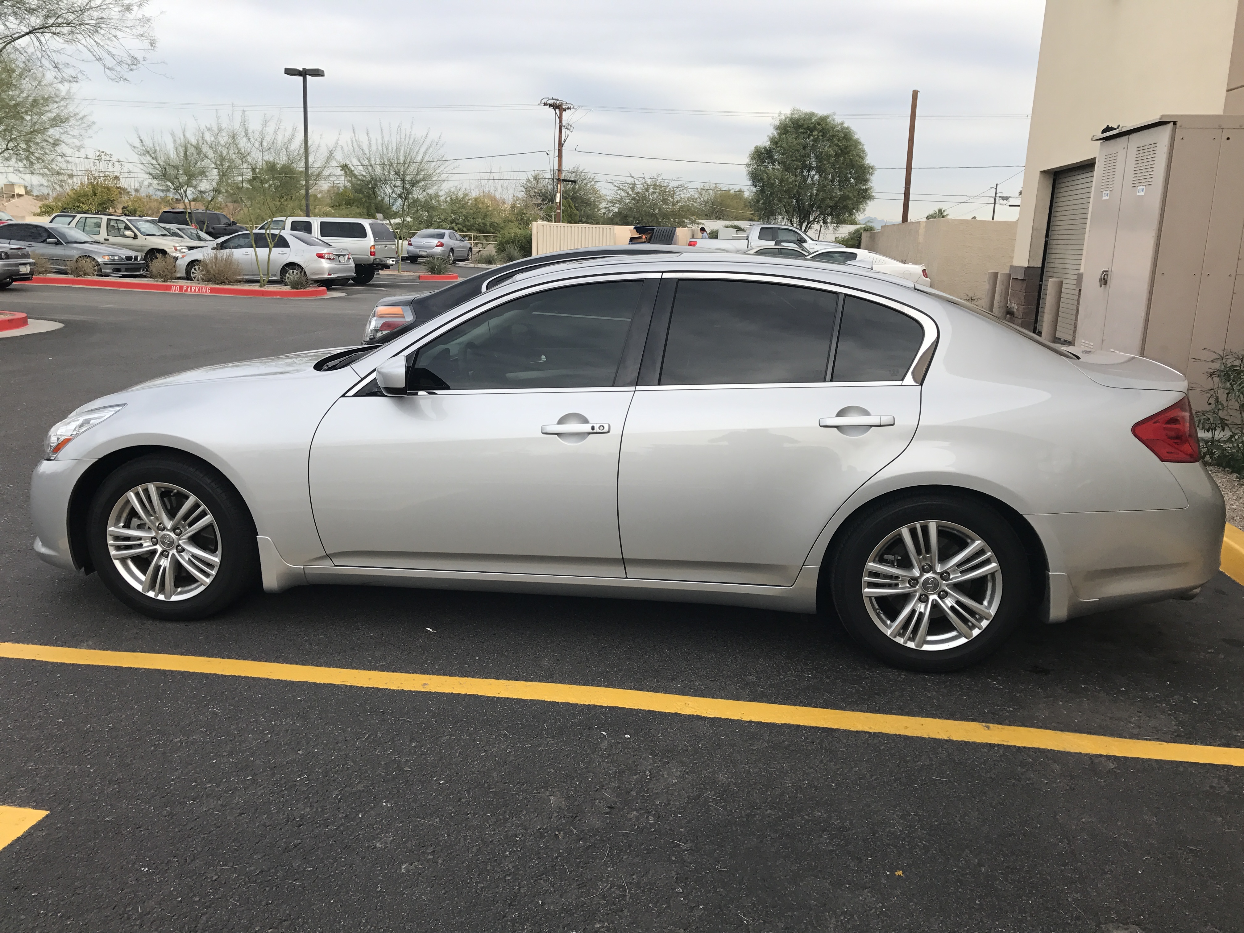

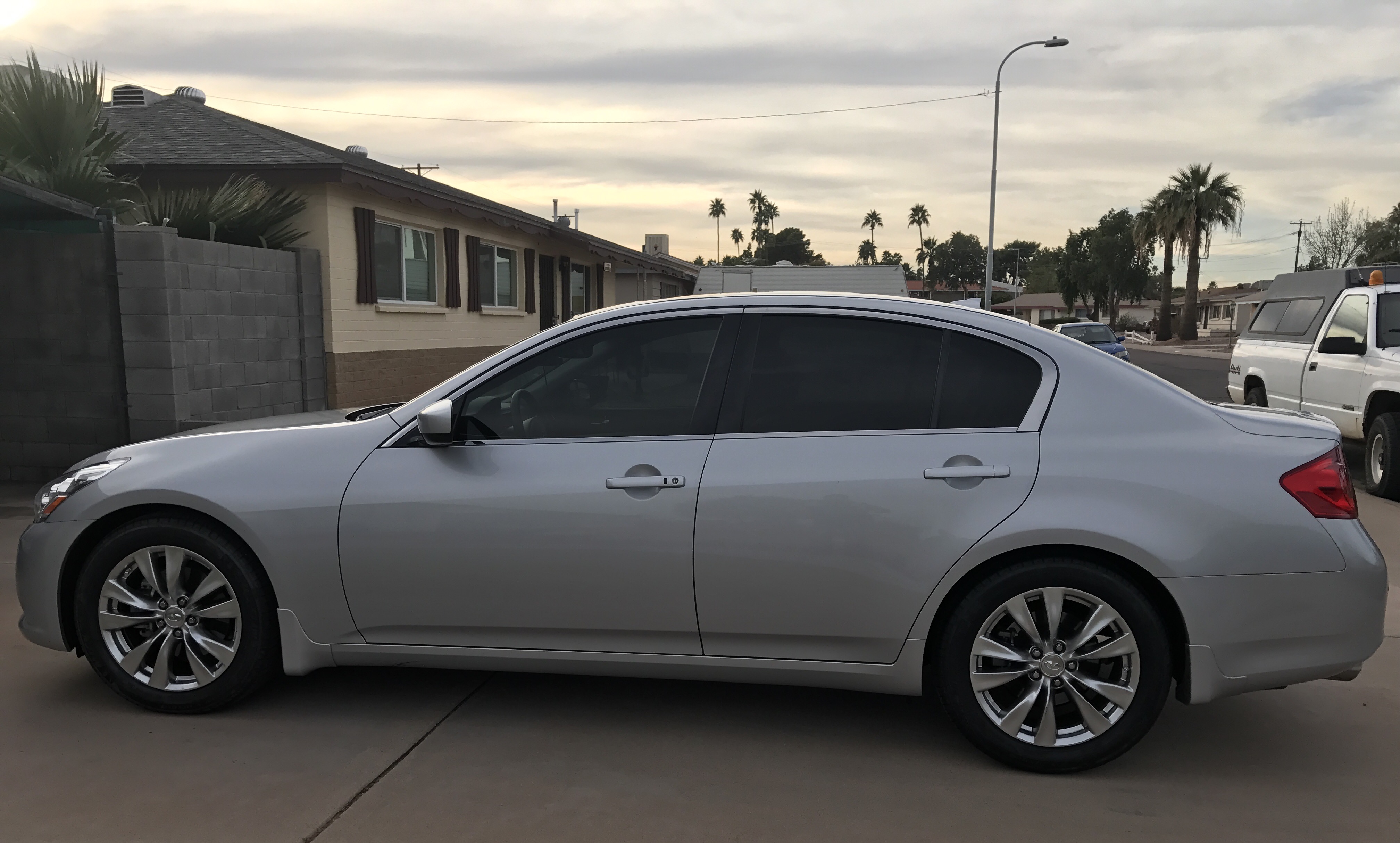

Thanks for the confirmation. I took the wheels & had the tire shop install them for me. I think the car looks a lot better.
Nice upgrade your buddy gave you.
Definitely look better than the stock 17 inchers.
