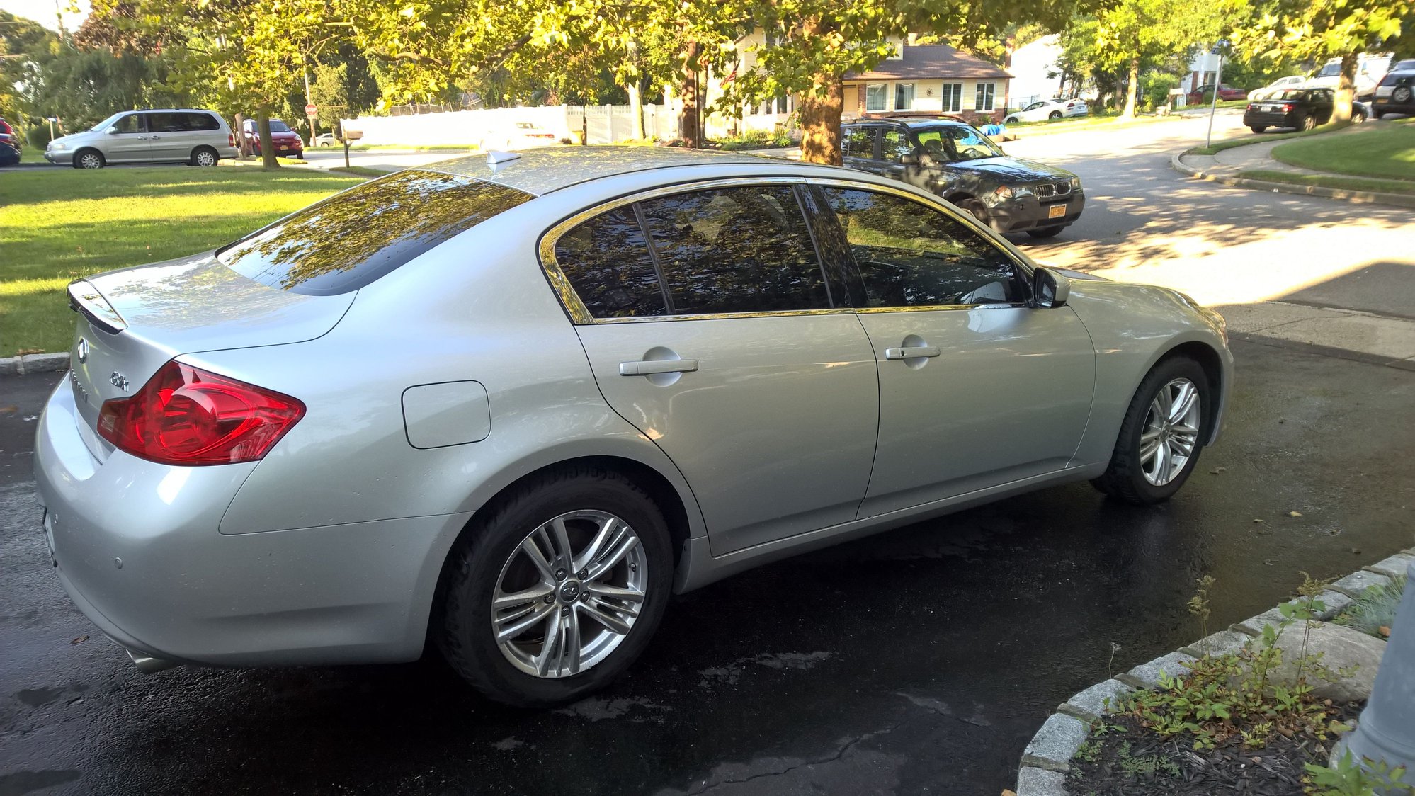

Follow up question: What color do you think will look best on my liquid platinum G? Have mildly dark tints. I love the gunmetal color.
Also have to figure out sizing. Anything special I need like spacers or order a certain offset?

Here's a pic of my RWD sedan (lowered on coilovers) just for a fitment reference. I'm running 18x9.5 +38 on 245/45/18s, as you can see the wheels are very flush to the fenders but the tires have plenty of room to tuck into the fenders (I could run at least 255s easily).

For a similar fit on the Enkeis, here's their spec page, and you have to click "size chart" to download the specs.
RAIJIN | Enkei Wheels
The 18x9.5 +35 will be 3mm further out from mine as will the 19x9.5 +35
For a more conservative fit you could run 18x 8.5 or 19x8.5 in a +35 offset, this will be 9mm in from my setup and you can still run the 245 width tires.
If you don't plan on lowering your G I would go more conservative, if you plan to drop it, then the 9.5 +35 on 245s will be nice & snug.
FWIW TSW makes a similar looking wheel in bronze that would look nice on your silver G~they have them in a 19x9 +32 which would net the same fit as mine
19x9 TSW Nurburgring Matte Bronze (Rotary Forged) Wheels
And a 9.5 +41 which would be 3mm in from mine
19x9.5 TSW Nurburgring Matte Bronze (Rotary Forged) Wheels
an 8.5 +45 which will be similar to stock 18" setup or about 10 mm out from your current w17" wheels
19x8.5 TSW Nurburgring Matte Bronze (Rotary Forged) Wheels
And they've got the same wheels in a 18" for about $50 less, here's a 18x9.5 +40 (2mm in from mine) for example

My car isn't lowered and probably won't be for the foreseeable future and I think 18" is about as big as I want to go. Will definitely have a hard time choosing between those 2 wheels, they both look really good!
Thanks for the advice and links! Bronze would look good ugh so many options haha. Good thing the purchase isn't for a few more months so I still have time to decide on the color.
Just wanted to make sure I ad all the correct wheel measurements and sizes. Thanks again!
