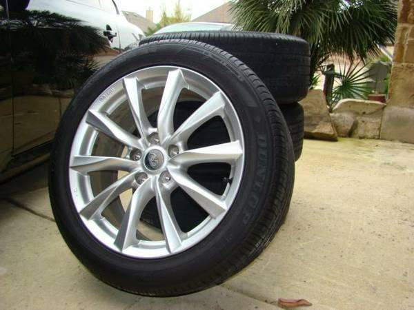

thanks man! Do you know if I need any spacers?
I got the same wheels I have now except 18s. They look exactly the same.

This is the wheel that I bought and have. Do you know about this one specifically? thanks again for your help.
18 inch Q60 wheels
Old Jun 17, 2016 | 12:01 AM
Not 100% sure, if you don't want to try a test fit you can tape these templates to some thin cardboard and test them that way.
https://www.myg37.com/forums/brakes-...templates.html
