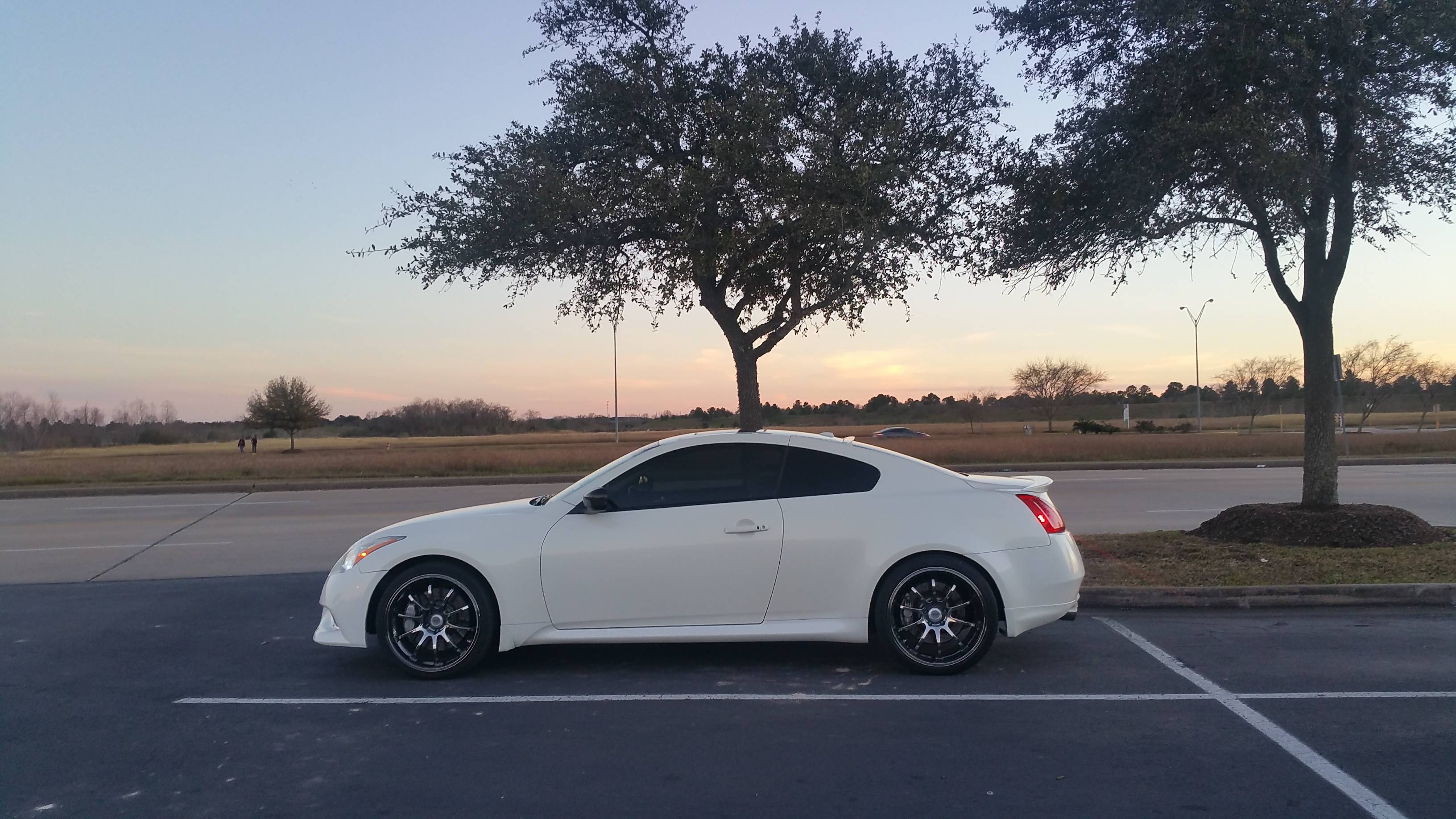

Welcome to the forum. I am local in Houston and might have some wheels up for sale soon, Advan RS-D in bright chrome, 20x9 front and 20x10 rear with flush offsets, either +20 or +25 front and rear if I recall correctly. Send me a PM if you are interested.
